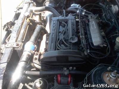

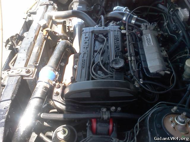

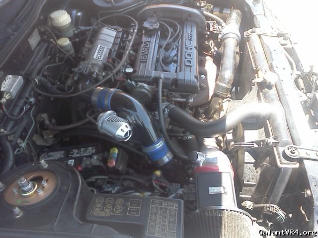

Holy water, if the PO spent some serious cash, which by the parts list and those pics, it has probably been tuned. All that and no tune and no boosting, I don't think so. Willing to bet 5 paypal bucks that it has at least an keydiver or another generic eprom tune at least.

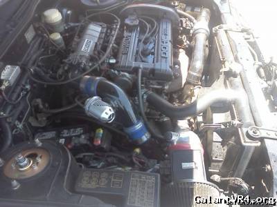

I spy a vented to air hks bov.... that may
at have a lot to do with it running like crap. First step is to get a recirculation adapter for the blow.off valve and reconnect it to the intake tube where there is a plug in it.
