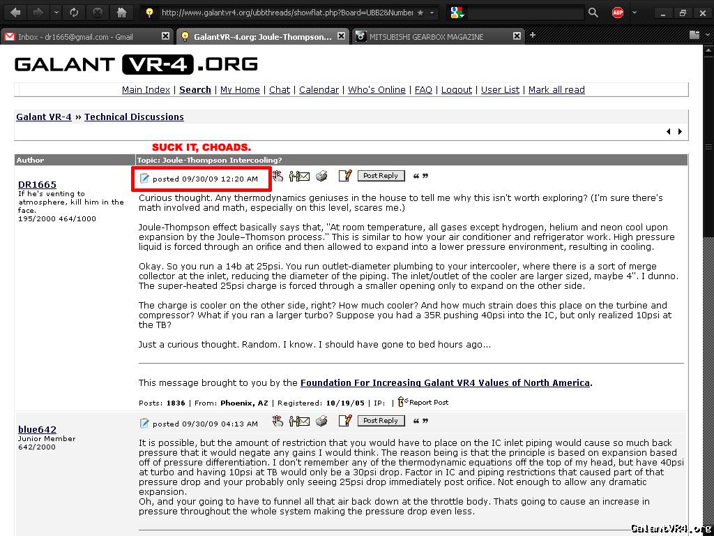

Curious thought. Any thermodynamics geniuses in the house to tell me why this isn't worth exploring? (I'm sure there's math involved and math, especially on this level, scares me.)
Joule-Thompson effect basically says that, "At room temperature, all gases except hydrogen, helium and neon cool upon expansion by the Joule–Thomson process." This is similar to how your air conditioner and refrigerator work. High pressure liquid is forced through an orifice and then allowed to expand into a lower pressure environment, resulting in cooling.
Okay. So you run a 14b at 25psi. You run outlet-diameter plumbing to your intercooler, where there is a sort of merge collector at the inlet, reducing the diameter of the piping. The inlet/outlet of the cooler are larger sized, maybe 4". I dunno. The super-heated 25psi charge is forced through a smaller opening only to expand on the other side.
The charge is cooler on the other side, right? How much cooler? And how much strain does this place on the turbine and compressor? What if you ran a larger turbo? Suppose you had a 35R pushing 40psi into the IC, but only realized 10psi at the TB?
Just a curious thought. Random. I know. I should have gone to bed hours ago...

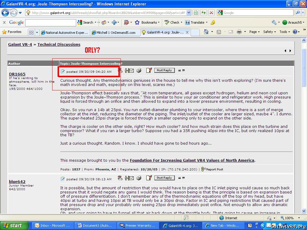

Quoting Rausch:
posted 09/30/09 04:20 AM
Hmm.... /ubbthreads/images/graemlins/rofl.gif
(Although it was actually closer to 0120hrs, since I don't pay too much attention to post time.)
