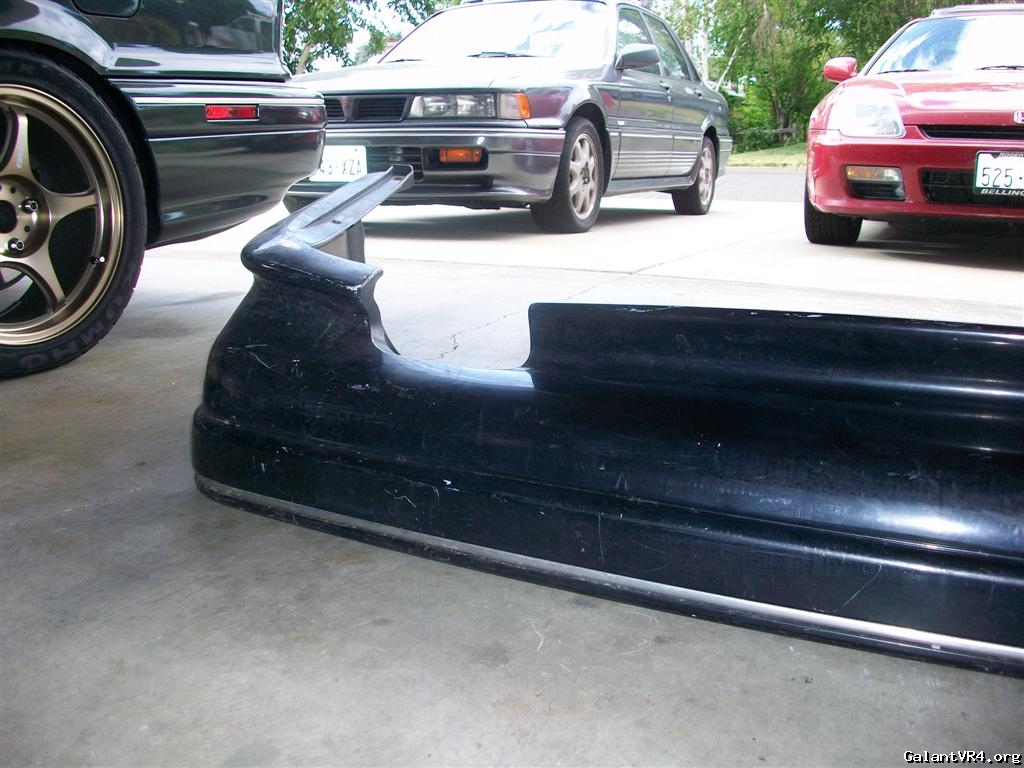

So I ordered another one of these things for 1051. Usually I have good luck with Everspring Sports on Ebay taking only around four days to get the item to me, but DHL fucked up and mislabeled the bumper and it took 3.5 weeks. It didn't help that they don't have an office locally anymore and had to contract out a trucking company once it got to the states, but first it sat in flipping Canada for five days until they realized they made a label mistake after I called asking where the f*** my package was. /ubbthreads/images/graemlins/mad.gif
Anyway, this is the second rear bumper I've purchased from overseas and holy f*** are these things warped when they arrive. The rear bumpers are super flimsy at the bottom without the support from being mounted to the car so after they package them up and they sit for a while, they retain that shape when they finally arrive. Everspring says you just have to mount them to the car to regain their original shape, but I end up having to use a heat gun on it to soften it up first. I'd like to hear from others that have JDM rear bumpers how theirs looked when they got them?

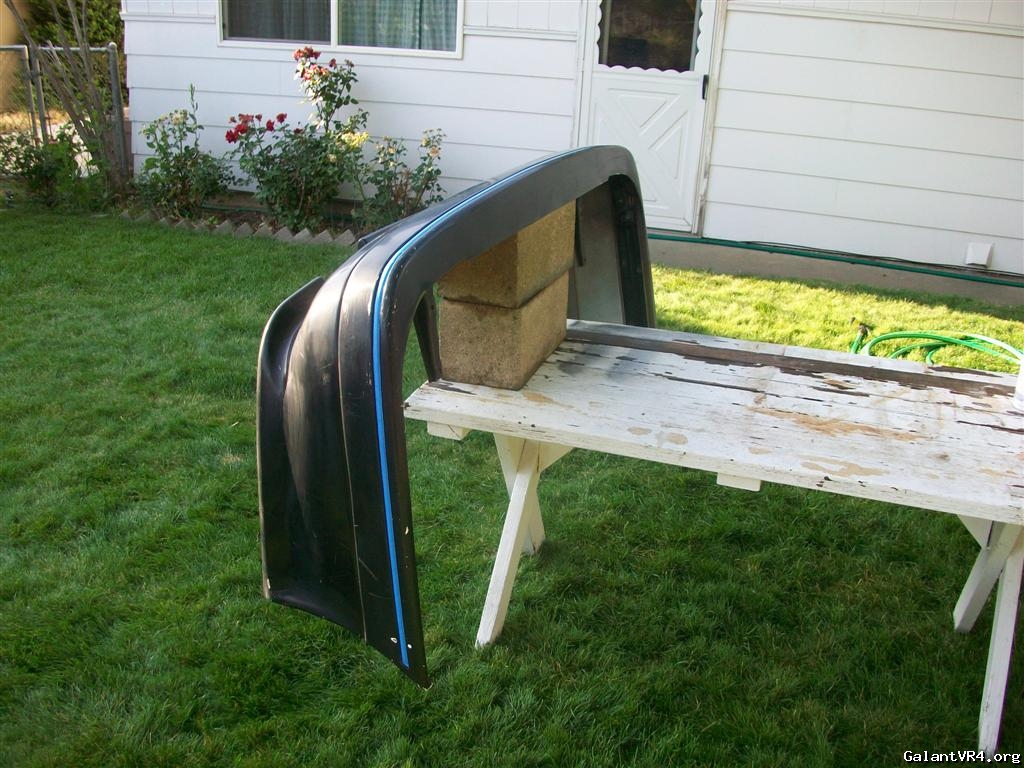

I took some pics to show you guys how easy it can be to paint them yourselves if not too worried about perfection.

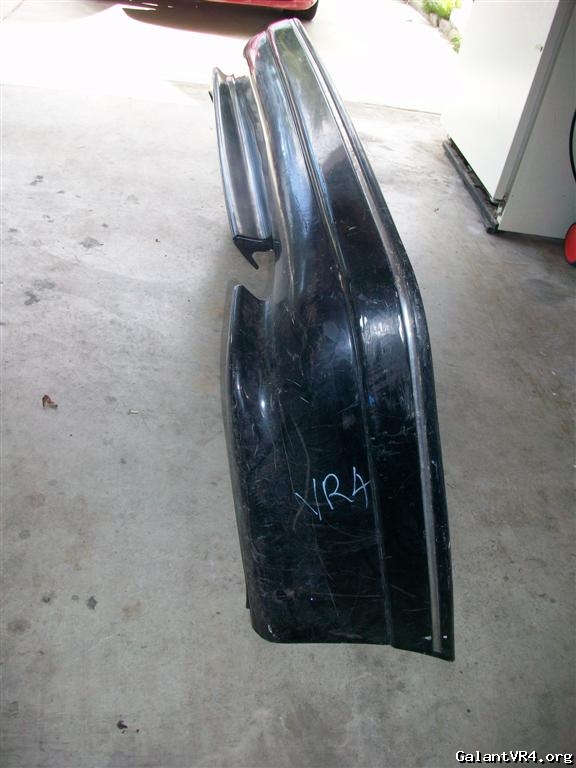

This is what it looks like *after* the heat gun. It was actually warped worse when I unpackaged it. /ubbthreads/images/graemlins/uhh.gif

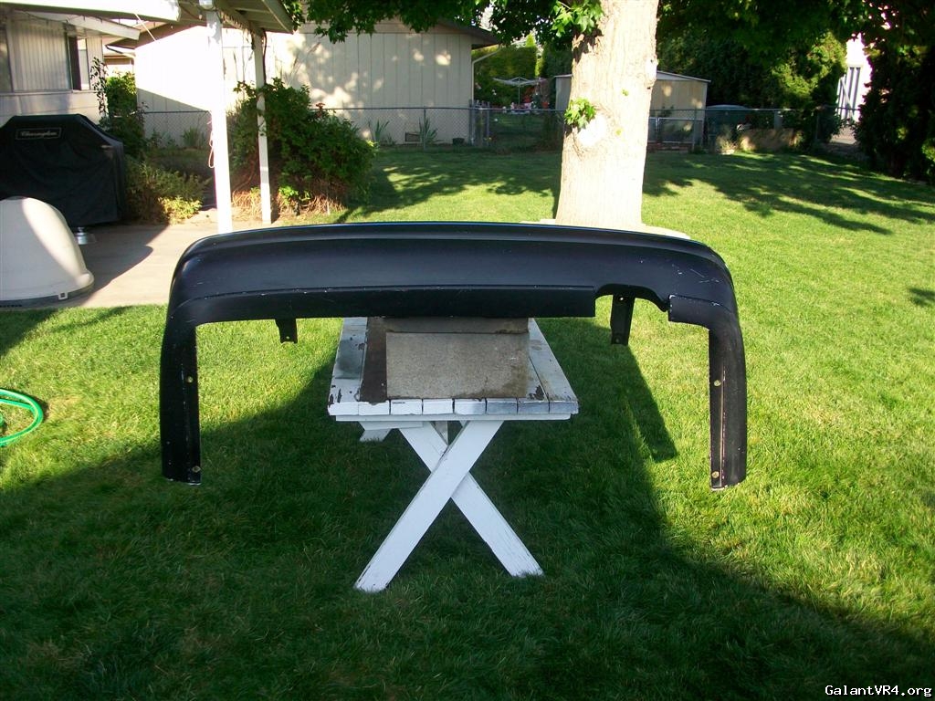

Setup a makeshift stand and go to town with a scotchbrite pad for a bit. I only spent about half hour on this thing. I didn't worry about super deep scratches, I just wanted a good surface for paint to bite into. You could spend more time and use some filler if necessary to smooth out any larger imperfections. I also masked off the chrome strip just in case this one gets used on 503. Whatever bumper goes on 1051 gets a brand new strip...

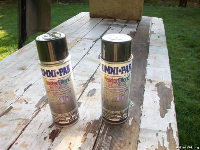

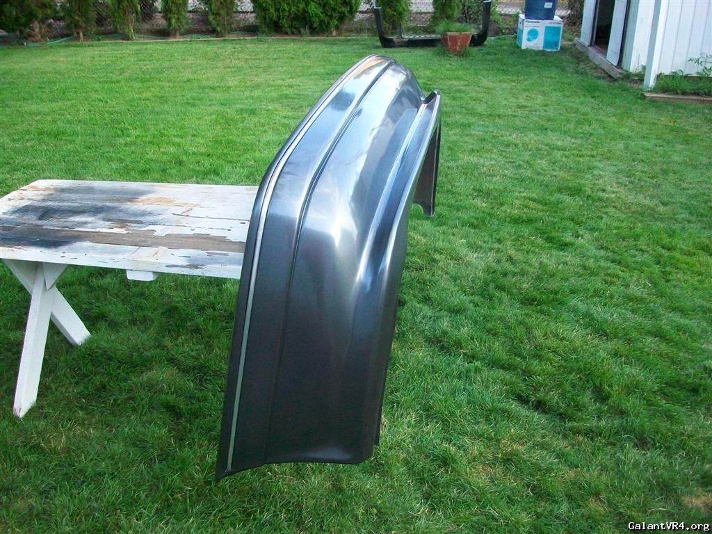

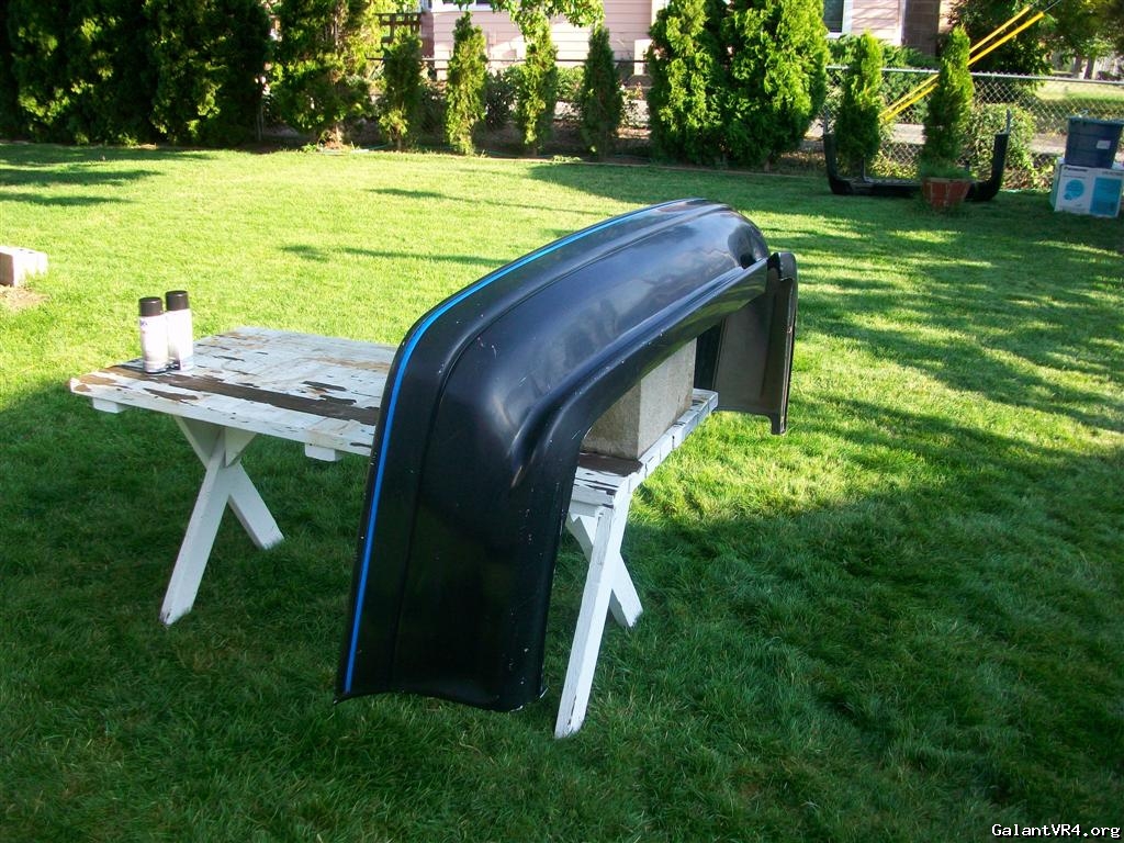

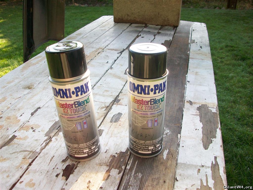

Have the local paint supply place mix up some KG in a couple of spray cans...

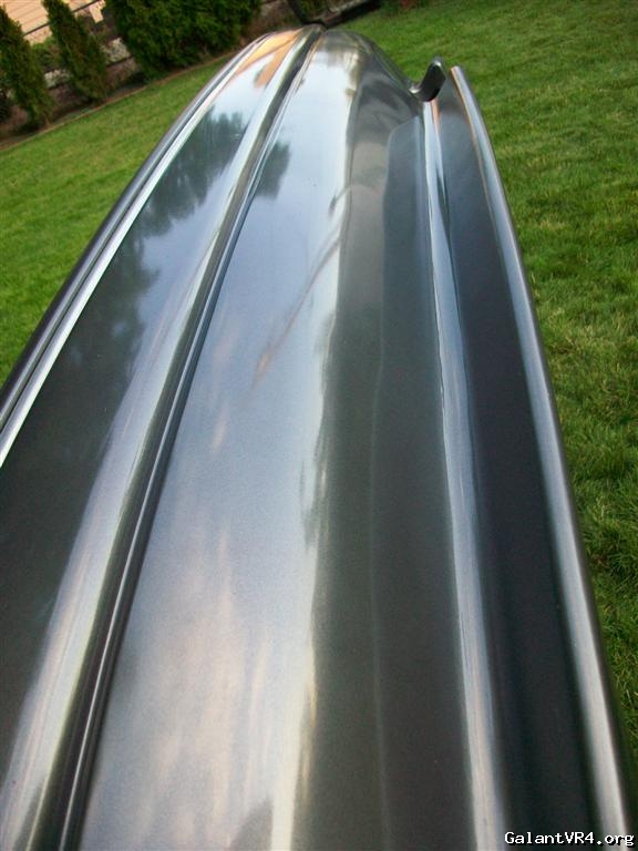

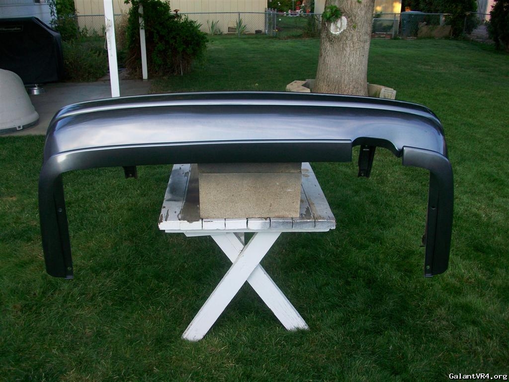

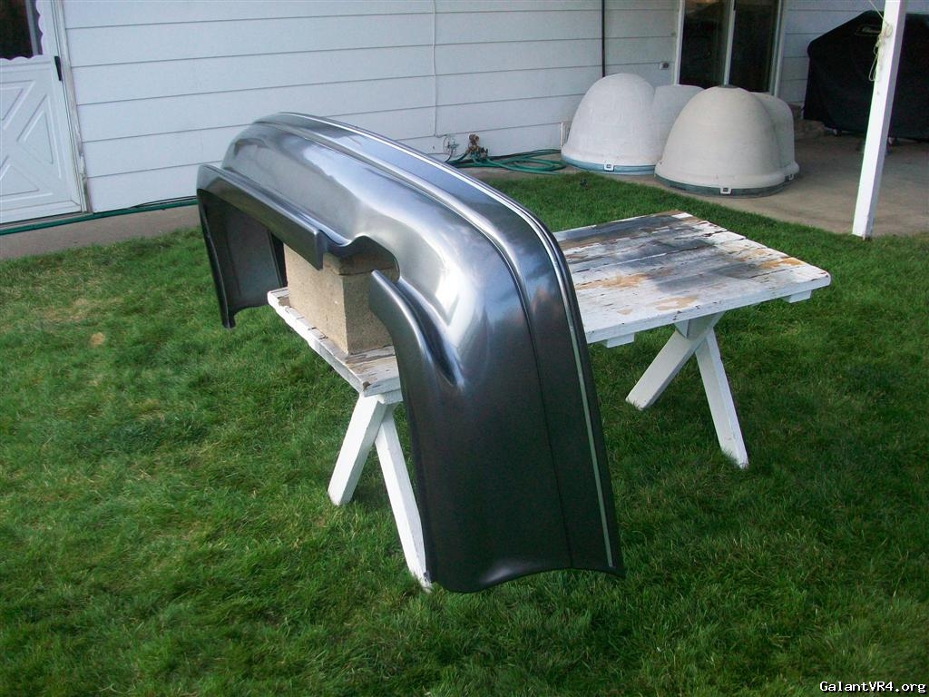

Spray and let dry...

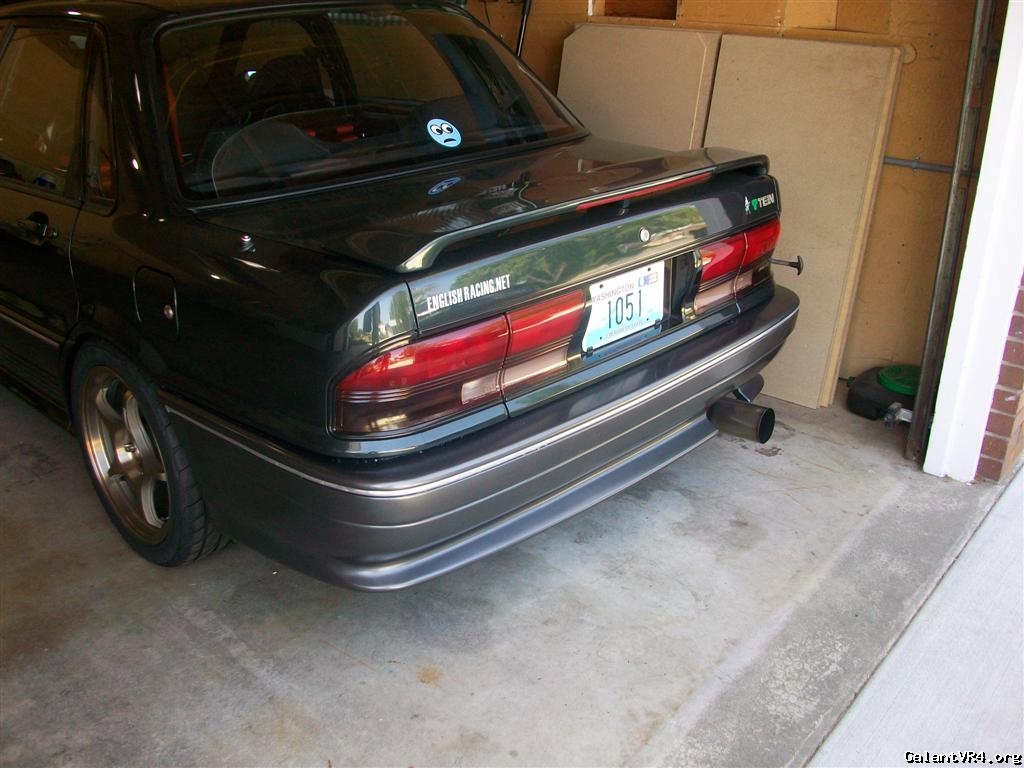

Rattle cans actually turn out okay when put next to the rest of the car that has 17 year old paint. Considering how horrible the bumper looked when I first got it, it looks pretty good now for just a little time and a few dollars spent on custom spray cans.

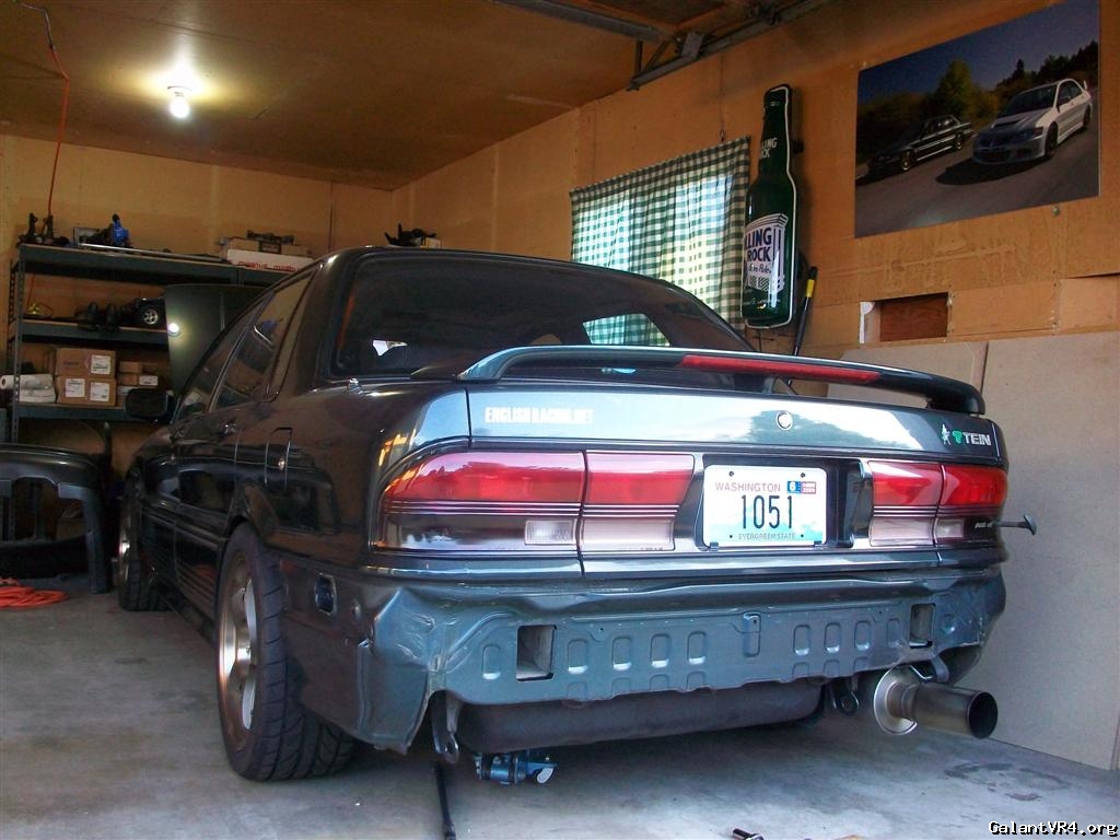

I actually am putting this one on 503 because it has a couple of warps that the other one doesn't have, but check out how far the exhaust sticks out with one of these bumpers mounted. Shows just how much longer the USDM bumper is. /ubbthreads/images/graemlins/eek3.gif
I'll be having Andre weld up a new dual tip muffler to fit this bumper. Unless somebody wants to buy my catback system so I can buy a new dual tip JDM one from CMPE. /ubbthreads/images/graemlins/hs.gif I'm gonna drop it off at the bodyshop on Monday to have sprayed. Should turn out nice. /ubbthreads/images/graemlins/cool.gif

Man you are a rattlecan professional, looks better than a Maaco paint job.

Do they put a flex agent in the paint when they mix it for spray cans?
I did something similiar for the front bumper/snow plow on my gsx. It looked perfect until winter, and then it spider cracked everywhere that it pushed snow. I asked my paint guys what happened, and after they looked at it, they mixed me a new batch with a flex agent. It stayed very nice for ten years.( at least as nice as something that pushes two feet of snow can look. /ubbthreads/images/graemlins/smile.gif )
That was interesting, becuase they said if I didn't remove the factory paint, a flex agent wouldn't be needed. I followed their directions, and used scotch brite, and a paint prep/adhesion promoter product they recomended. After seeing the results of one winter season, they decided a flex agent would be helpfull, and mixed it up no charge.
Probably doesn't matter so much on a rear bumper, just thought I'd throw my experience out there, in case somebody tried your technique on a front bumper. /ubbthreads/images/graemlins/smile.gif

They didn't mix in any flex agent that I know of. I've also heard from my bodyshop guys that it's not needed unless you take it all the way back down to the urethane. At that point, adhesion promoter and flex agent would be needed. I guess how well the paint adheres is all based on the coat that is sprayed directly on the urethane. I did the same for the front bumper on 503 and other than some rock chips from last ski season, the paint still looks good.

^ Thats what I was wondering also....did you get a flex agent in it? Not to big of a deal now, but if you have to respray ever, make sure to get that mixed in.

Damn, Mark, that jdm set-up you put together really looks clean.
I'm going to have to seriously consider using a jdm unit on my car now.
Thanks, ya /ubbthreads/images/graemlins/asshole , now I gotta come up with the coin for that too! /ubbthreads/images/graemlins/tongue.gif
