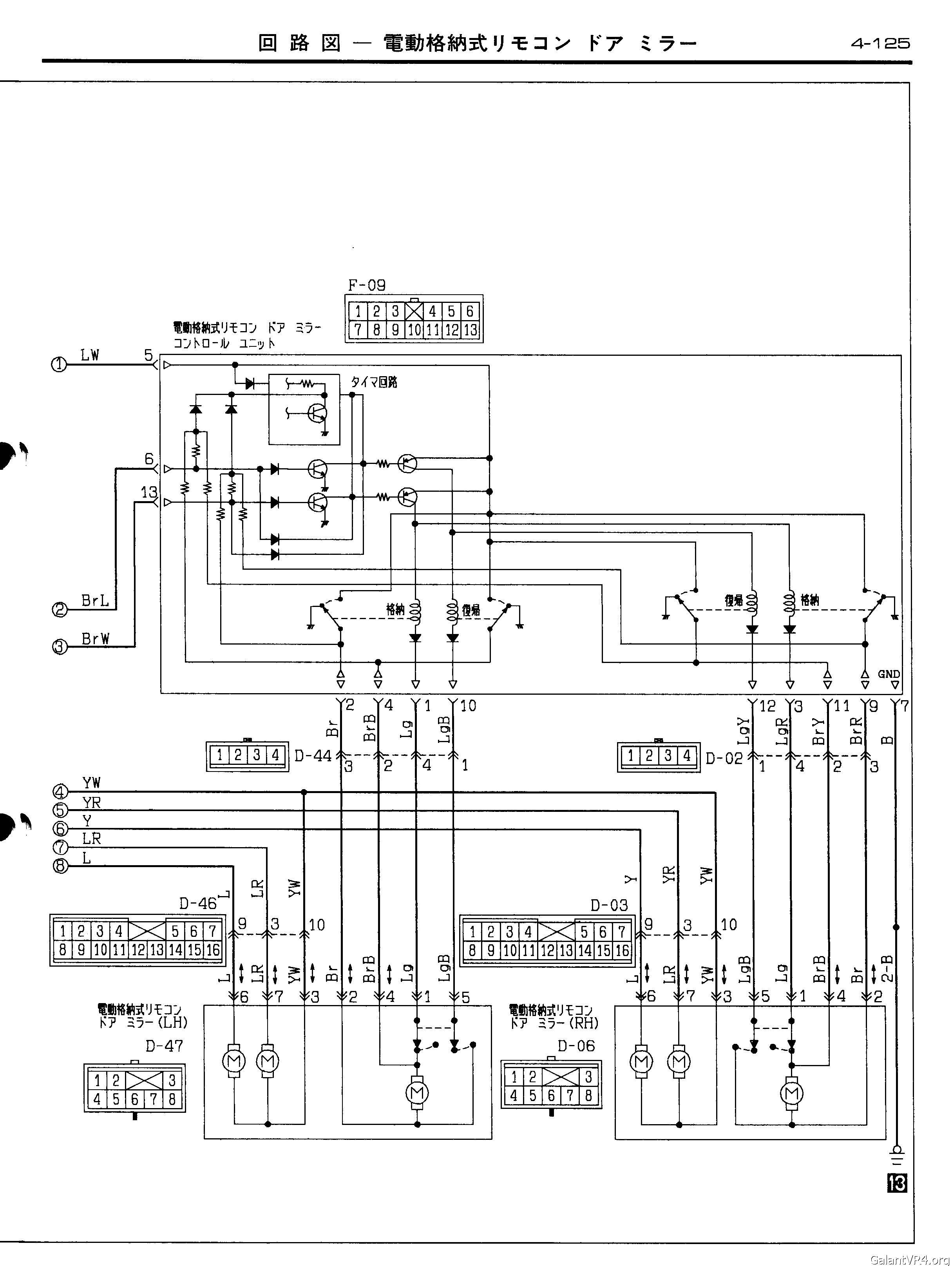

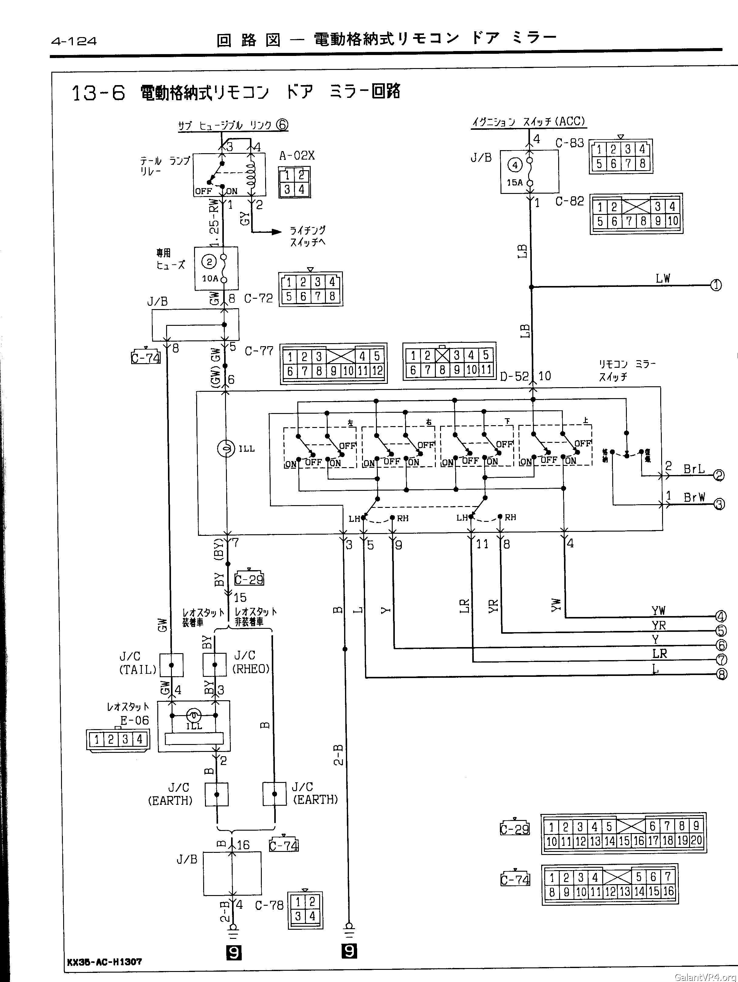

here:

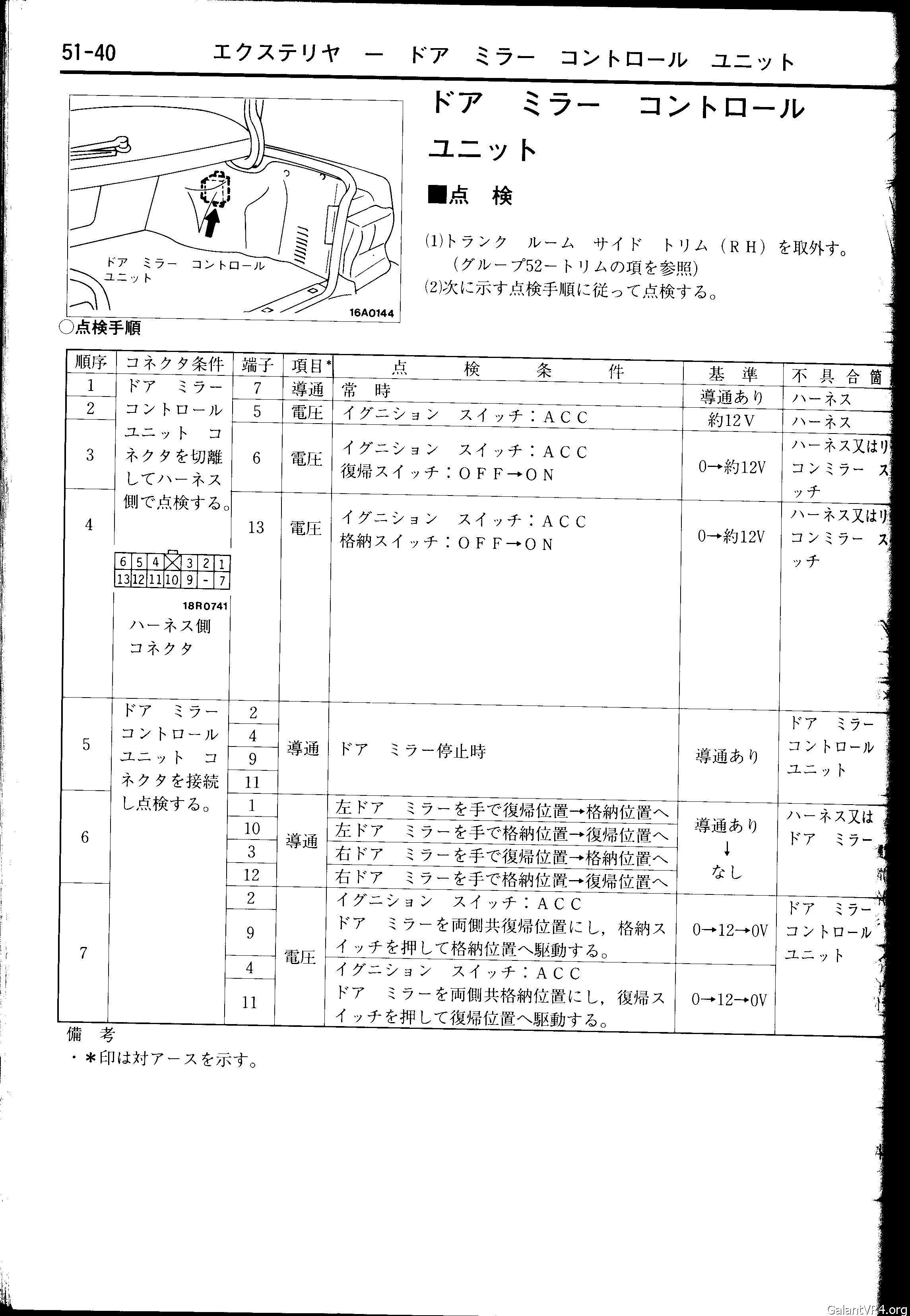

Here's the box:

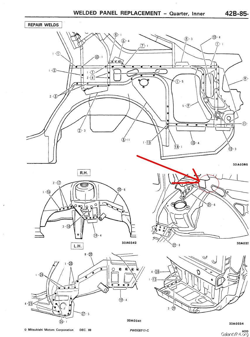

Here's a view from the body manual for the hatchback to show where, it sits between the inner wing and outer wing on saloon and hatch here. Can't find a photo, when i next pull out the boot trim i'll snap a pic.
