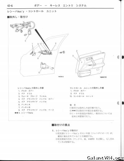

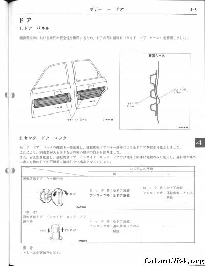

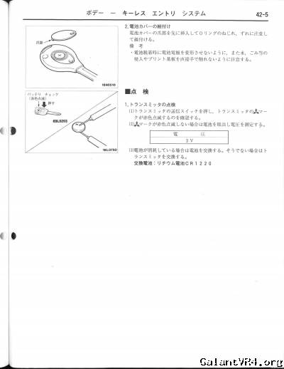

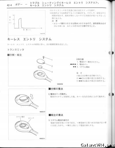

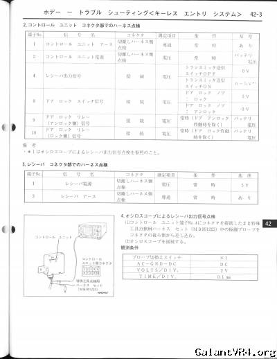

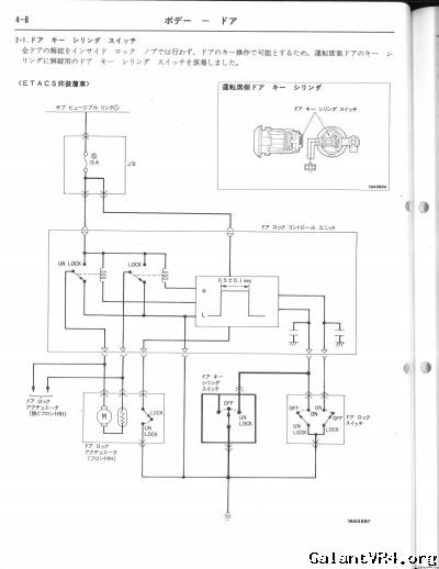

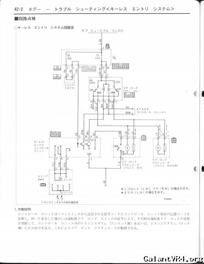

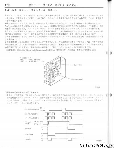

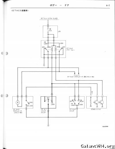

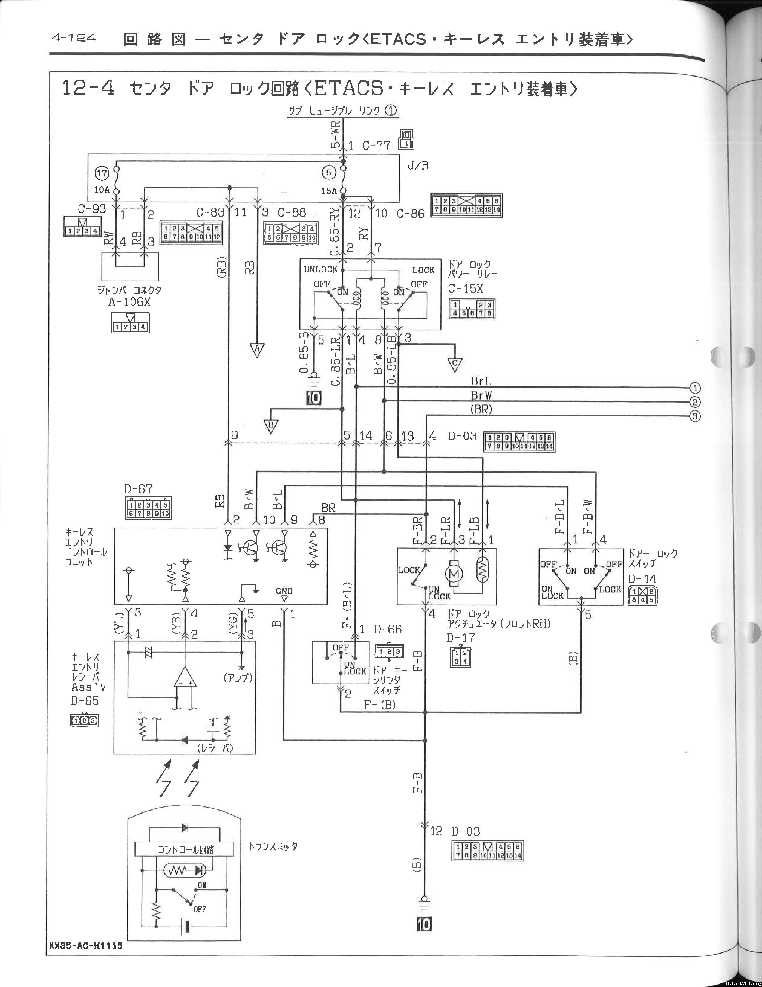

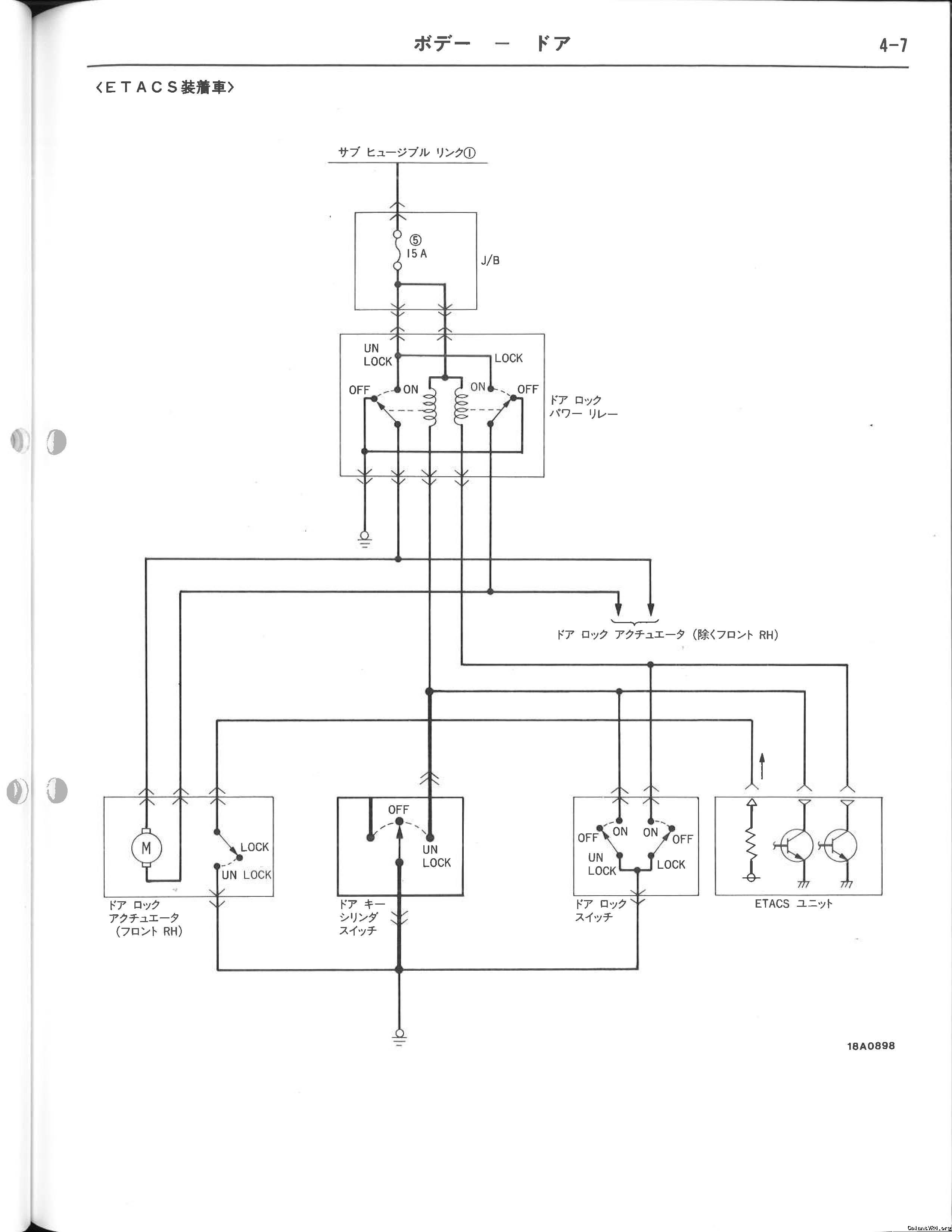

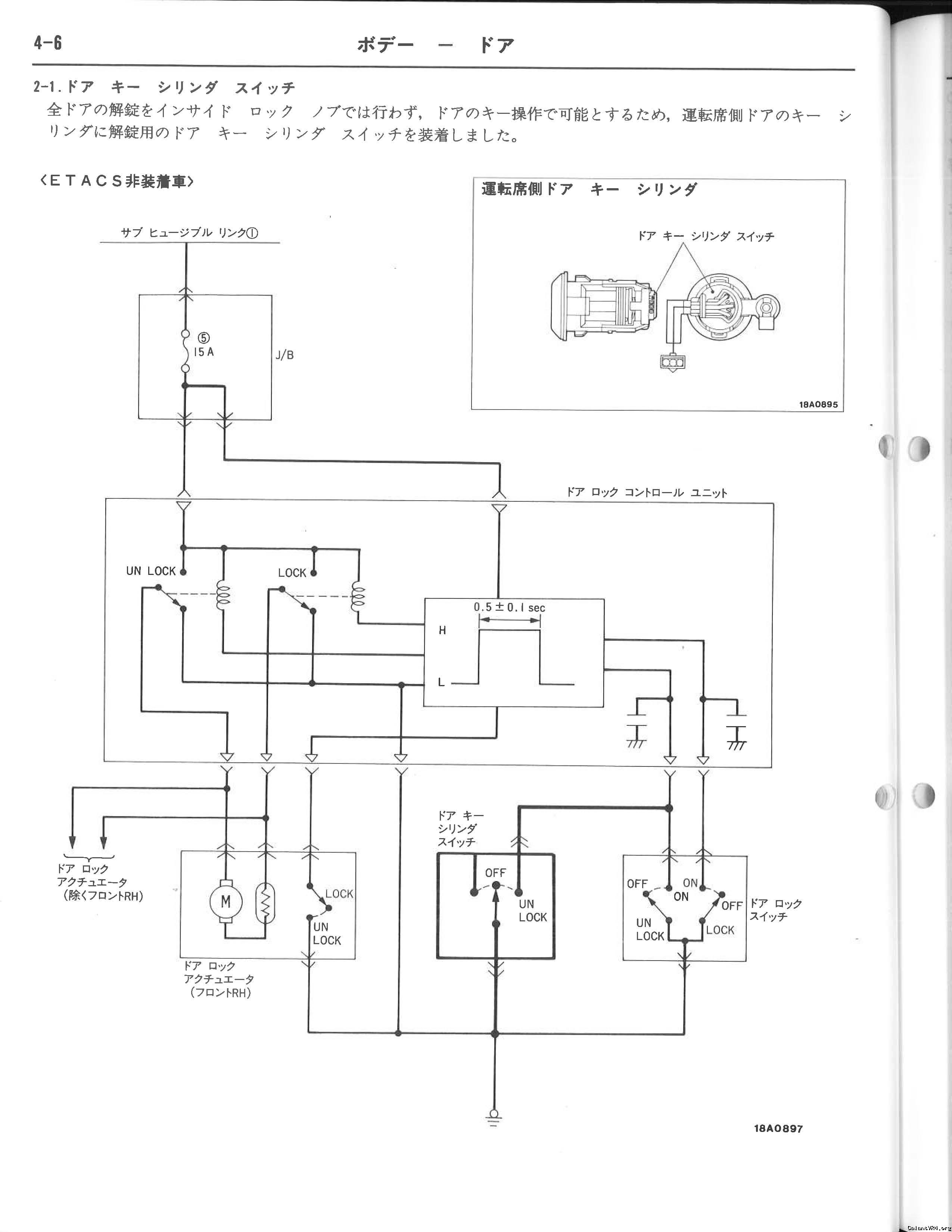

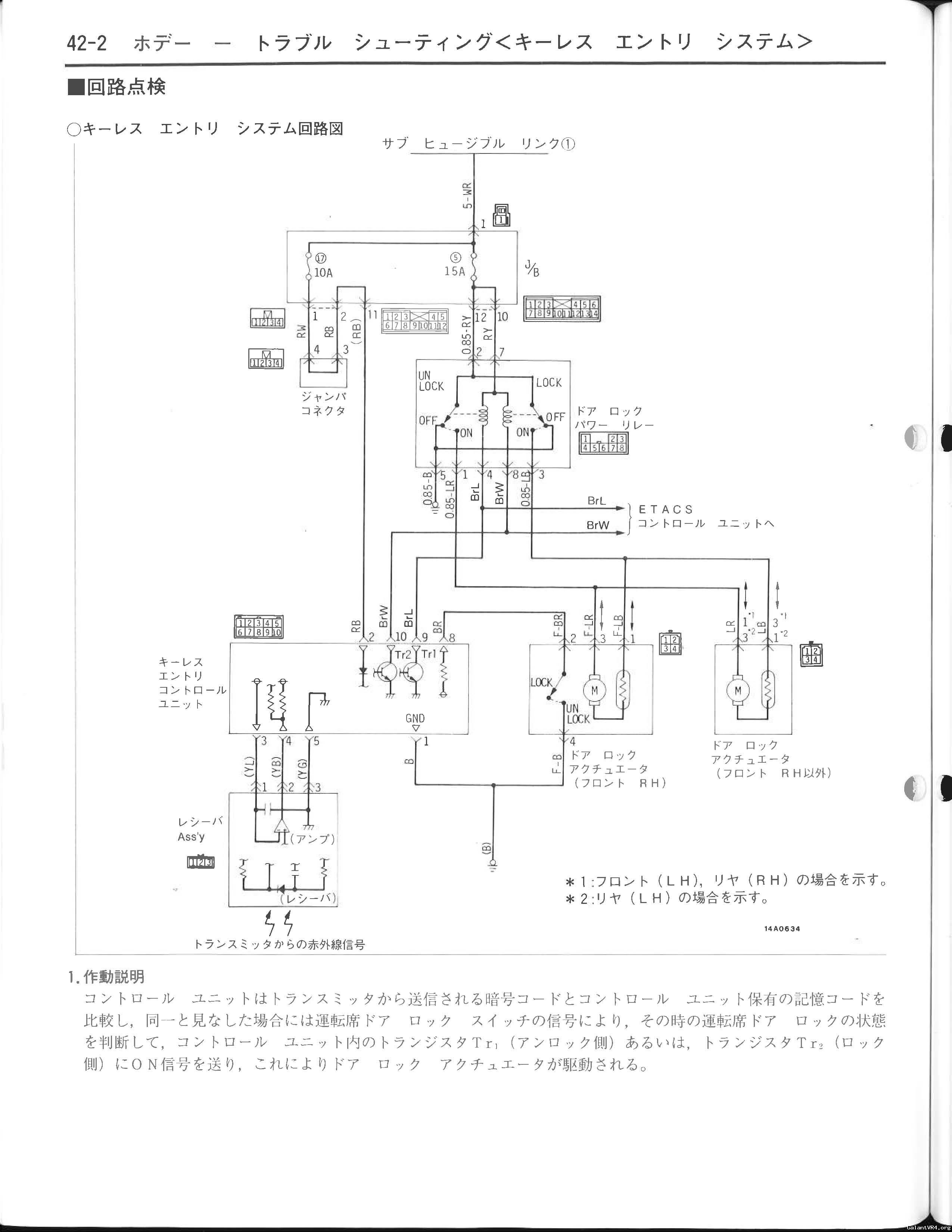

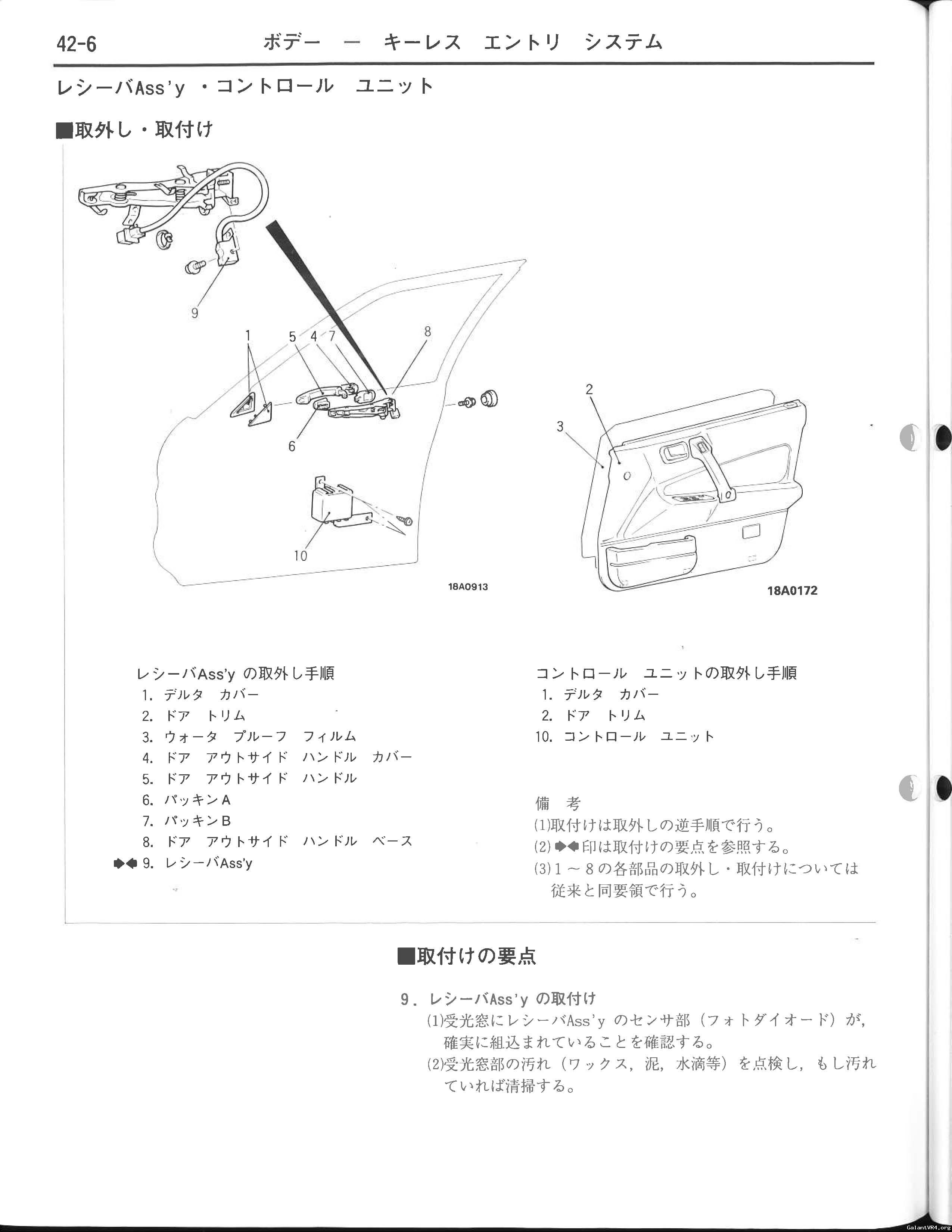

Here's why you need the japanese. I apologise as there are ZERO instructions for the system in english anywhere.

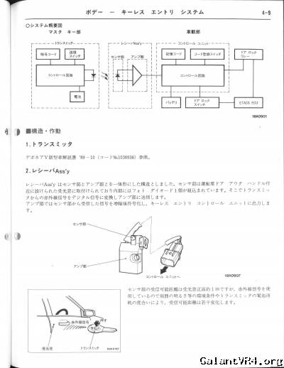

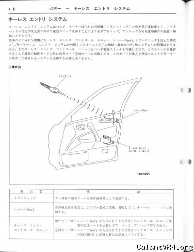

Here's the tech manual explanation of how it works:

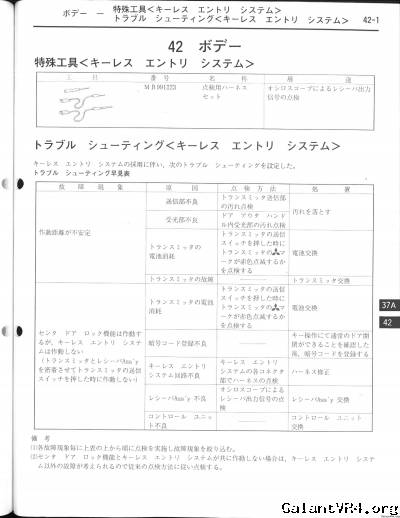

Here's the Shop Manual with the 'teach' mode:

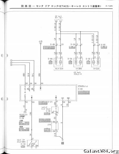

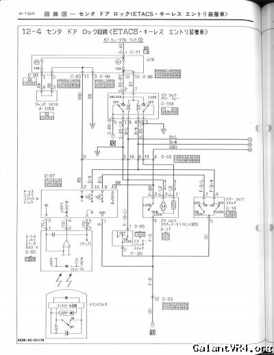

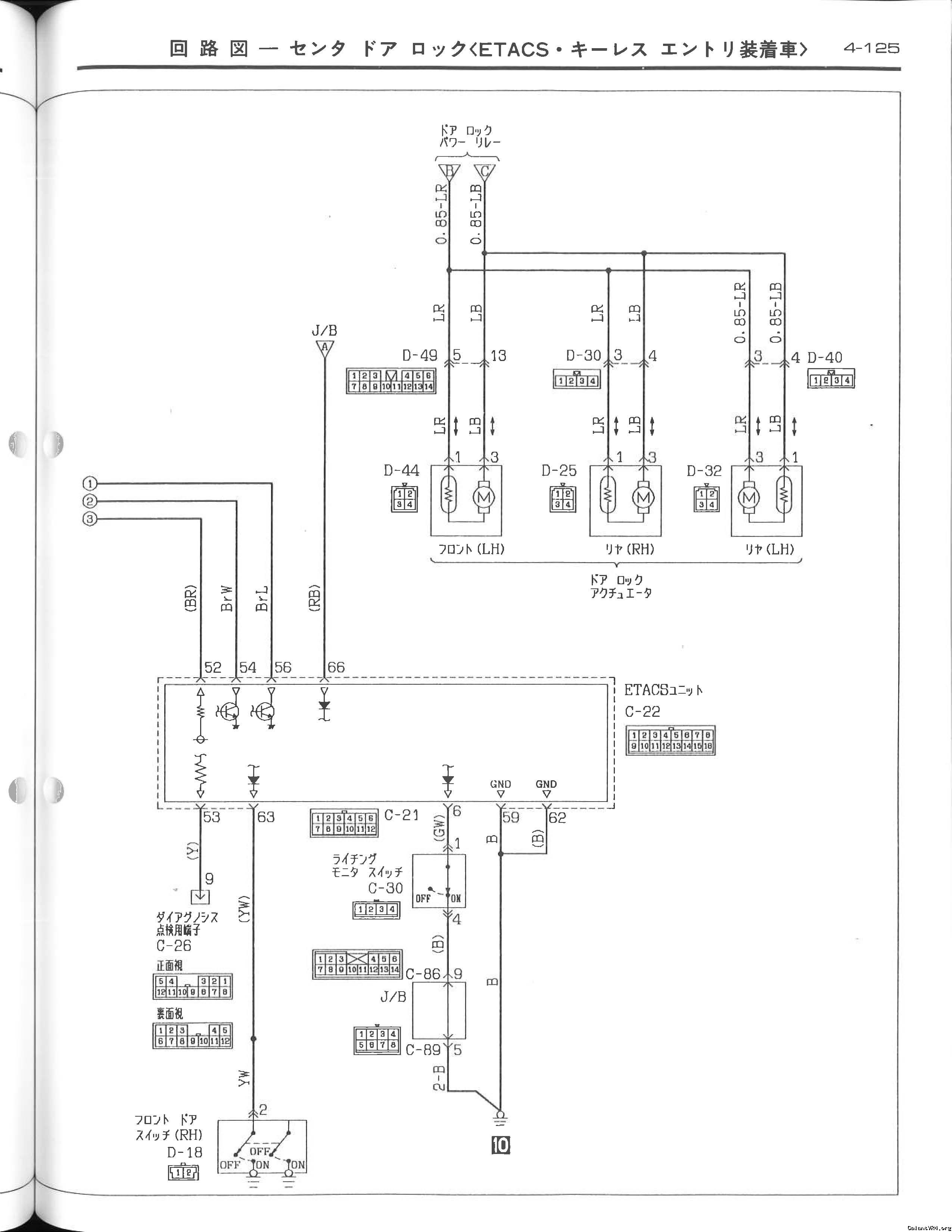

Here's the wiring diagram in the wiring Manual:
Config diagrams and cnnector locations are here:
Hope this helps.
