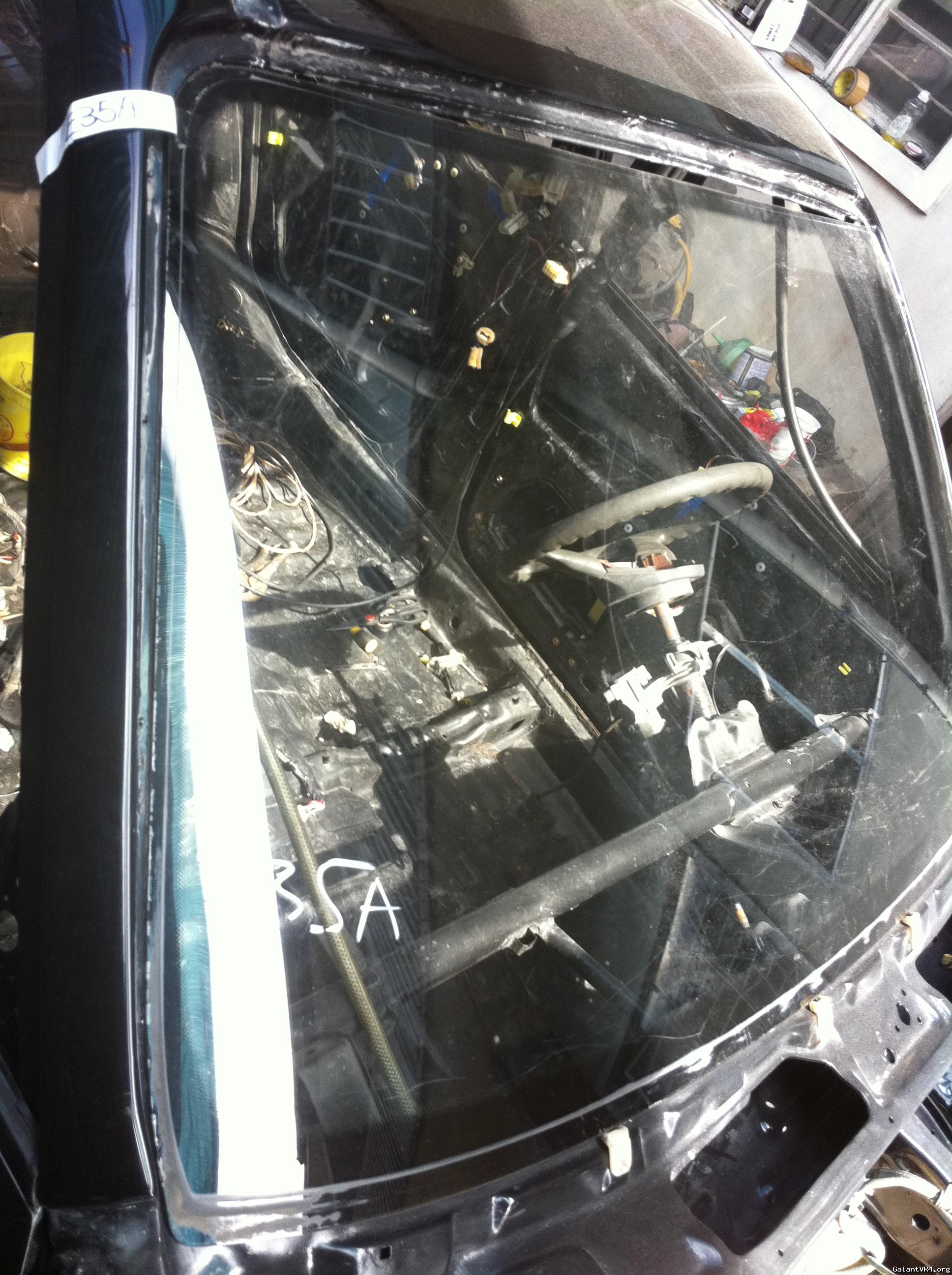

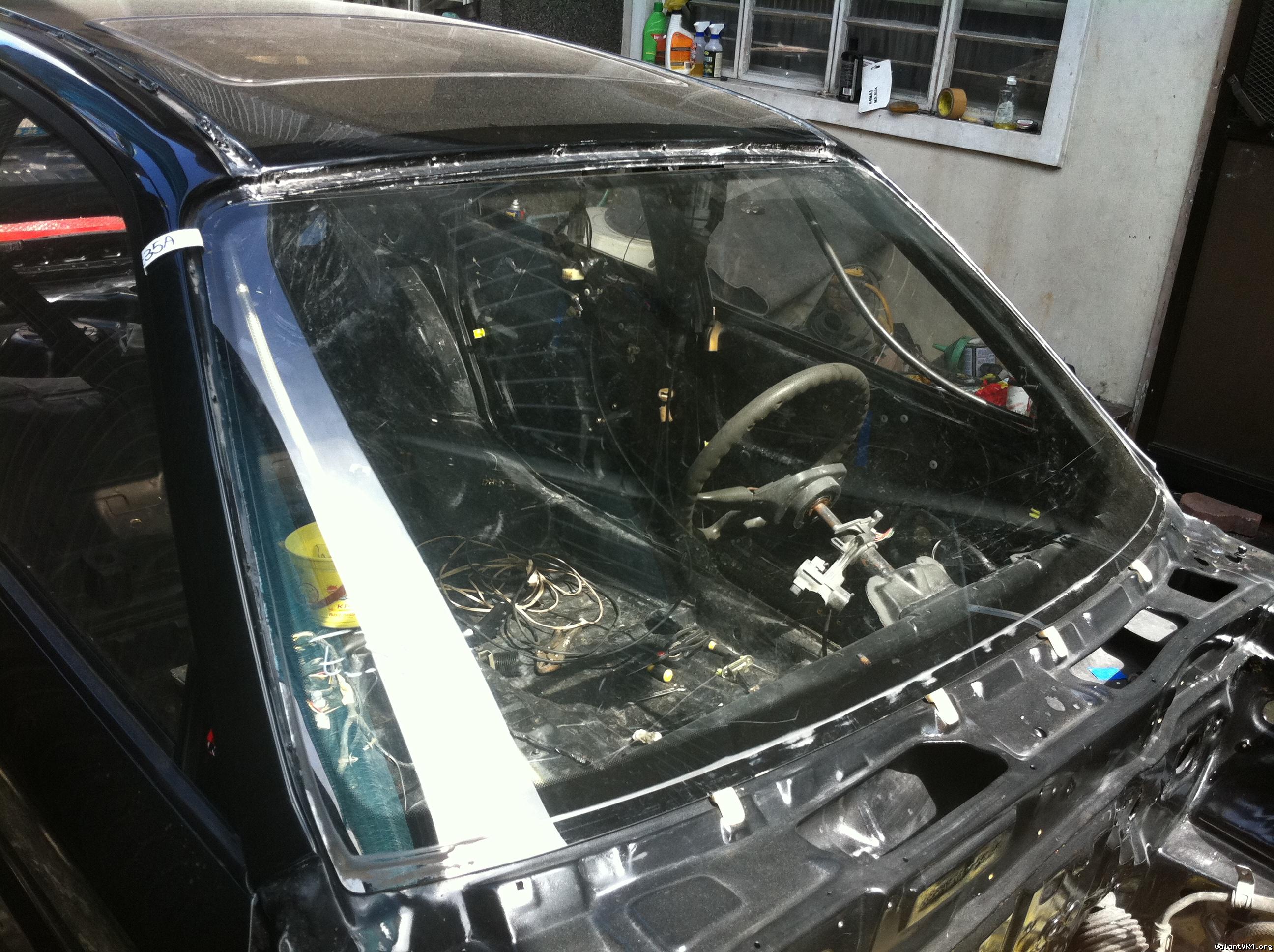

heres a front windshield of the eterna on my vr4.bought the windshield by mistake.

thanks for showing actual evidence kama!

No prob sir.from what ive seen,door glass and door itself is shorter on the eterna too.just dont have a pic.
