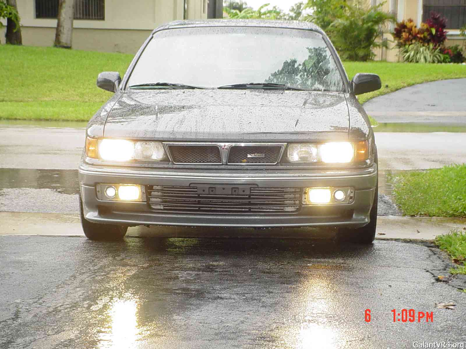

I'm on the fence about whether to pick up the projector fogs, to replace my orange blinker fogs. What are projector people using for a switch, location, wiring? What type of bulbs will I need? Without the orange blinkers in my existing JDM fog housings, will my 2-bulb corners be enough for people to see? I need visible front blinkers.
The trim pieces are missing on the sides; will that be a problem, or can those be made with some scrap plastic and paint to match?
Any info from owners of these lights is appreciated. Thanks.

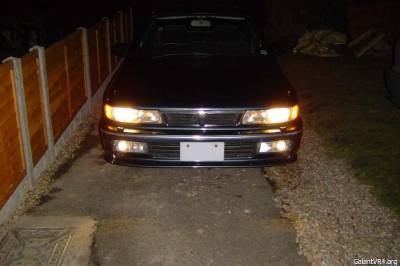

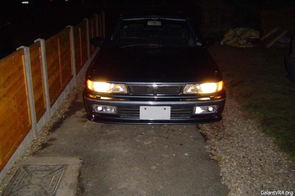

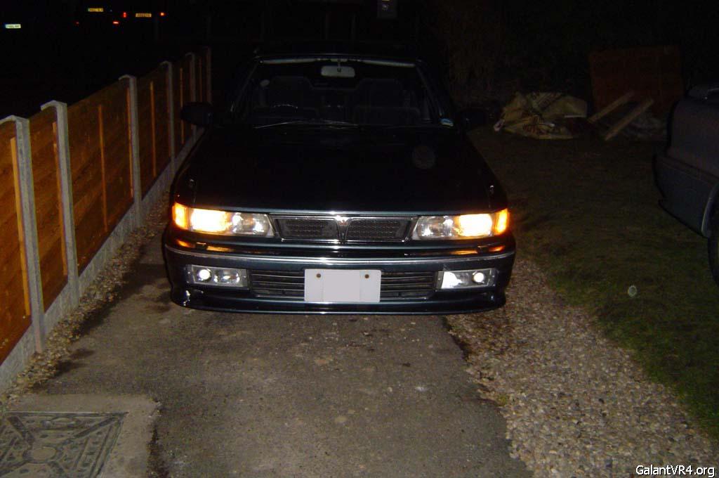

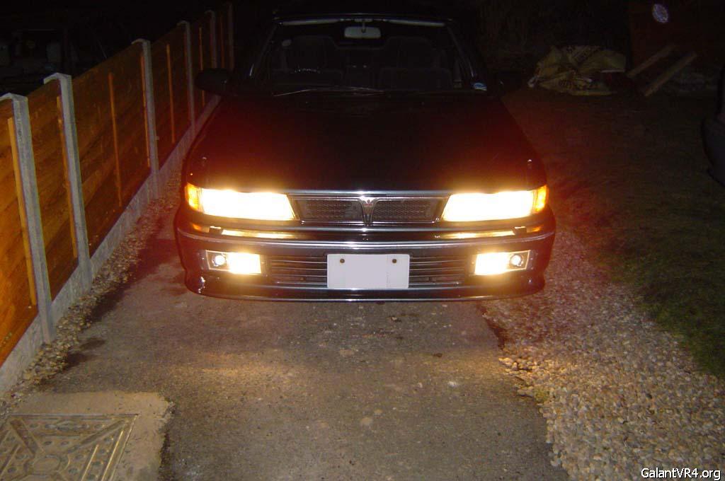

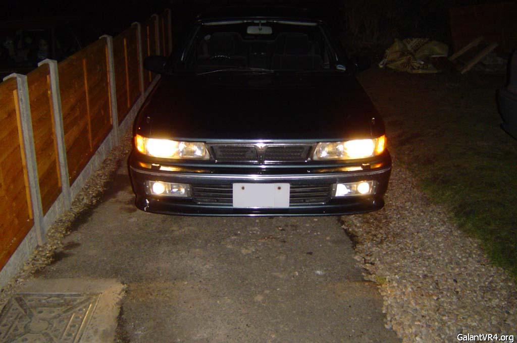

No you'll need the single bulb JDM corner as a blinker (as intended in japan) then the outer fogs come on when low beam is on, then high beam gives inner fogs.
I'll snap some pics and post

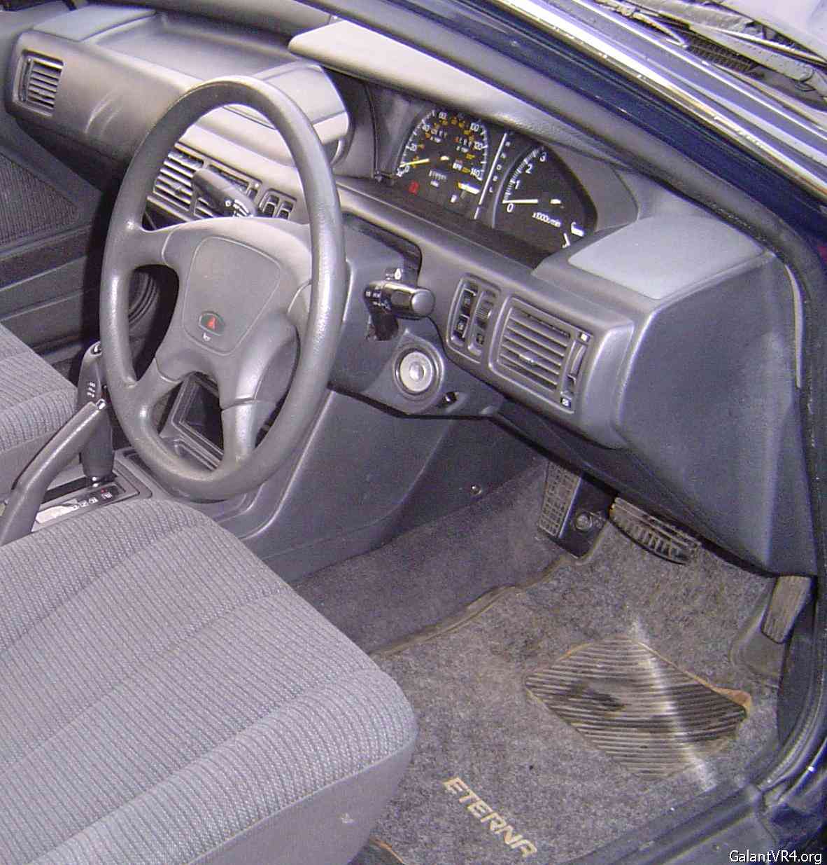

Yeah the other does the rear fogs. The twin button was never a jdm fitment just europe and others where its a legal requirement to have rear fogs. I think oz, hongkong and nz had too.
Top for front, lower for rear
This is from my eterna sava I converted to have the correct uk wiring.

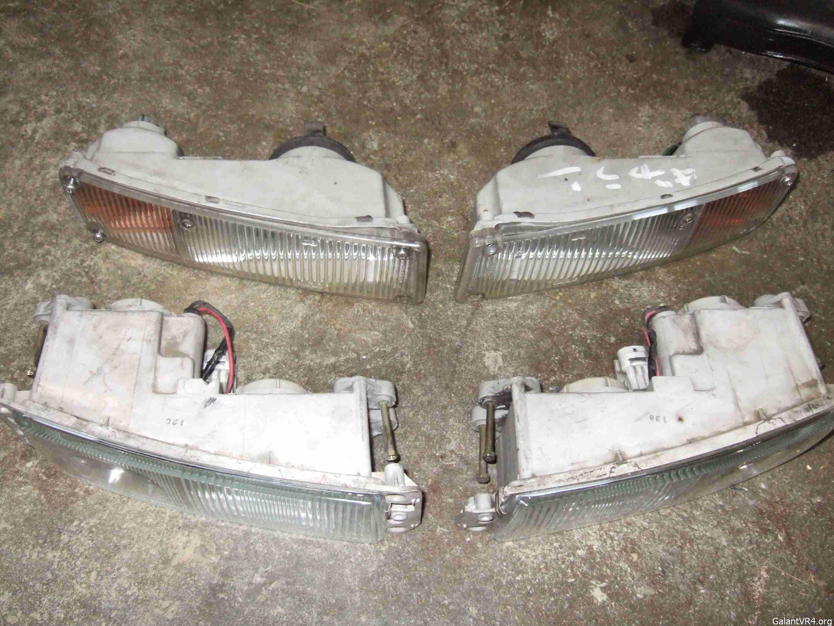

but what i did was use the H3 bulb that was in the fog and wire that to its own positive and negitive with a new switch inside the car.. i tried it thru my excisting harness and the relay went nuts clicking so i decided to make my own harness...
than i socketed a 194 bulb into the other part of the projector foglight assembly, with some cutting and soldering... that worked out perfect and now i have blinkers in the front.. since i have single bulb jdm sidemarkers and i just use them as my markers, not as blinkers

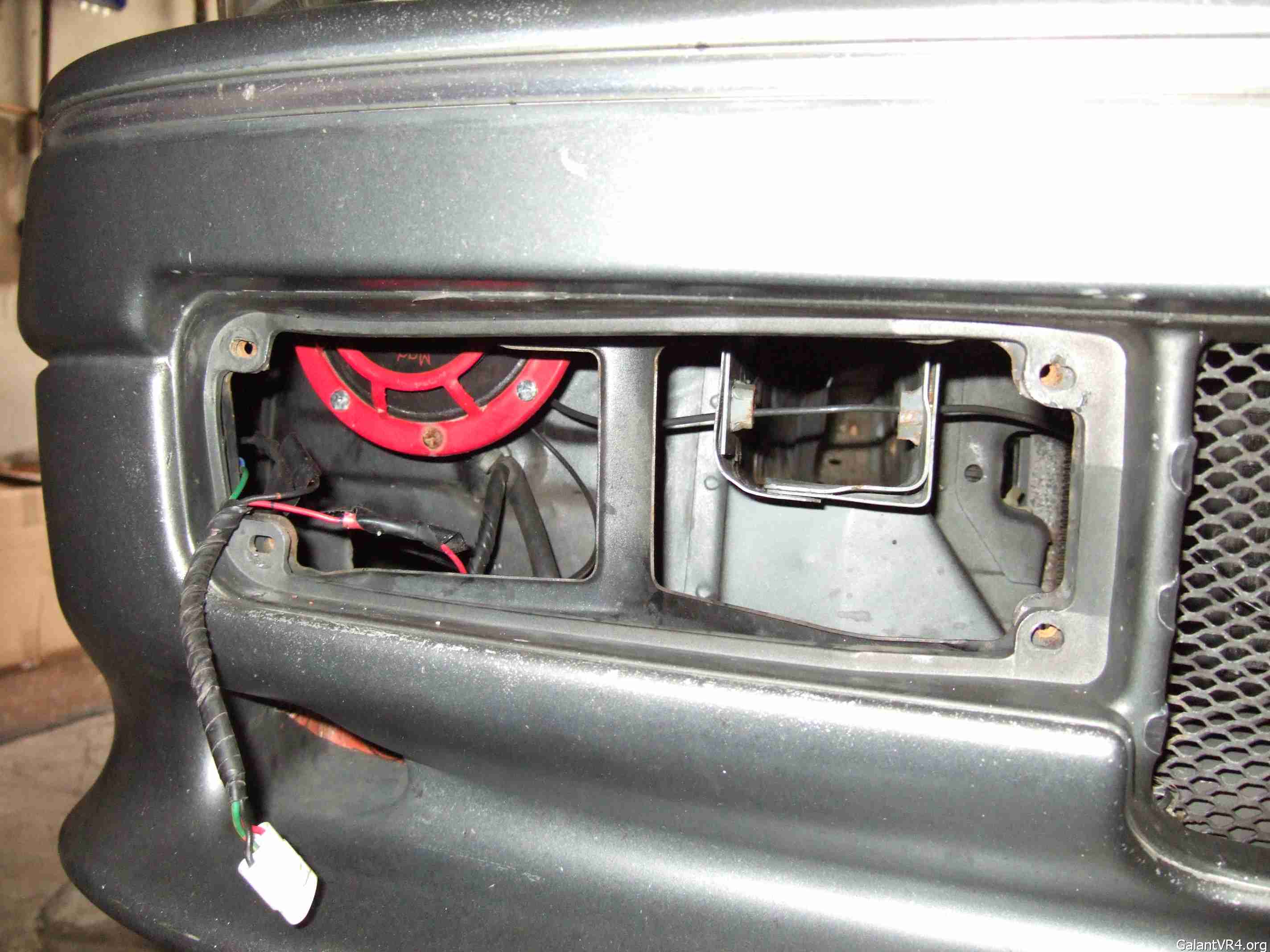

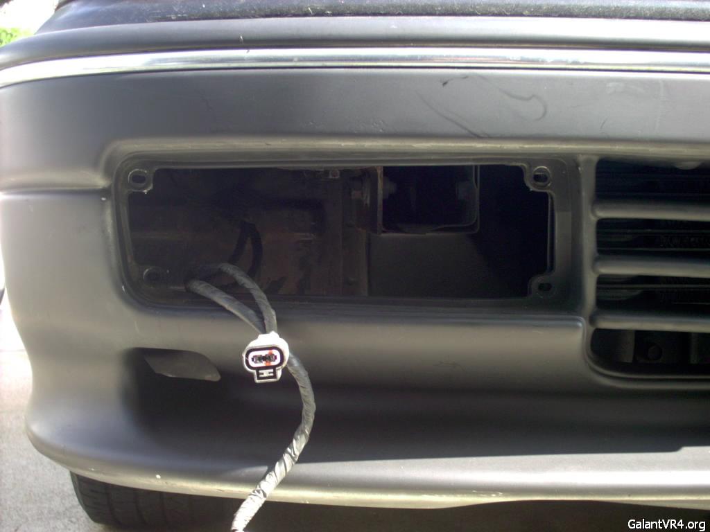

Well, I still haven't tackled the wiring yet, but how do the projector fogs fit into the holes in the bumper? I've got a verticle metal bumper brace in my cutouts that prevents the projector fogs from going all the way into the bumper. You can see how much deeper the projector fogs are than the orange blinker fogs.

you are going to have to cut that verticle bar. the jdm bumpers that came stock with projector fogs came with a different brace that wraps around and bolts to the the lights

cp, just hack out the vertical brace out, cut it flush at the top and the bottom! all the bolts in the corners are the same, only braced up to '89

I did that, but now I need some longer bolts for the lights, as the ones I am using with the orange blinker fogs are too short when used with the projector fogs.

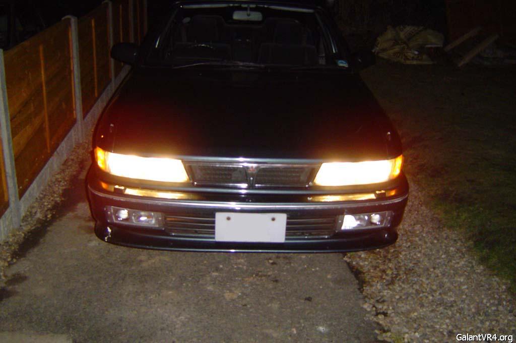

Cy, I've got an extra set of projector screws. Let me know where you want me to ship them. I can send them out tomorrow. My inner fogs are hooked up to the parking light & outter to the oem fog switch. When I turn on my high beams the lows stays on however if I have the outter fogs on they turn off automatically. The projector fogs use h3 bulbs.
