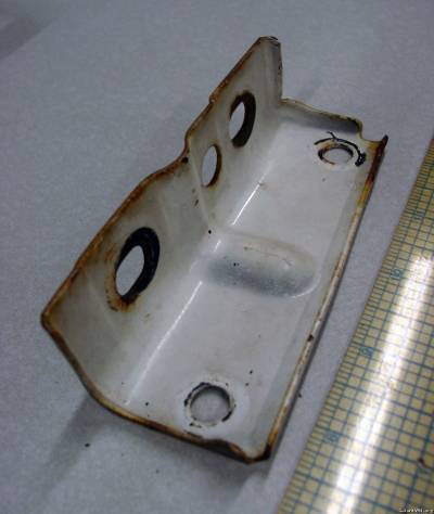

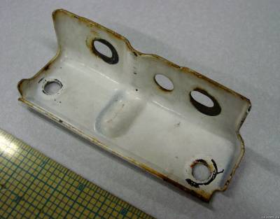

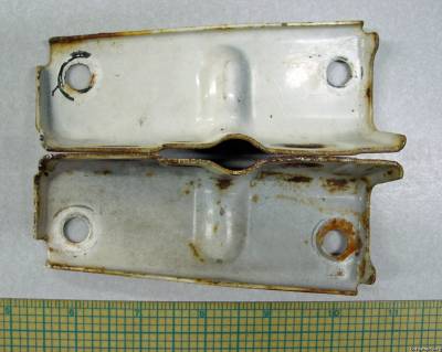

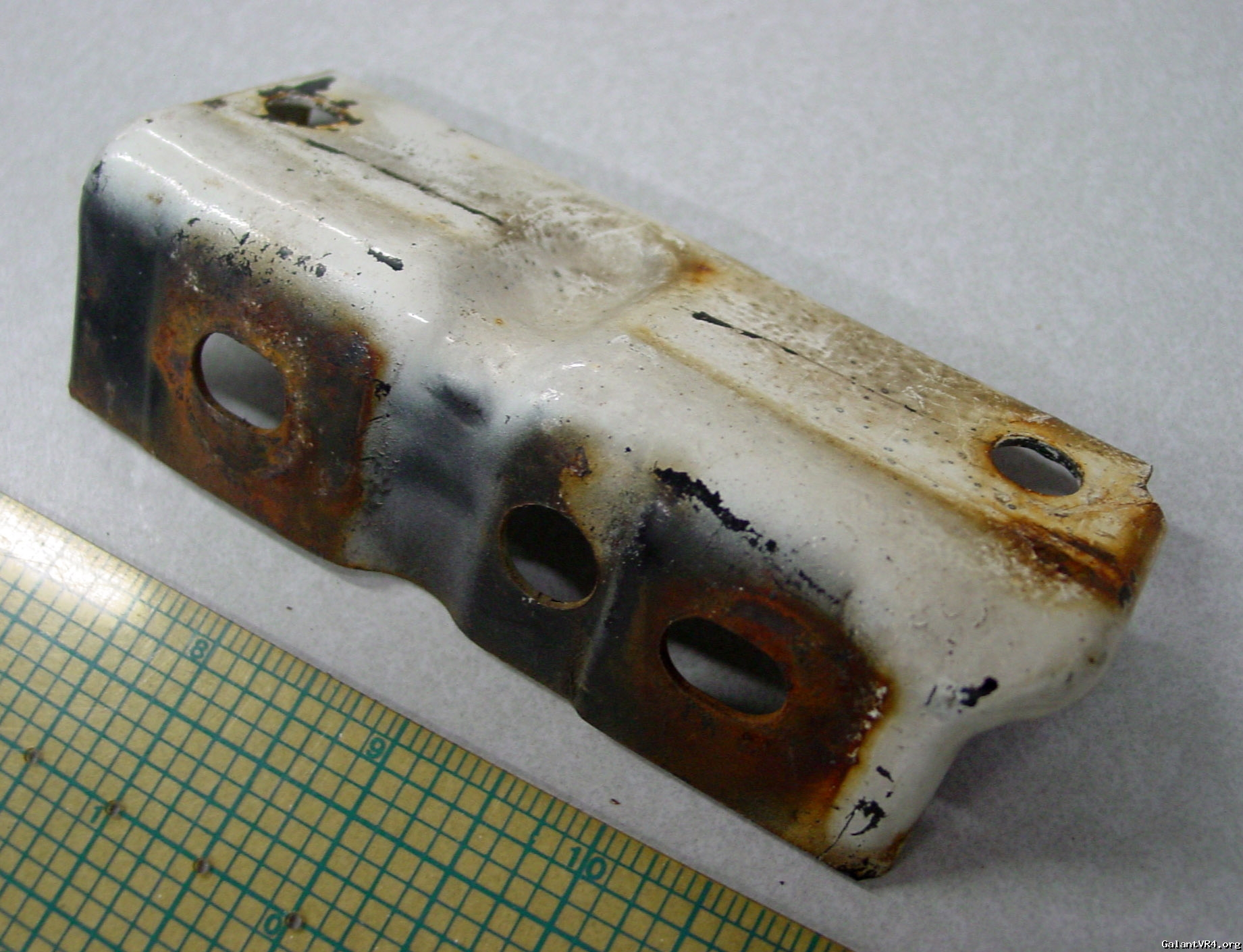

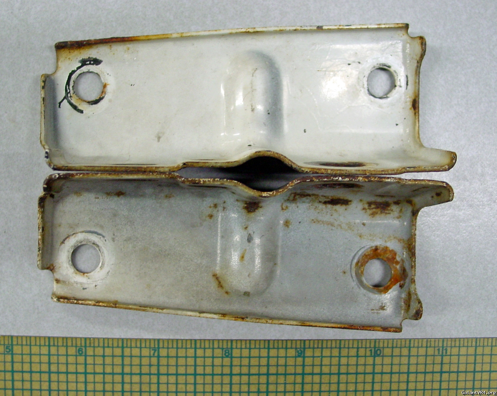

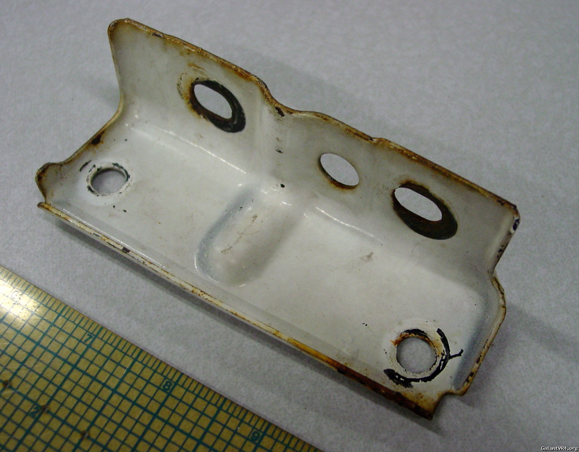

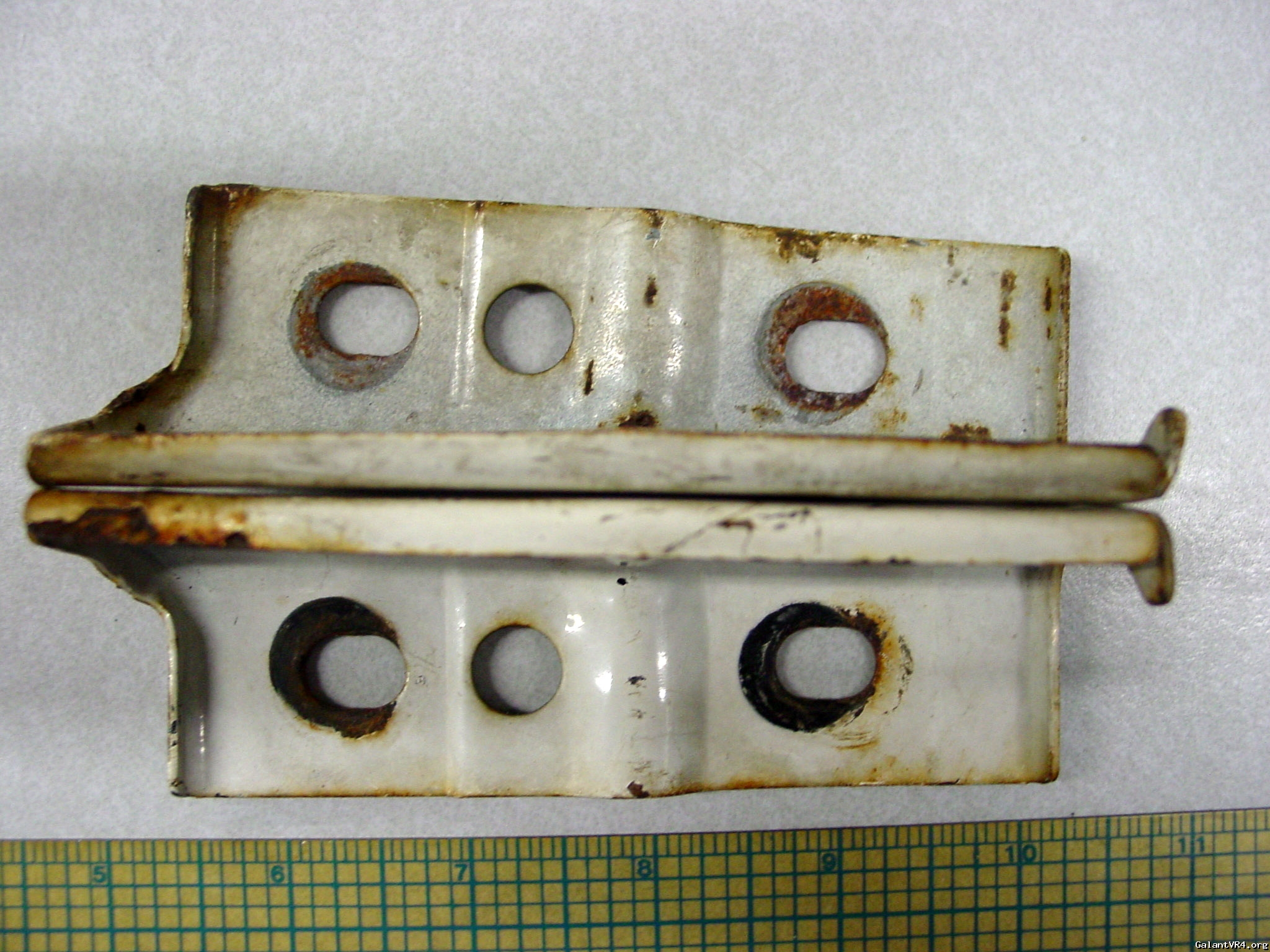

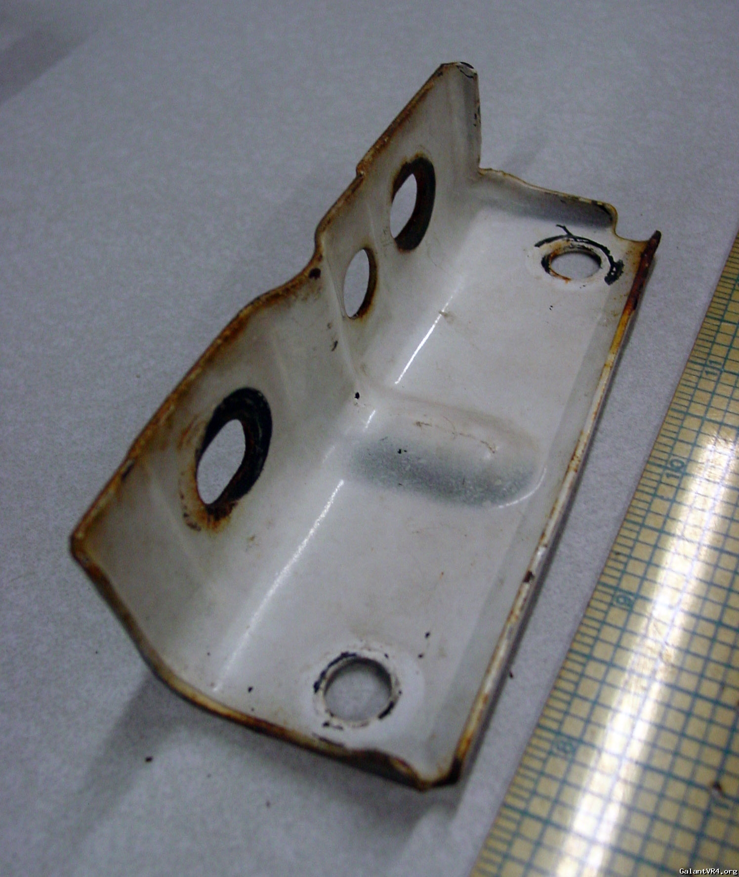

Here is info on bumper brackets in 3 parts. Part 1 = original bracket photos. Part 2 = sketch with dimensions. Part 3 = homemade brackets.
Part 1:
Mike R.

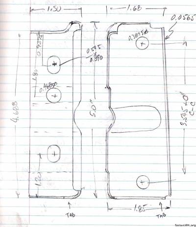

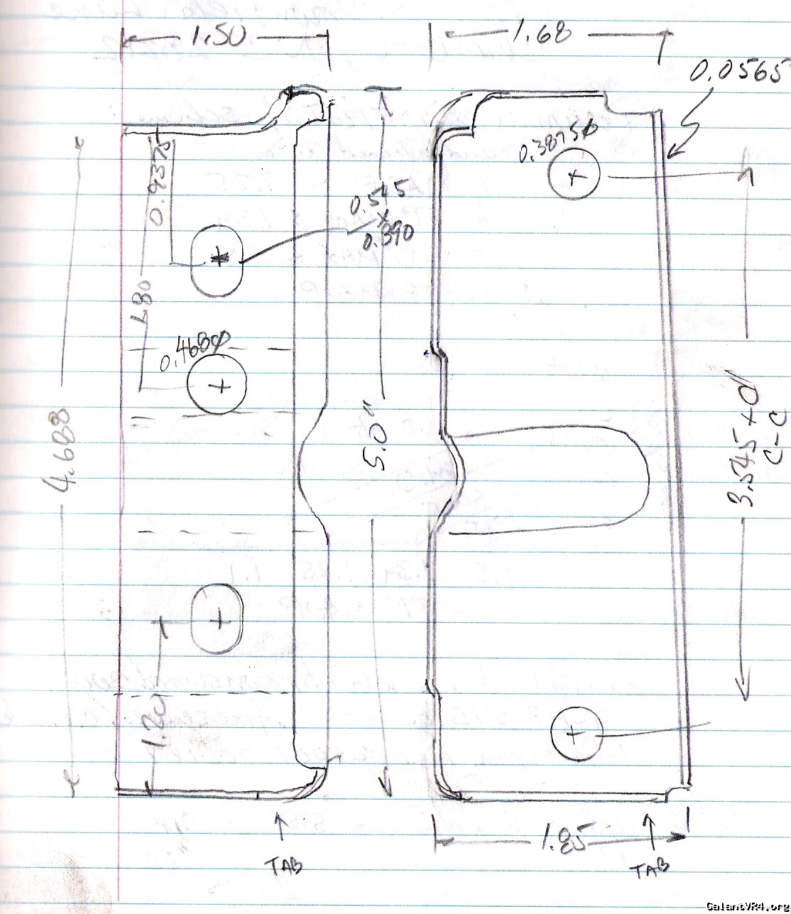

Part 2:
This is one bracket. The other is a mirror image. Dimensions were made with a dial caliper but note that the parts are stampings with rounded edges.

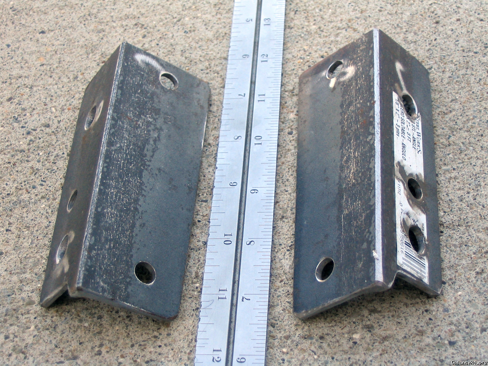

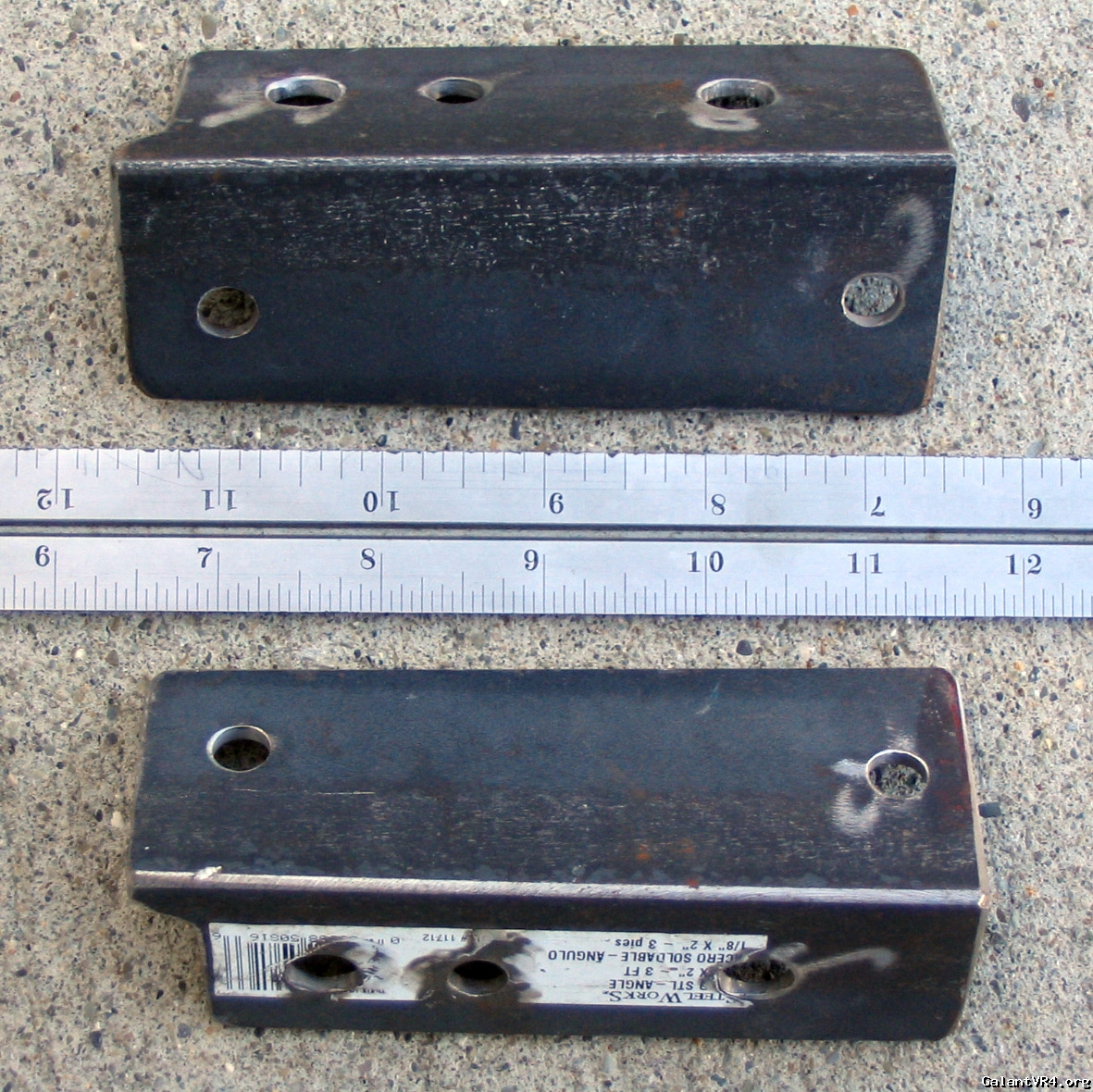

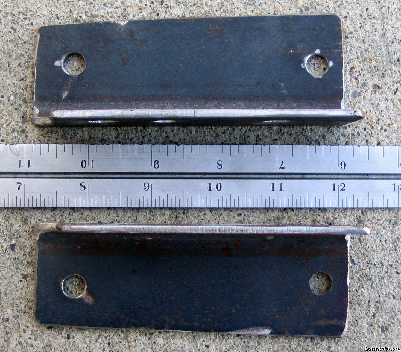

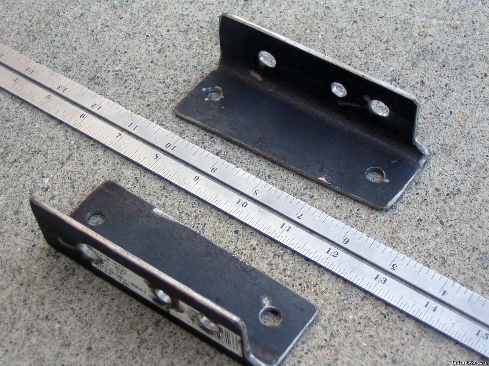

Part 3:
Homemade brackets, from 2x2 angles x 1/8 inch thick, available from any Lowe's/Home Depot. Brackets cut on a bandsaw, holes drilled with handheld drill. They do fit though a couple holes needed slight adjustment.
