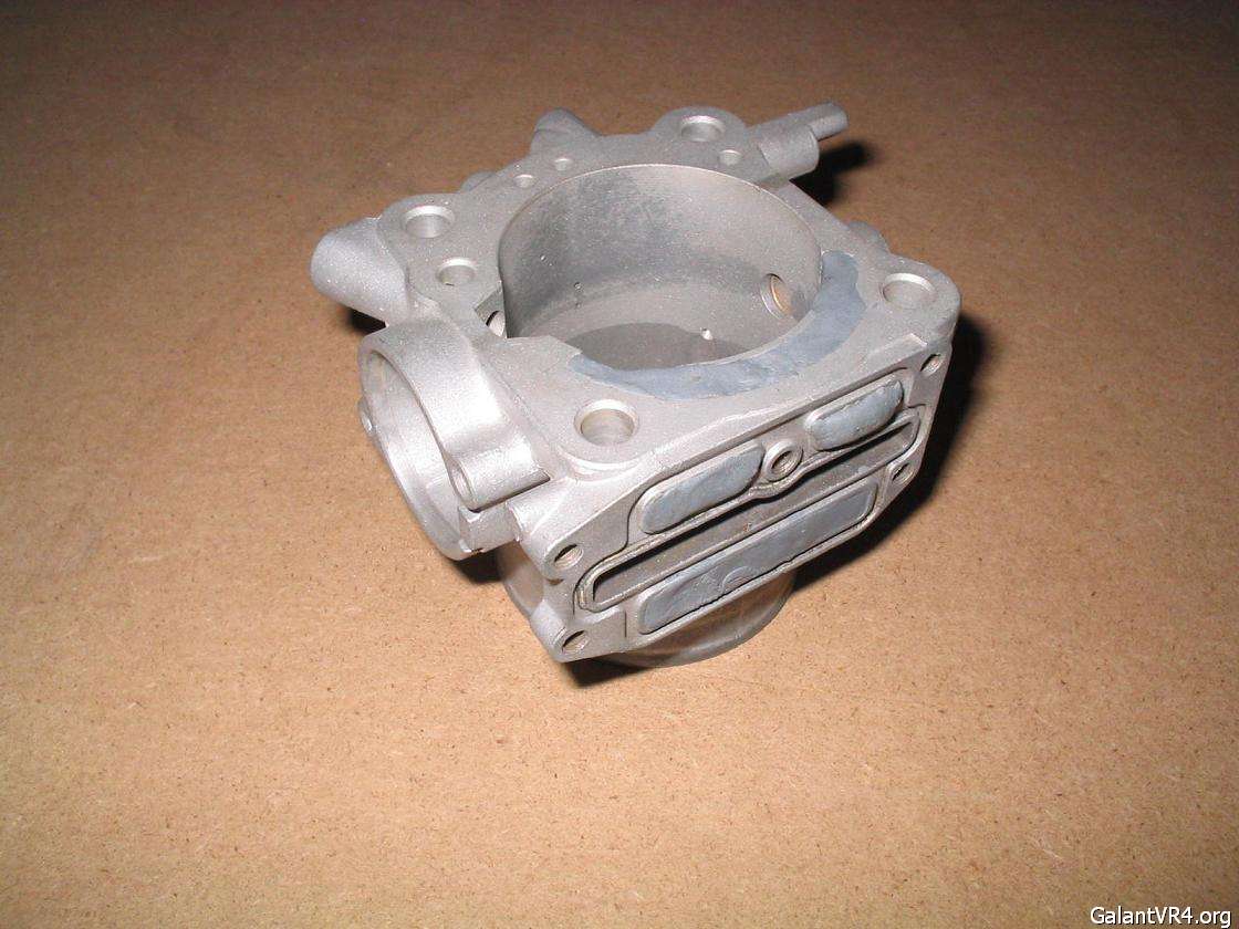

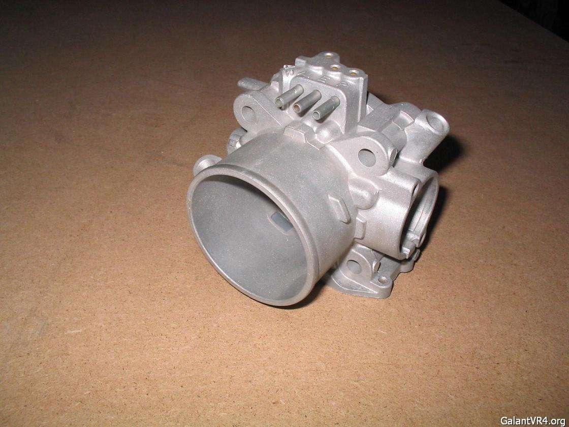

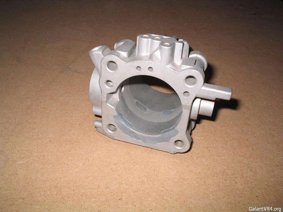

fabbing a plate is too much work, however, is reversible. Bare tb's are cheap, so I did this to a NT 91-94 tb.
the liquid steel was later smoothed out. New tb seals, idles like a champ.
