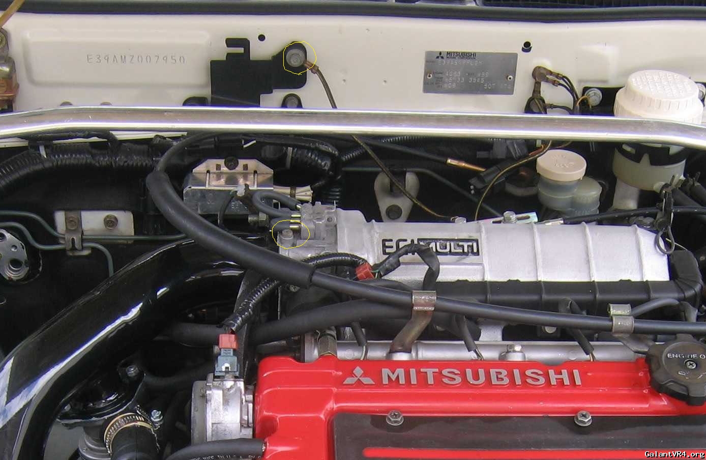

Basically, the t-body needs to be grounded because the closed-throttle-switch on the back of it needs a ground to tell the ECU the throttle is closed. Most of these cars are missing the bracket that normally grounds the t-body.
"Why does it need a bracket? Its bolted to the intake manifold!" you might say. The t-body is isolated from the manifold with a gasket. The bolts pass straight through the holes in the tbody into the manifold and may not make contact with the tbody it directly.
If your idle sometimes hunts up and down by about 200 rpm, or you're sometimes unable to adjust your keydiver adjustable stutterbox, or your adjustable stutter box seems to change settings even when you didn't change it, you probably have this problem. What you want to do is ground the t-body using the bolt in the top, per this example (which is also apparently missing any type of ground)

My problem is that the closed throttle switch works when the engine is cool but then becomes fickle when things warm up. I can't seem to get it adjusted correctly. Maybe this will help.
Yea my car idles really high when the car is moving even if i'm not touching the gas and I'm not in gear....then as soon as I stop the car is goes up and down a few times then very very!!! slowly settles to its normal idle...usually takes like 5-10 minutes. Maybe its because my ecu still thinks the throtle is open? I'll have to check into this to see if mine is grounded. This part might sound stupid but I just run a ground wire from the negative terminal to that bolt? Or from that bolt to a random grounding spot like a bolt in the firewall or on a wheel well?

I circled a ground spot on the firewall.

From looking at that picture, why would you even need a bracket? Just run a wire from the TB to the firewall. That's what I'm going to do.

Yup thats all you need to do. The bracket was the way it was done from the factory, but its not the only way. You can just run a wire to any ground point. The original bracket went from the point circled on the TB to the TB bolts that go through the elbow into the intake manifold. That way the TB was grounded through the bolt into the manifold.
