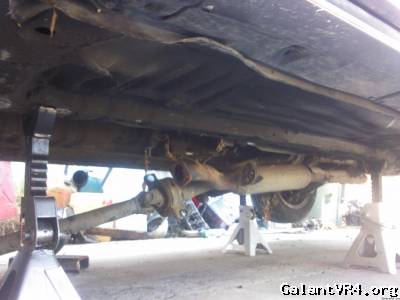

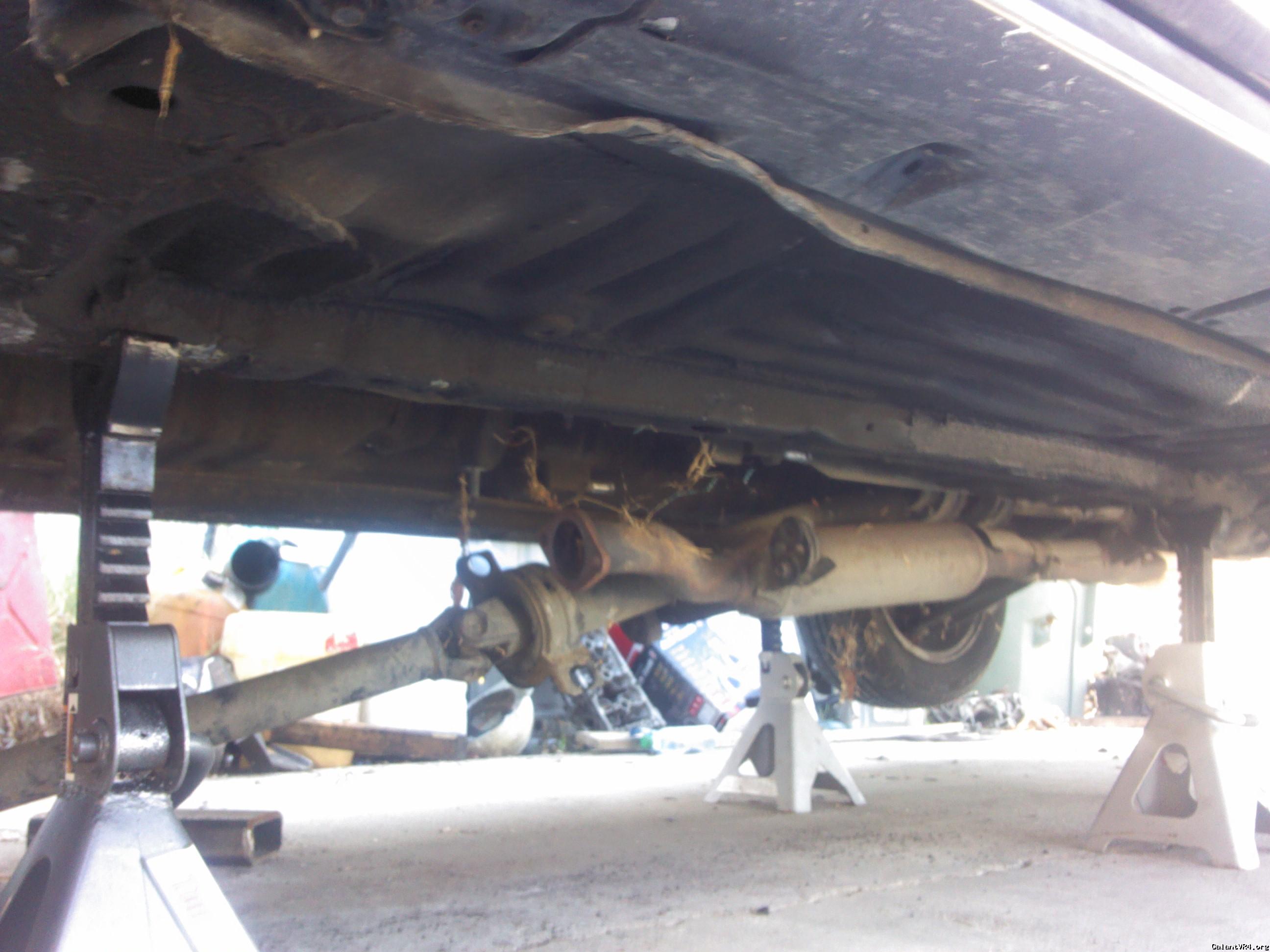

Is this the best place to have a car lifted up on all four jacks thought I ask since this is the first time ever having a car on all four last thing I want is this falling on me since im going to be under there.

I wouldn't put them there. Often you'll see these cars with dents all over underneath because people put jackstands in the wrong places.
I generally put the fronts under the back of the control arm. There's a nice round thing there that sits nicely in the jackstands. I haven't bent, dinged, or torqued one out of round yet. Sometimes i also put them under the front crossmember, next to the bolts on each outer side. As for the rear, i do something similar to the front and put it where the trailing arms are bolted in to the frame. Again, no issues with anything getting messed up there. Pinch welds and frame box are never a good idea on these cars for jacks/stands.

I've put jackstands in those spots for years. No problems so far. I just make sure to put it where there are two layers of metal. And inboard of the broad spot that is *always* dented in.

The technically correct place is the pinchwelds at the corners. You might even see the notches the factory puts in to help you locate them. However, most of our cars have serious rust issues in the rear dogleg/pinchweld area and may not be the best place. But, I just simply moved the jackstand further inboard along the pinchweld. The beams you have it supported currently are not a good spot and are there for floor pan support. Constantly seen those beams dented and once they go through the beam, they go through the floor board.

I think the thing with those beams, is there is a point where several layers of body panels come together. If you were to put the jackstand on those beams closer to the middle, they dent. However I put them towards the very front and rear where you can see a second layer of body panel over laps. Perhaps that combined with the fact I use padded wood blocks has kept my cars dent free this entire time. /ubbthreads/images/graemlins/dunno.gif

It doesn't hurt to use a block of wood either. That way the stress gets distributed more and the wood will crush first.

I was gonna say I love the control arm bushing spot myself because of how securely it fits into a stand, but since you are removing the subframes, not the ideal choice...

Only if you are using the factory jack. Also the pinch welds are to only temporarily lift the vehicle to change a tire. Not support the entire vehicle, especially with the type of jackstand he pictured. Those chinese jack stands are scary.

I've used the factory jack points for jack stands on every unibody car I've worked on for over 20 years. They are a solid, stable place to rest the car. It also keeps the jack stands away from your work area. I believe I hold the official JSB record, my car spent has spent more time on those pinch welds than it had on tires. The exception would be rusty cars. I live in CA, I've only seen pictures of rusty cars, but I'm told they do exist.

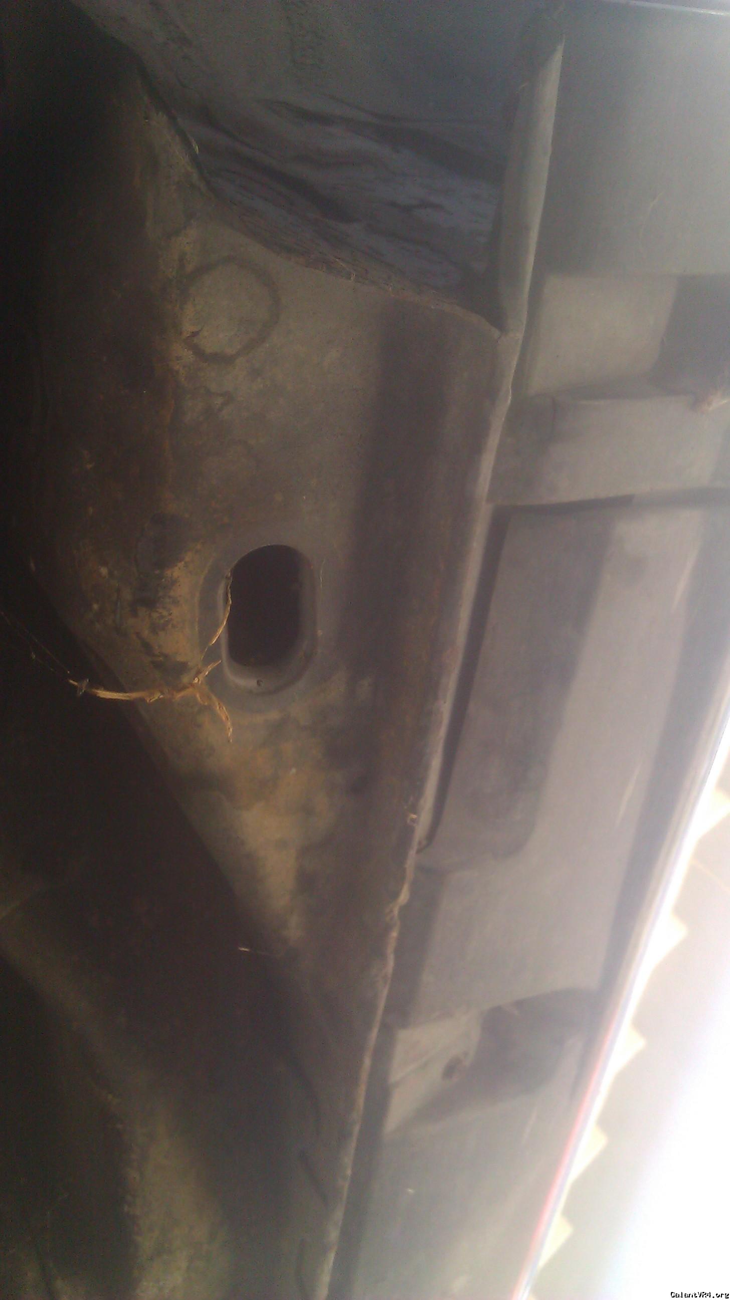

This is why you don't lift on that beam. There is nothing there. Look how thin it is. Even at the ends, it was never meant to be a support for lifting or support.
And even the service manual shows lifting at the front cross member and rear diff. And supporting the vehicle at the pinchwelds.
