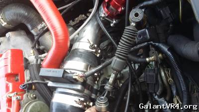

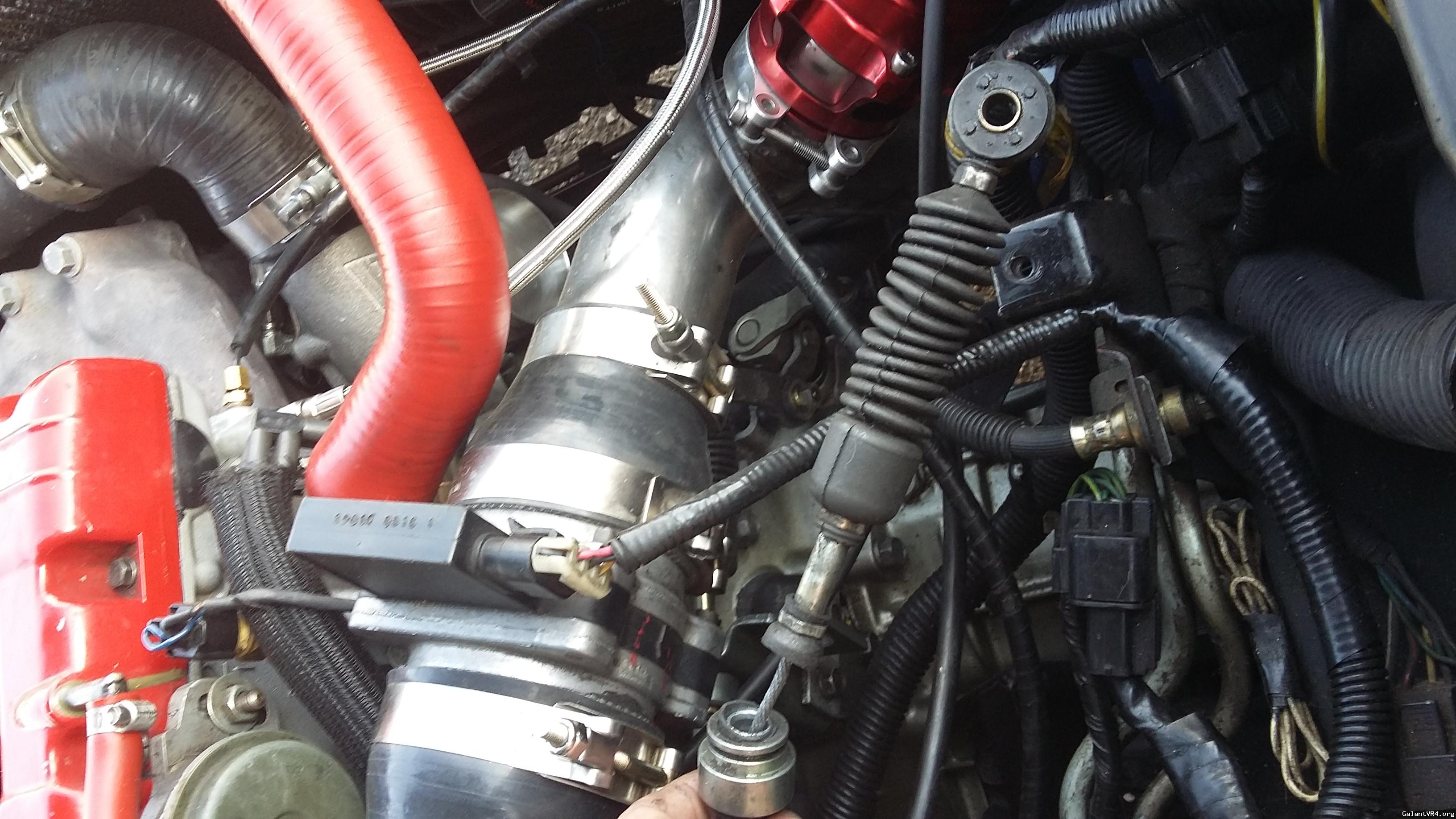

Is this shifter cable toast?
transparentdsm
Jul 27, 2011
3,690
Cherry Hill, NJ
i just had this happen to me. i jammed it back in there and smacked the edge with a screwdriver and hammer to keep the sleeve in place, but still having movement and its been good for a few hundred miles.
mitsuturbo
Jun 2, 2008
3,551
Near Seattle, Washington
You can get it to work well enough to get you by for a bit. As was mentioned, shove it back together and dog the edges of the retaining piece with a screwdriver. You're going to probably have to replace it before too long, though.
