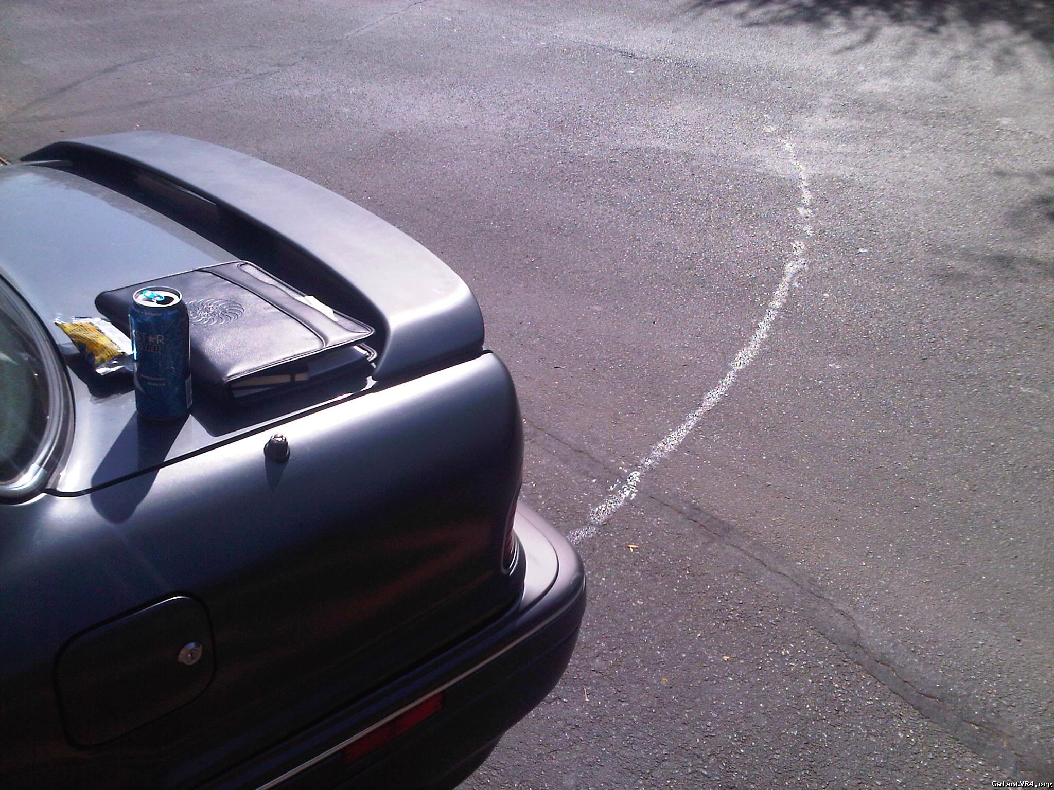

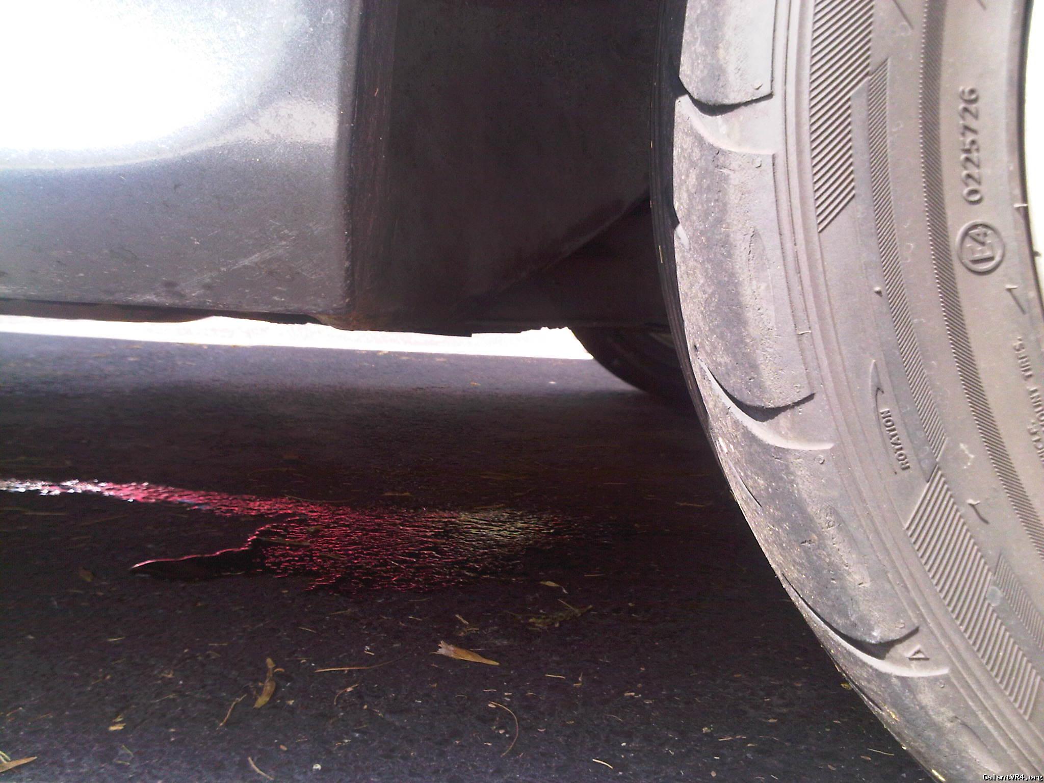

I spent every weekend for a month draining coolant and replacing this or that cooling system component. I've finally got all the hoses, gaskets, thermostat, radiator cap, and water pump replaced. 464/1000 is running like a champ. Temp gauge points to about 11 o'clock 90% of the time.
Still, every morning when I pull into work, I see this behind the car.
It's coming from somewhere near the firewall.
Freaks me the f*** out. I pop the hood, I find no coolant leaks, the levels look fine, and the only moisture I can find anywhere is some condensation on the AC hardline going through the firewall. It's "monsoon season" here in Phoenix, so we've gone from 105*F w/ 3% humidity to 115*F w/ 40%+ humidity. I suspect it's also more humid in the morning, too.
Temps during my drive to work in the morning are usually about 98-100*F.
Temps during my drive home in the evening are usually around 105-110*F.

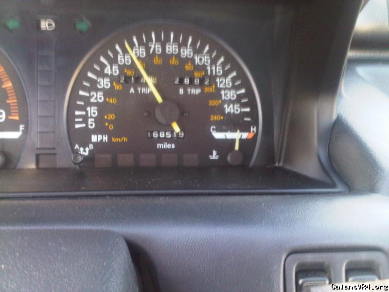

On the drive home, I see my temp gauge climb a bit. It will go from 11 o'clock to 1-1:30. I do not smell coolant, the AC still blows ice cold, and there are no bubbling sounds coming from the engine bay or leaks like pictured above when I pull into my driveway at home after the longer, hotter, nastier evening commute.
I'm a bit paranoid and looking for words of assurance, here. When the AC's running on humid days, does the condensate tend to collect anywhere in the engine bay, likely to spill out en masse like pictured above during corners? Does it accumulate in a casting recess on the back of the transmission or something? Maybe a depression in the k-member?

Looks like there is a good amount. Take a feel / smell of it one day and see what it is. Should be pretty easy to tell with that much coming out.

Since it only happens when I get to work in the morning, I'm a bit too dressed up to be doing much snooping around the car, but I'll try to test the leakage.

I see now.... or try to take it for a spin with the AC off one day and see if it does it.

You guys are funny. I tested the leak. It's water. No color to it or coolant smell.
This is just water. It's just that, combined with the temp gauge moving like it does during my afternoon commute (and after spending a month swapping out various cooling system parts because I was a lazy bastard and didn't just replace them all at once), I'm still a bit nervous about cooling system function.
Exhibit A:
This is my temp gauge all the way to work. All the way to Socal and back, even after 4 hours plus at 80mph (3900rpm) with the AC cranked climbing hills and racing across the desert. It's also what I see for 80% of my commute home every night in 112* rush hour slow-n-go with the AC on as well.

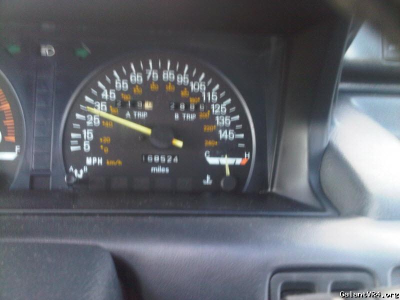

Exhibit B:
This is what my temp gauge does towards the end of the highway portion of my evening commute. This is the hottest time of the day (again, 105-112* lately). I smell no coolant, I see no steam, I see no puddles or drips in my driveway when I get home. My coolant level checks out and the AC *barely* drops from blowing 45* to closer to 60*. This is after about 15 minutes at 60-70mph, followed by stop and go in densely packed traffic. Once I get off the highway onto surface streets, the temp goes right back to normal and even banging through the first couple gears at WOT in an effort to get the gauge to climb again won't budge that needle.
The entire cooling system is new - radiator, pressure cap, thermostat, water pump, hoses, and 50/50 premix. I know the gauge isn't the most trustworthy source, but still. This makes me nervous. Should I consider a new sending unit for the gauge? I've got a bottle of water wetter in the garage. Should I try that?
Thanks.
Try them both.
Also, you didn't say that you have new sensors and if any of your sensors are original maybe its time to replace them. /ubbthreads/images/graemlins/dunno.gif
Maybe flush out the block/head, you may have some blockage due to mineral or rust build up. /ubbthreads/images/graemlins/dunno.gif
Check to make sure both fans are properly working. /ubbthreads/images/graemlins/dunno.gif

My company van leaves huge puddles of condensation on the ground whenever I stop as well. Pretty normal stuff.

Quoting 3of1000:
Could be. Original sensors for all I know. /ubbthreads/images/graemlins/dunno.gif
Quoting 3of1000:
Attempted to do that while the old water pump was off. Shoved the end of a 1400psi pressure washer in there and blasted away until clear water came out everywhere. /ubbthreads/images/graemlins/dunno.gif
Quoting 3of1000:
Confirmed. /ubbthreads/images/graemlins/dunno.gif
