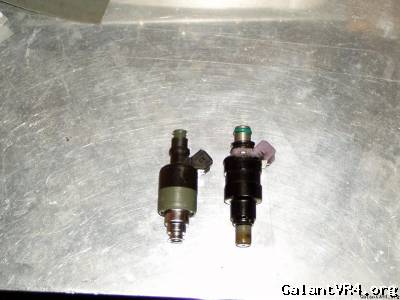

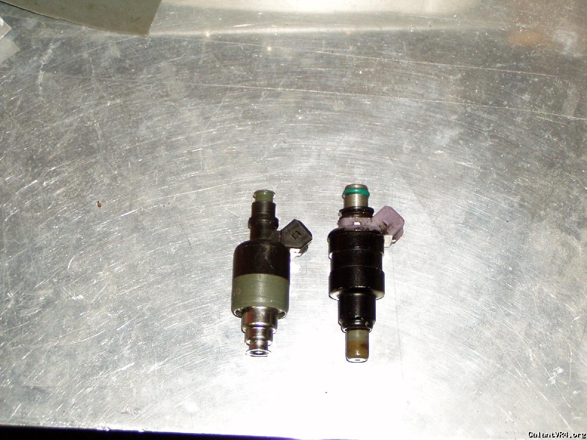

Sorry took so long, but here's a pic I took of the Denso and FIC side by side and while the angle isn;t the best, you can better see the difference in the way they sit, fwiw:

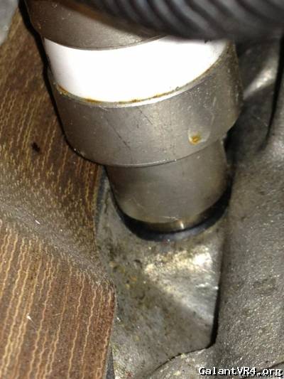

They are PTE 1200cc, but the guy that tuned my car..iirc, said they almost behaved like the FIC 1050 or 1100. I have to look back to see if I have it on my email but it might of been verbal.
Looks to be seated ok, but I have not seen any pics on the net to compare it to. I've done multiple blt and found none including the IM and the injector seal. If anyone out there can take a pic of their setup, PTE or not...It would be greatly appreciated.

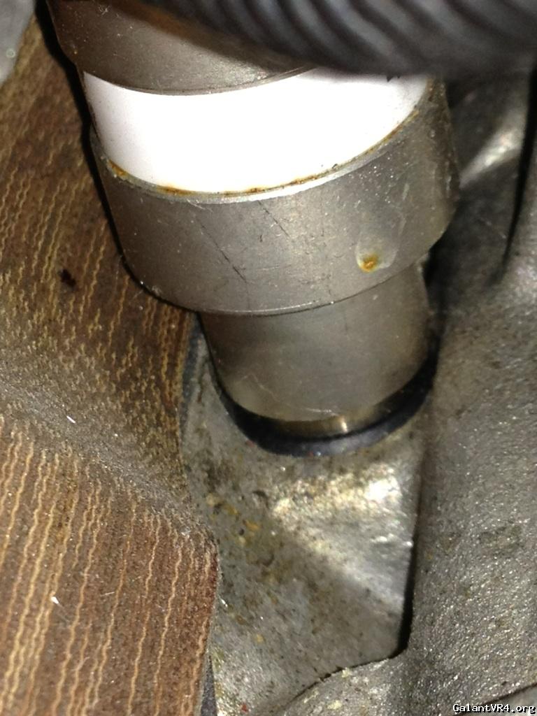

JNR- Post pics of what you did for for future reference. And heres a close up pic of the injector again...
In the first pic, the light hit it just so, it almost looked like metal on metal...
They should be good to go. As already suggested, a boost leak test will let you know if they are sealed or not.
