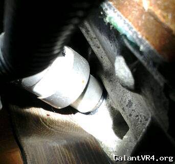

I tend to over analize things and this is one of them...As MOD approaches, I'm constantly going over the car to make sure it wont leave me and my son stranded on the side of the road. Can someone tell me if the injector gap normal? Should there evEn be a gap. My car was tuned last year by a local shop and I noticed that my a/f would jump between 14.3-15.1 @ idle. I always thought it was fine because the tuner didn't mention anything. The car runs great but I noticed that with my 680 pte's, my a/f would hold between 14.6-14.8 on a SAFC. But I did change the IM to a FRH and my injectors right now are pte's 1200 and Link V3.

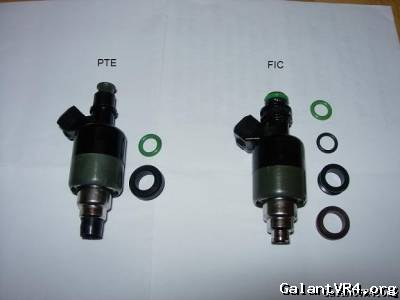

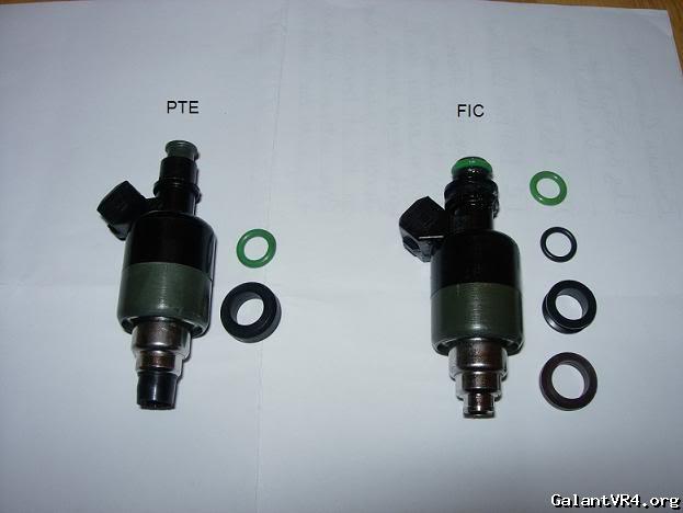

Is that an FIC injector? From my findings (went from Denso to FIC then back to Denso), the FIC's are shorter than the Densos by ~1/32" (don't quote me on that #; I have exact # on my notes at home though), from top to where it seats and in order to have them seat the same and do things right, I shaved off that same amount (~1/32") from the isolators, so that the injectors seat the same as oem, or densos. Nobody else really mentions this on here and don't think anybody else has really checked, but this was the difference between the two (denso 550 and FIC 650) and so I compensated, as required. I personally feel this is why so many people have issues with FIC's and don't understand why (provided the tune is adjusted).

in absolute terms you can test the seal with a boost leak test. Not sure about JNR's point on the injector outlet distance relative to IM, it's a variable but I can't help but wonder how much it matters with the pressures/airflows. I'd be more suspect of specific injector deadtime causing issues

^^^Yeah, only reason I brought this up is the FIC didn't seat down as far into the head (injector) opening as the denso, since the fuel rail is static height (using oem isolators, which place the distance of the rail) and with the bottom of the FIC injector being ~1/32" less into the head opening (vs. the Denso which is oem), it seemed to me that it did not seal quite as well...I mean, the fuel didn't come out or anything, but remember the spray also is facing down and more distance down from the o-ring, so it's possible there could be a slight air leak just enough to throw off AF/R. Maybe not, but IIRC the hole is also tapered slightly and I didn't want to take a chance and have the c.l. orf o-ring exaclty the same as oem; since the FIC's kind of sucked to begin with and I was having other issues, this was eliminating any possibility...Basically all I did by removing that amount from the isolators is have the FIC injector sit in the head opening the exact amount the denso did...I have notes and sketches in my file, if anybody wants exact info on this.

Actually, it's .052" not 1/32" (looked at my notes here)...I have a picture showing the two side by side if anybody was interested (on my portable hdd so I'll dig it out).

They are PTE 1200cc, but the guy that tuned my car..iirc, said they almost behaved like the FIC 1050 or 1100. I have to look back to see if I have it on my email but it might of been verbal.
Looks to be seated ok, but I have not seen any pics on the net to compare it to. I've done multiple blt and found none including the IM and the injector seal. If anyone out there can take a pic of their setup, PTE or not...It would be greatly appreciated.

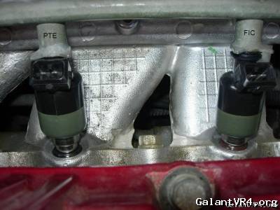

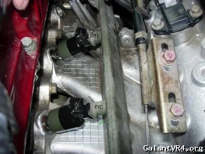

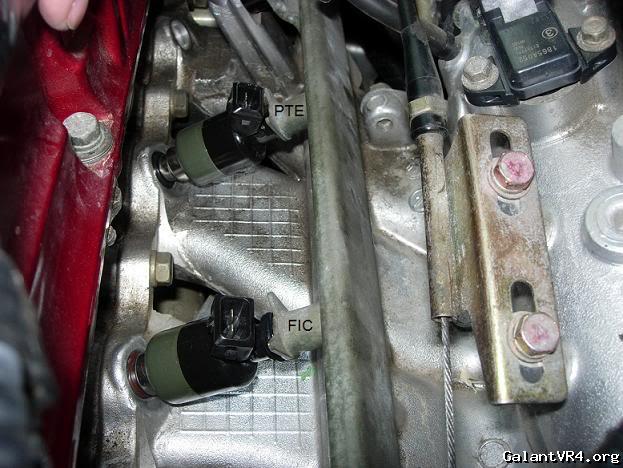

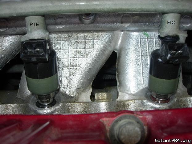

Took me awhile, but finally found a thread. Not a GVR4, but gives me a little more assurance to look into it more deeply. The PTE install is for an EVO.
* I got this from another forum, hopefully I'm not breaking any forum rules. If so, I apologize ahead and mods please feel free to delete the pictures.
Both injectors are PTE. The one on the left has the seals and insulator that it comes with and the one on the right is with the FIC seal kit.
DynastyLCD- Can you double check your injectors to see if you have the same issue.
Mikus- Looks like I'm going to have to do another blt...thanks!
JNR- Thanks for your input.

mine look identical to yours installed, except my injectors are black, not silver. looks like you're good to go!
if you are nervous, boost leak test it, you'll have a definitive answer if it seals or not.
