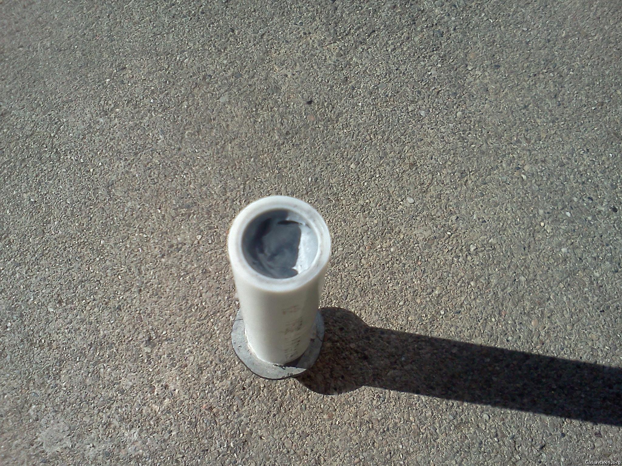

So I went to lowes and found this pvc pipe fits nice and tight around the seal might cut it down 4in and fill it with silicon just enough for the seal not to get stuck.

Well heres the tool I ended up making works great compared to the socket fits nice and snug and the inside top has grey rtv to provide cushing when tapping in the seal. Cost to make this was $2.00 5ft pvc pipe(only size they had) $3.00 for Grey rtv and some bolt I had laying around total cost of little over $5 and plenty of rtv left over. Hope this helps give some ideas for those looking to replace there seals and rather use something different than a socket.
