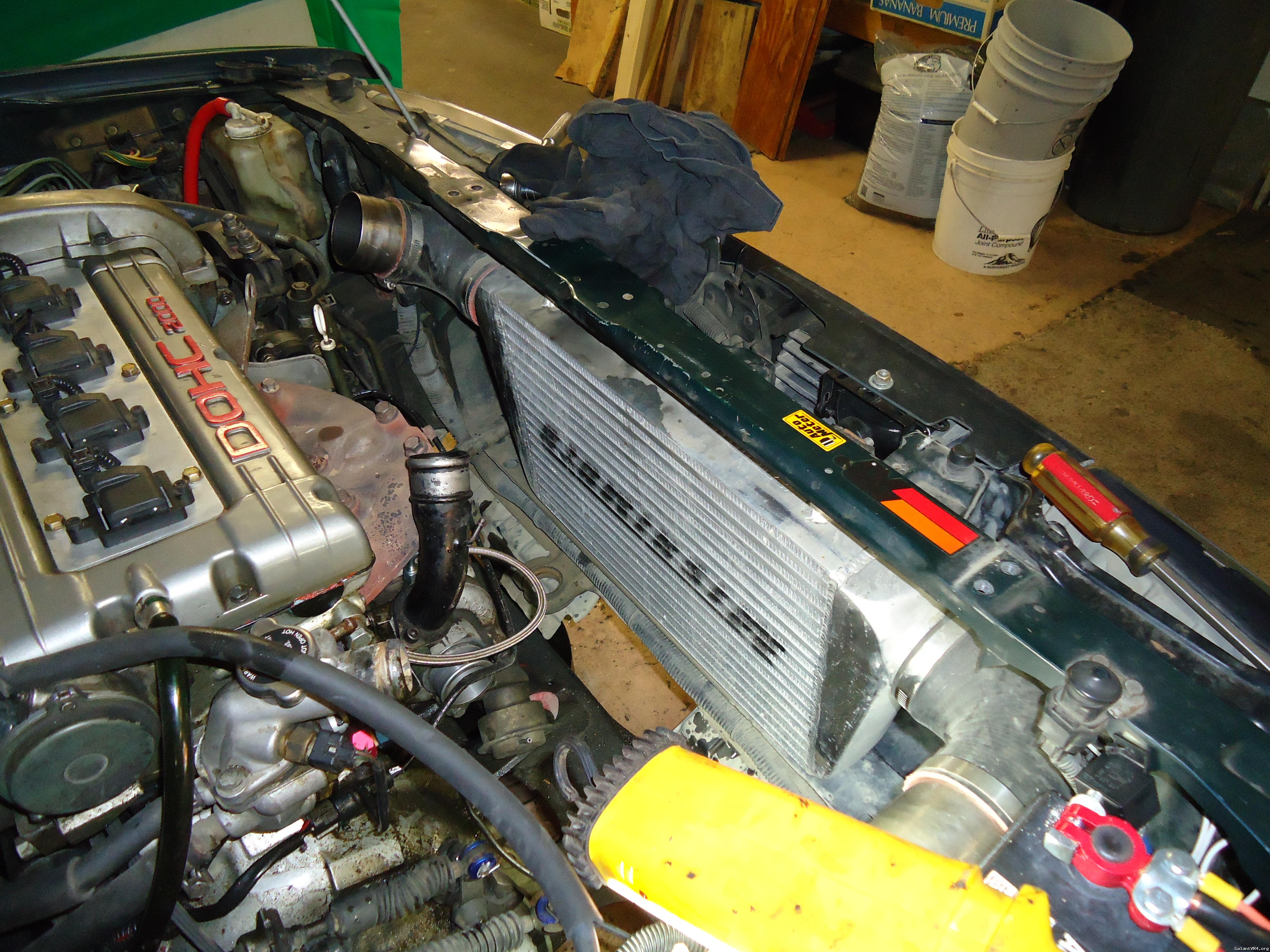

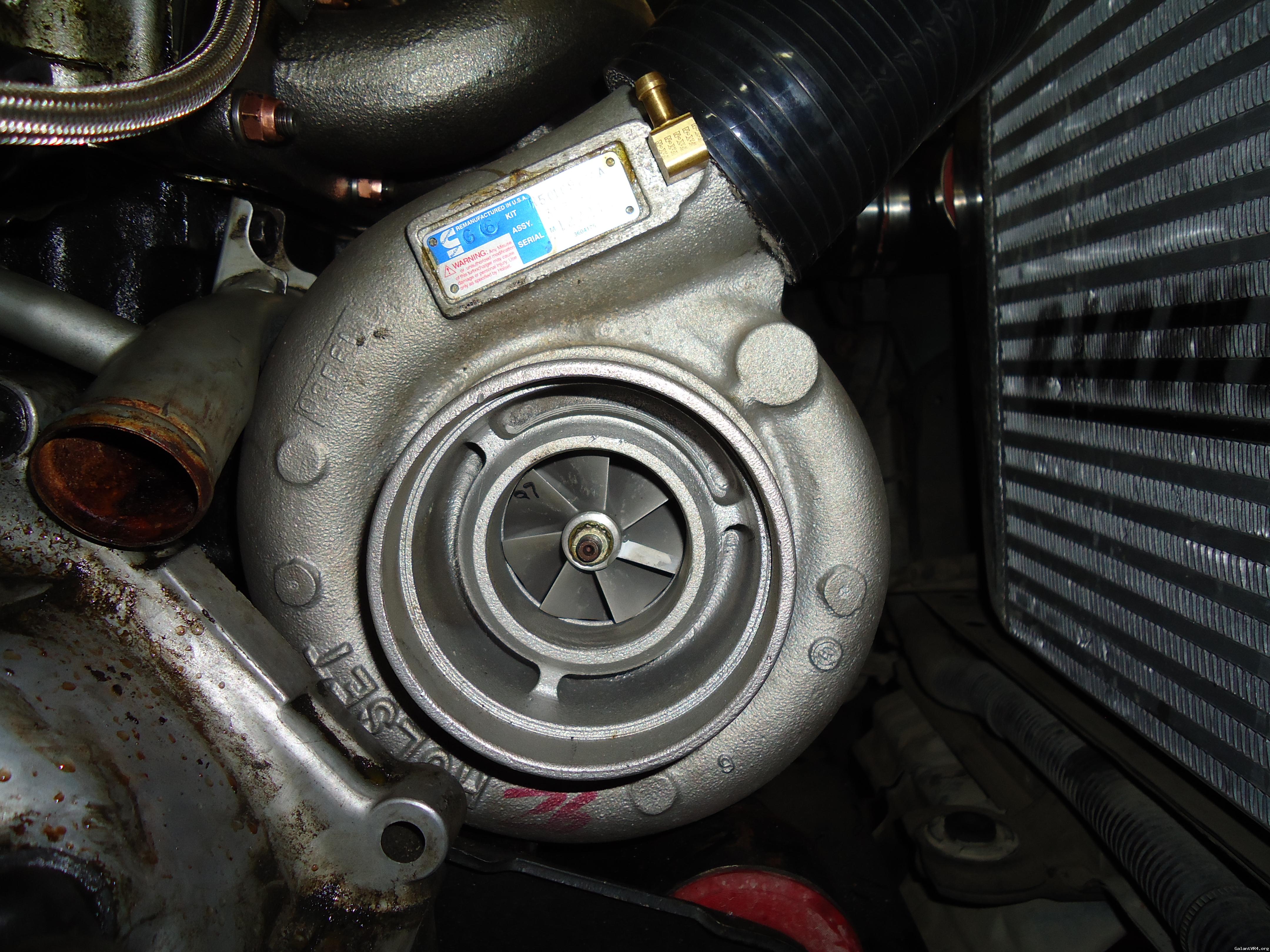

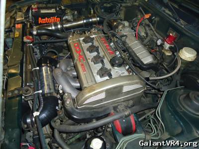

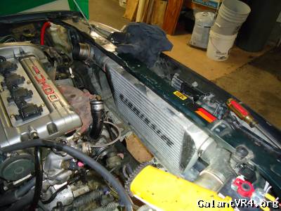

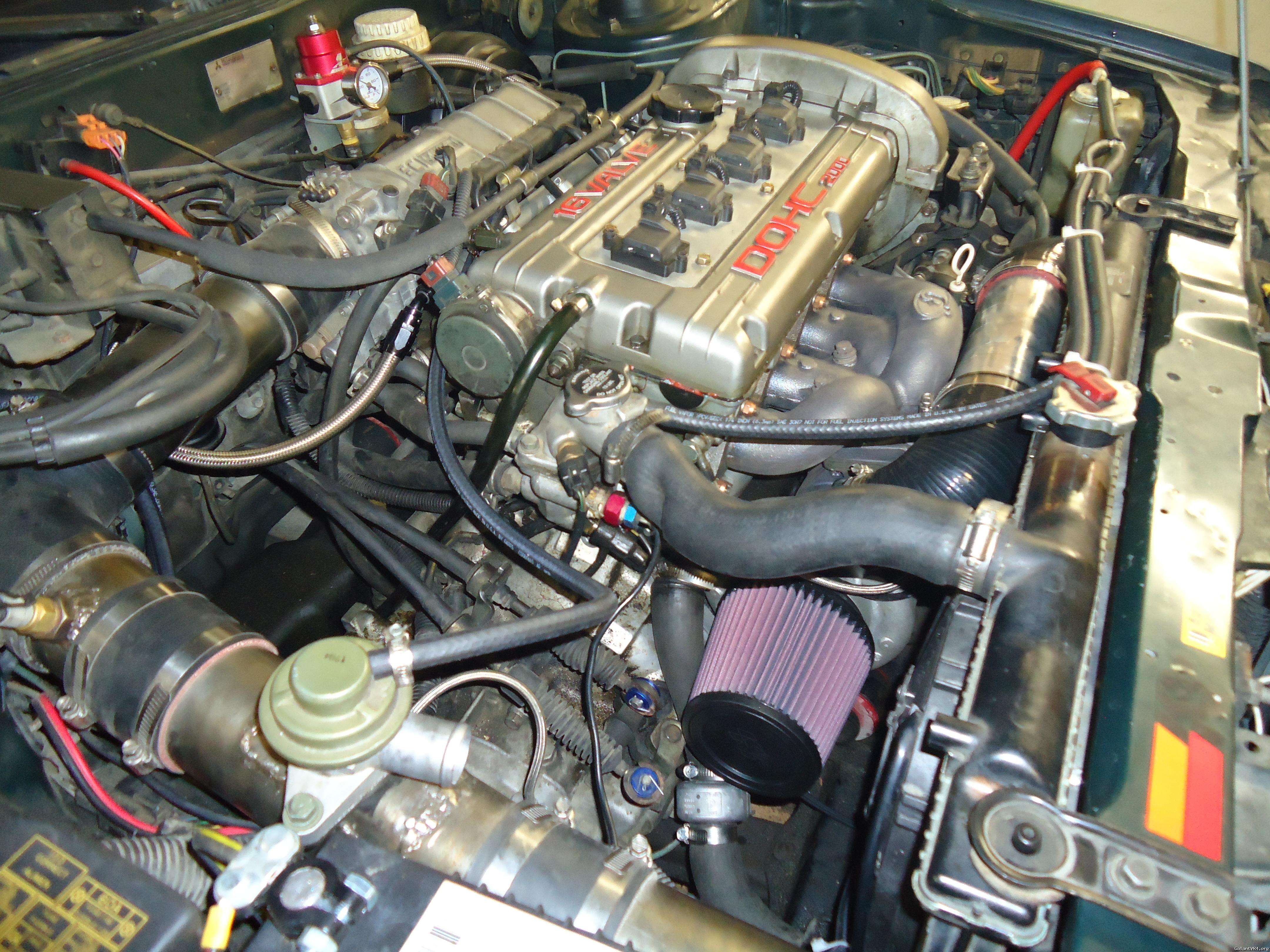

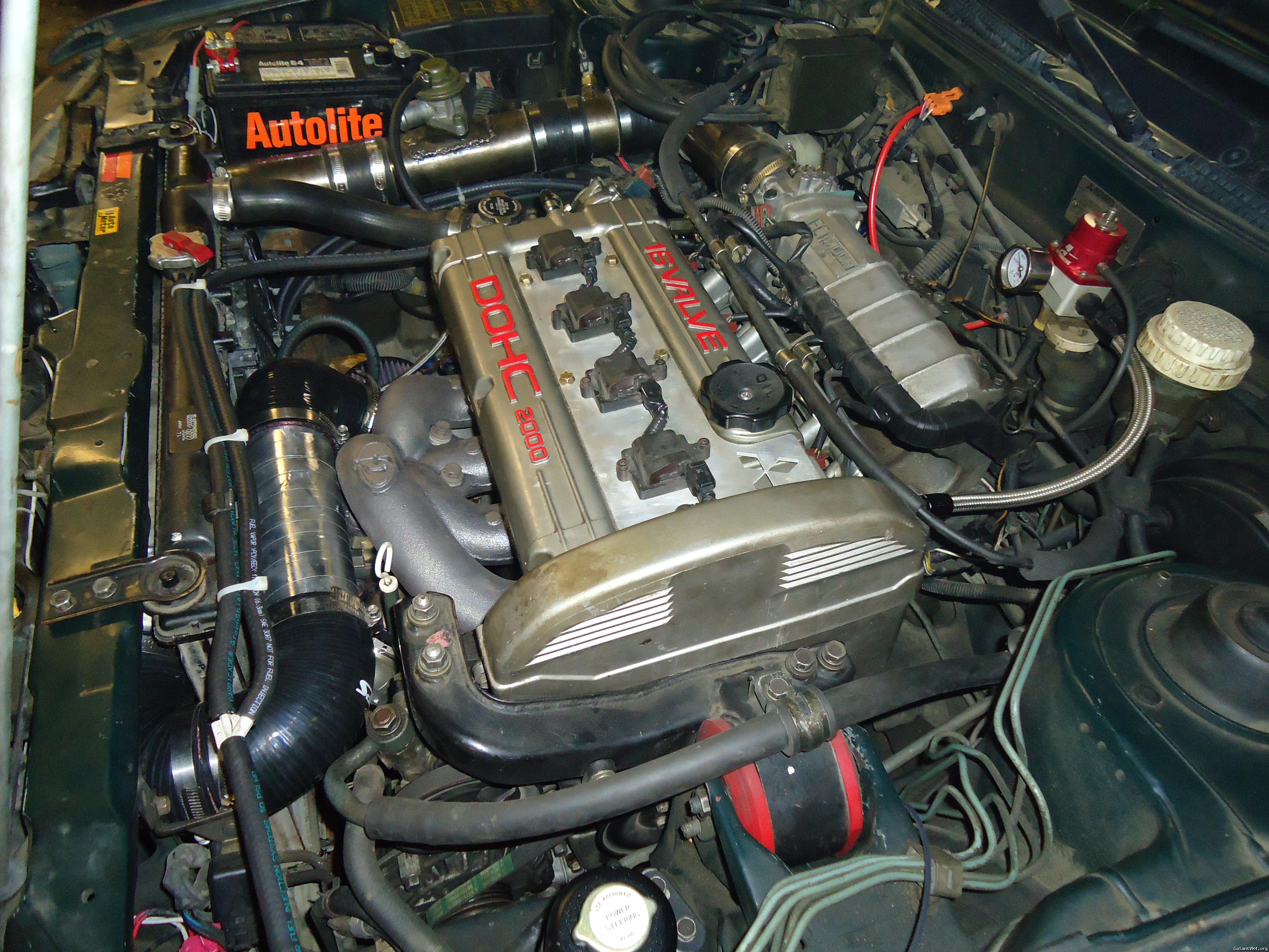

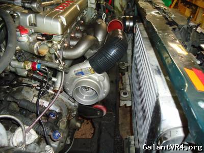

Well after about a year of doing research and gathering parts I finally got around to Installing the entire setup and I must say it did not disappoint, I even managed to keep the factory radiator! And now pictures for your viewing pleasure. /ubbthreads/images/graemlins/grin.gif

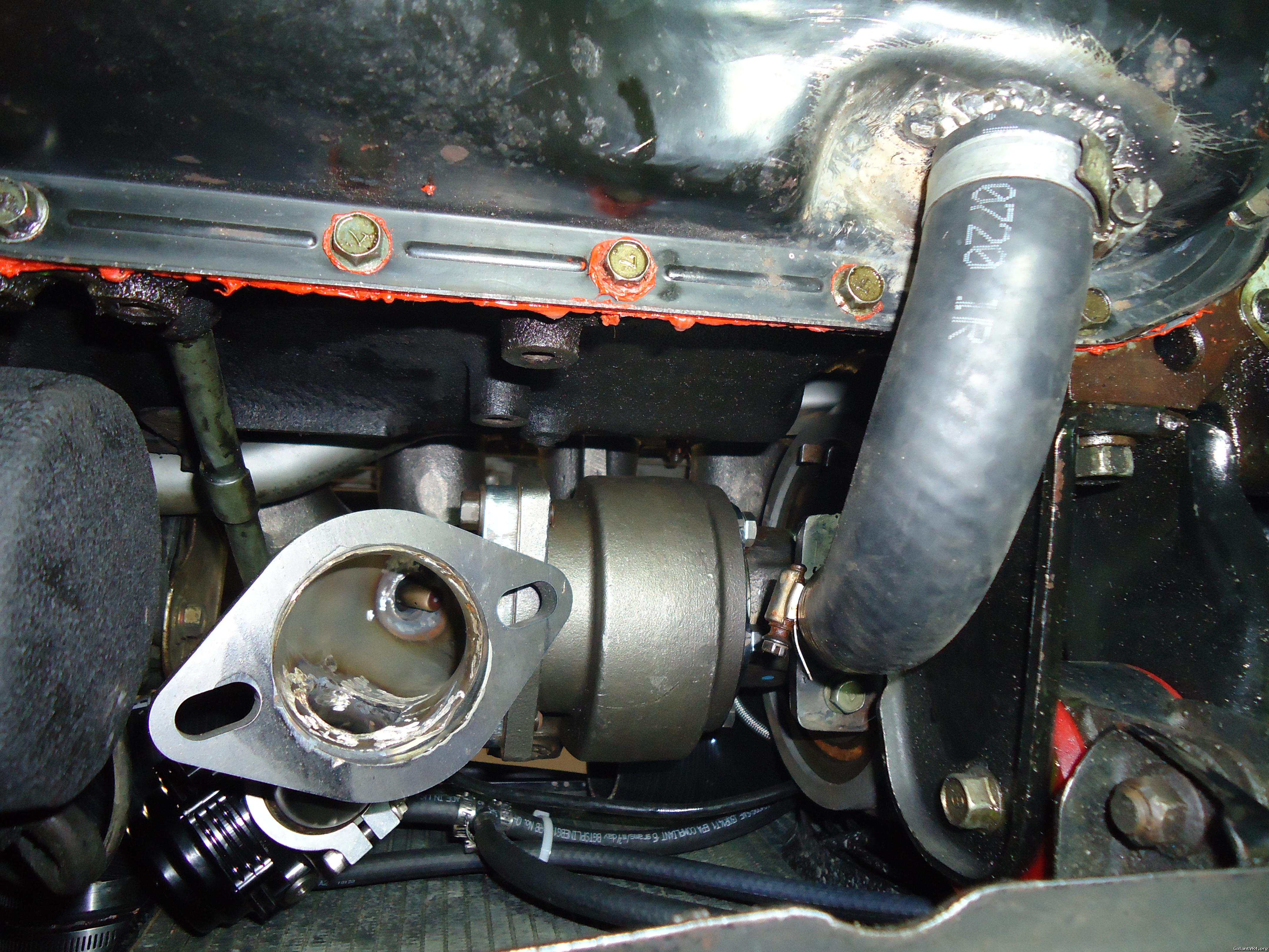

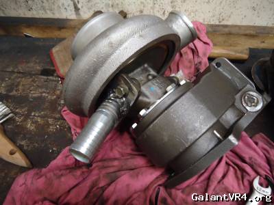

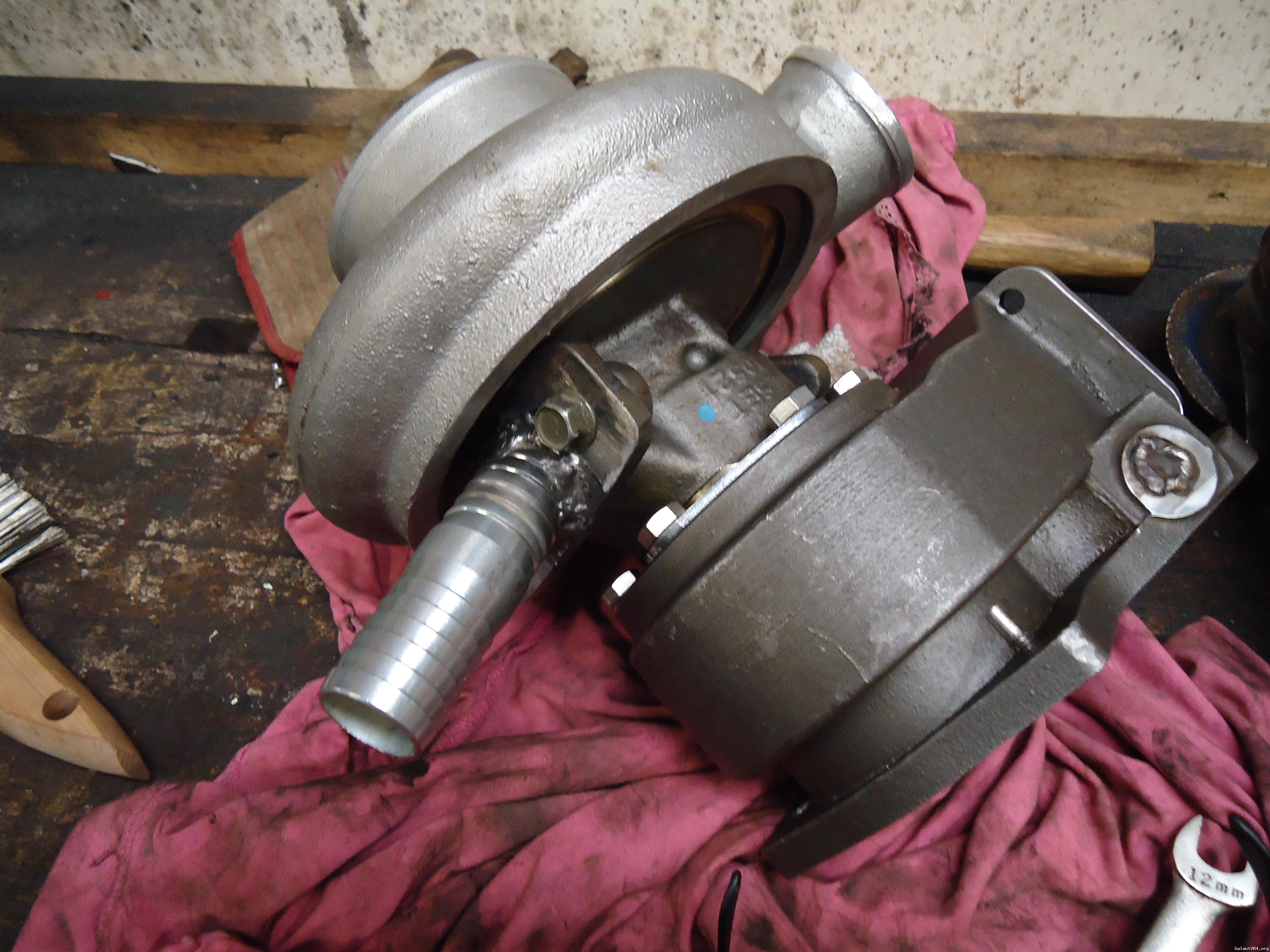

Well the drain did fit without shaving, but it was a pretty tight fit so I shaved maybe 1/16th of an inch just to be safe. I also didn't use the typical oil drain.

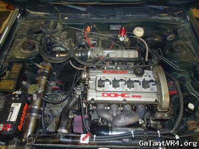

Make sure that oil drain is no smaller than 19mm. Are you running a restrictor for the feed off the ofh? These turbos are very picky with oil feed/return. Be sure to make a nice 4" intake with quality filter. The setup u have now is going to draw heat from the radiator.

Thanks guys. I'm not worried about the oil drain I have a 7/8 fitting going to a 1" hose. Oil is feeding from the head and the oil pressure is within spec according to Holset, I hooked up a guage to the turbo and checked. And as far as the intake goes, My intake temps aren't to bad at all, with it being winter in Alaska my intake temps are 35F. I plan on making a intake in the future but that will require some moving of other parts and what not, so for now this will work just fine.

It helps the turbo make more power with some sort of intake. The only thing worse than that is just an air filter on the housing followed by chicken wire over the inlet.

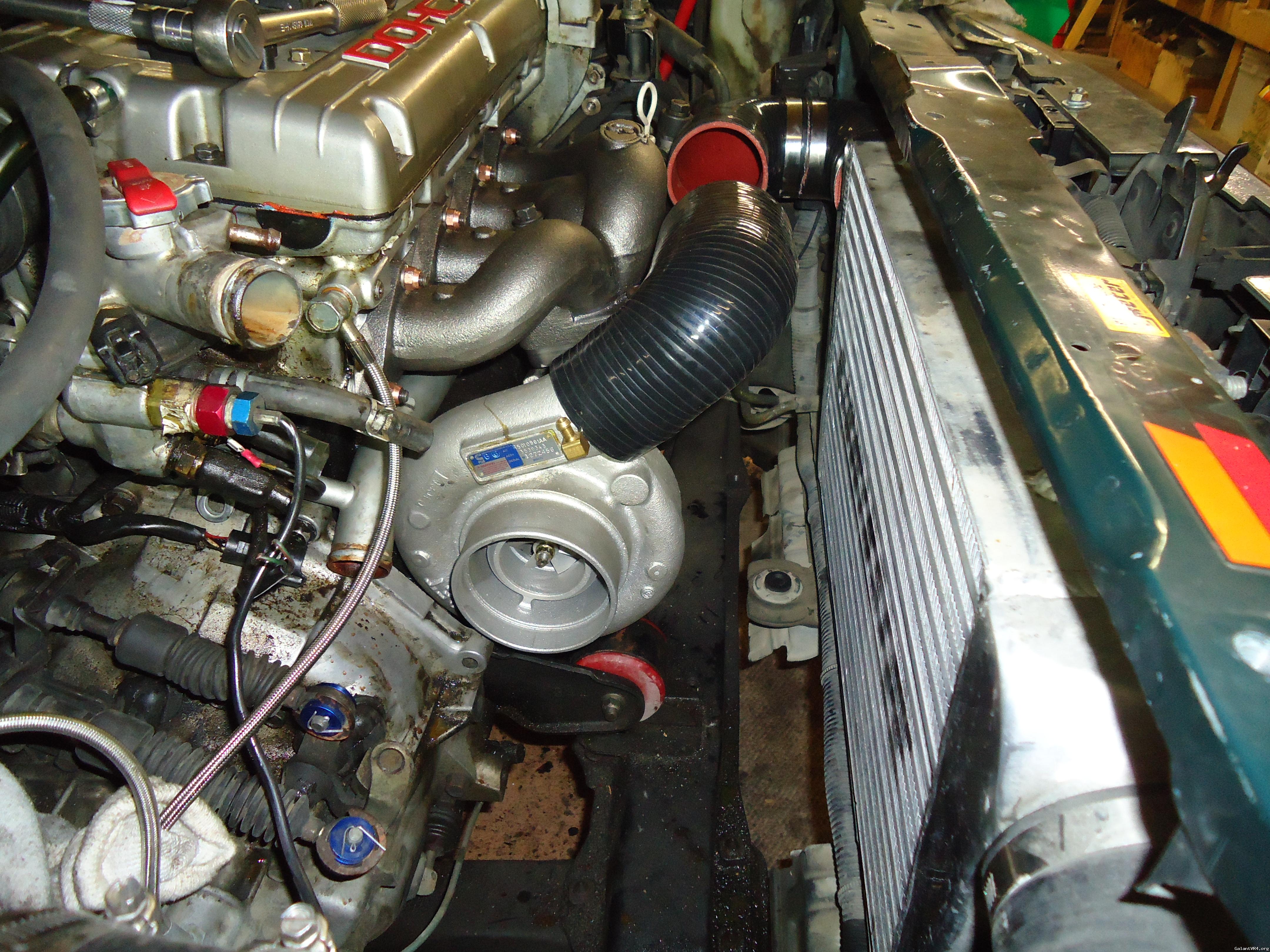

Set up looks awesome! I have a holset and a bunch of parts laying around waiting for go on the Galant. I really like how you ran your intercooler pipe out of the turbo, but personally I think it is too close to the exhaust manifold and being aluminum it is going to heat up and retain heat for a very long period of time. Have you thought about maybe using exhaust wrap around it, Might help more than the tape you are using on it.
I just have a few questions/comments.
- What radiator did you end up using?
- How big is your intercooler pipe coming out of the turbo?
- Also I think running some sort of intake on the turbo helps make more power from what I have read in the past, because I think the air is able to build more velocity before the turbo and it also wont be the same air that just passed through your hot radiator.
- And feeding from the head is the best place, I have been running and HX35 on my talon for 3+ years now daily driving it at 30psi and the turbo is bullet proof!
- I also like how you mounted the intercooler!
Good luck with the car man!

Thanks for the feedback. And to answer your questions, the pipe isn't actually aluminum. It's just plan old steel pipe, which I know isn't ideal by any means but its what I had to work with at the time. I was thinking about using exhaust wrap (I still might) but for the time being the tape is better than nothing. The radiator is actually the factory unit, it was quite a tight fit as you can see, but I did manage to fit it in there. The intercooler piping is 3" from the turbo to the throttle body, I know its a little overkill but it works. There are still lots of little refinements I am going to make over time, (the lack of intake for starters) but for now I'm happy with it, and it has more than enough power to put a grin on my face. /ubbthreads/images/graemlins/grin.gif

Yea I was going to say the pipe looked like 3" but I wasnt sure. I was planning to squeeze my intercooler pipe running underneath similar to how they run on DSMs. Just not sure if it will all squeeze in there. I do like that you where able to squeeze it in there with the stock radiator, because I really did not want to have to fabricate a honda radiator to fit. Maybe I will try to run my intercooler pipe in a similar fashion as yours. I am surprised you where able to get such good clearance between the waterpipe and the turbo with the turbo clocked in that position!
The thermal tape is better than nothing and I think it looks worlds better than the thermal exhaust wrap (it looks like you really took your time with it and really wrapped the pipe nicely), but I think the exhaust wrap works really good at blocking heat. downside is it is a bit ugly when compared to the thermal tape.

Hmm... I might just have to throw some exhaust wrap on that pipe and see if it makes any difference on intake temps. Oh and I didn't actually have to dent the water pipe as much as I thought I would have, just had to use a n/t water pipe. The fitting on the bottom of the turbo pipe makes it so you can't get the clearance you need with the turbo clocked in this position.
