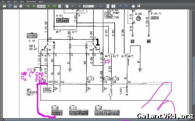

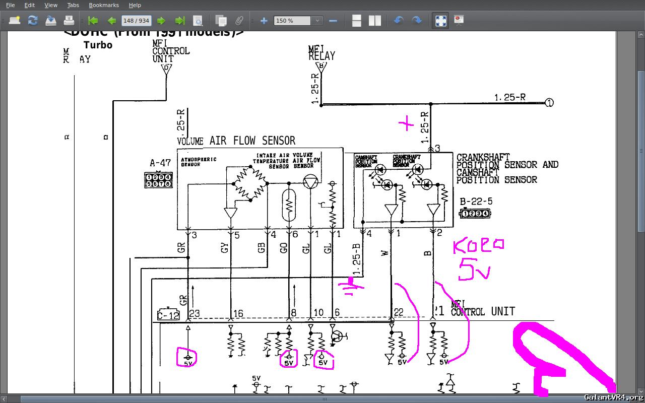

Injectors are a ground side switched circuit controlled by ECU. MFI relay supplies +. We need to figure out why the ECU isn't grounding the injectors.

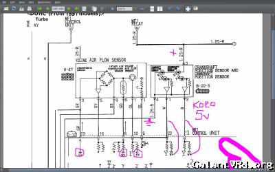

Your specific Crank Angle Sensor has to function @ least intermittently if you have spark. A good one rotating should have 5v pulse from the signal wires. I would look harder at this before condemning other parts.

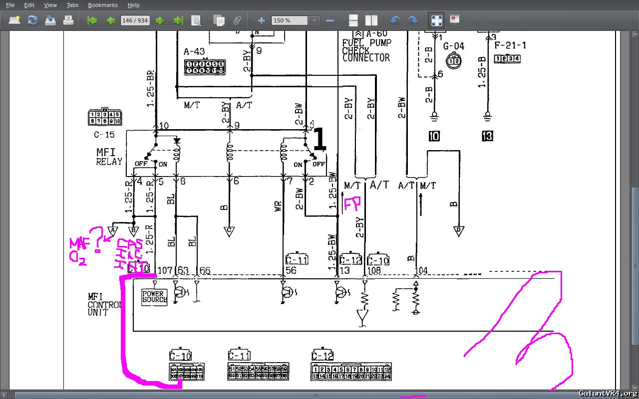

I'll check that diagram today. I haven't read .org in a while and am glad this place is still cool, very helpful tech info supplied on a picture with a dick drawn on it.

ECU wire 107 does back trace to the MAF sensor. I'm going to assume that isn't the problem, I'll try spinning the CAS by hand next.

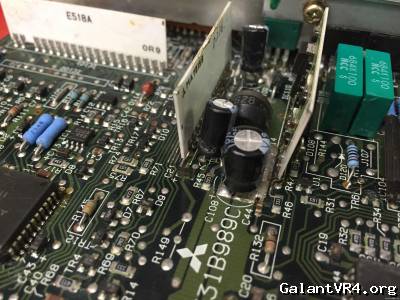

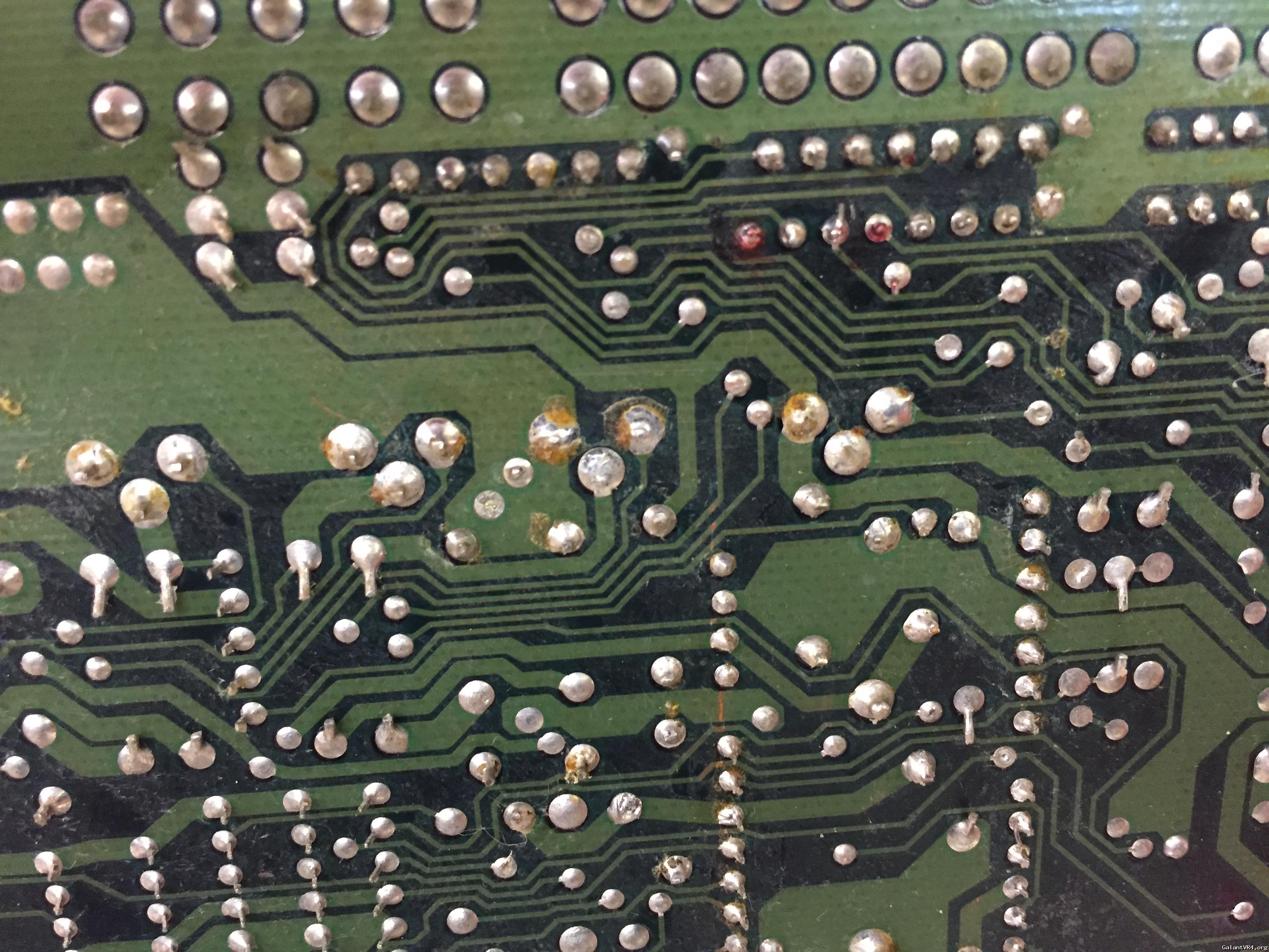

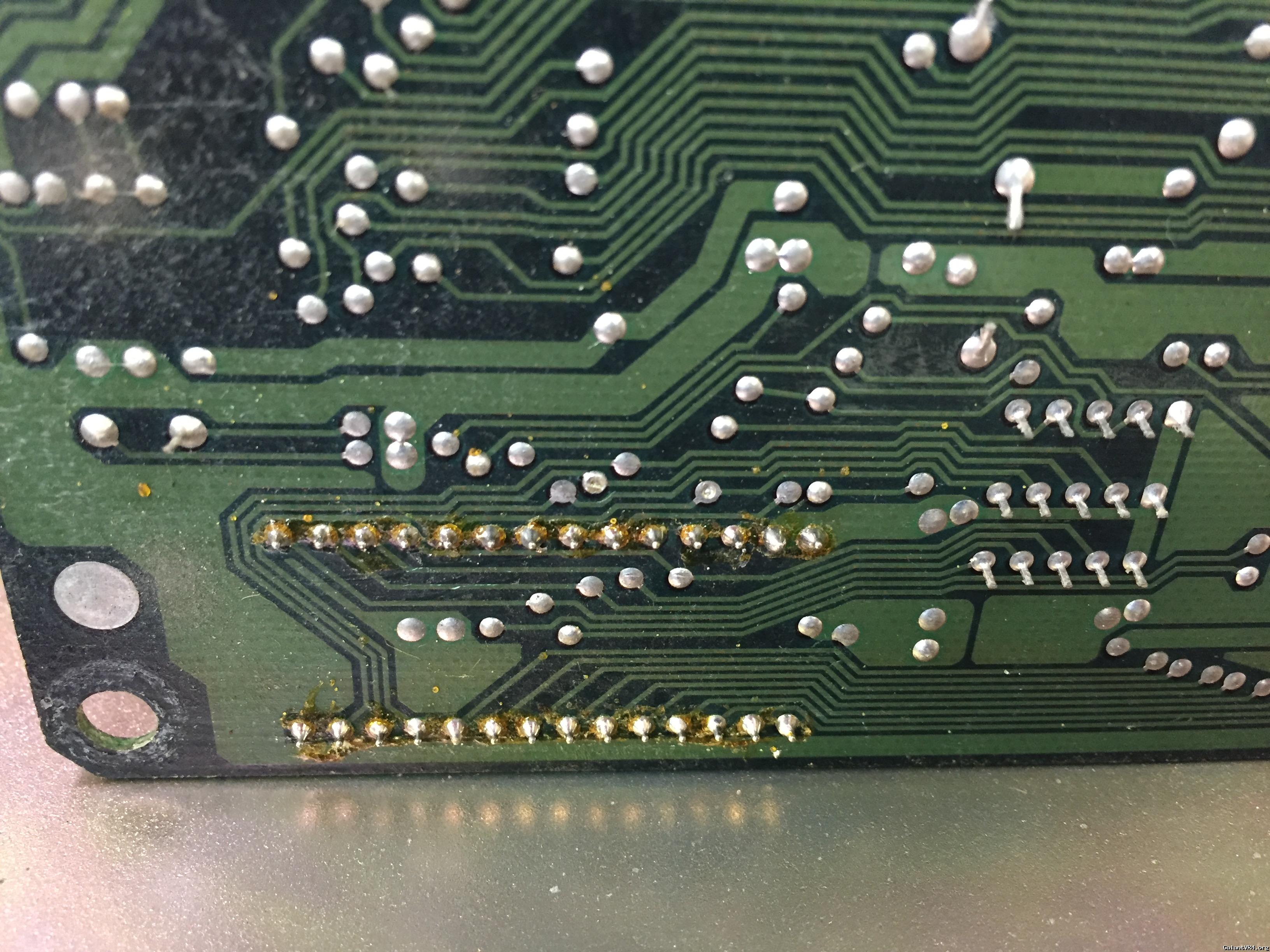

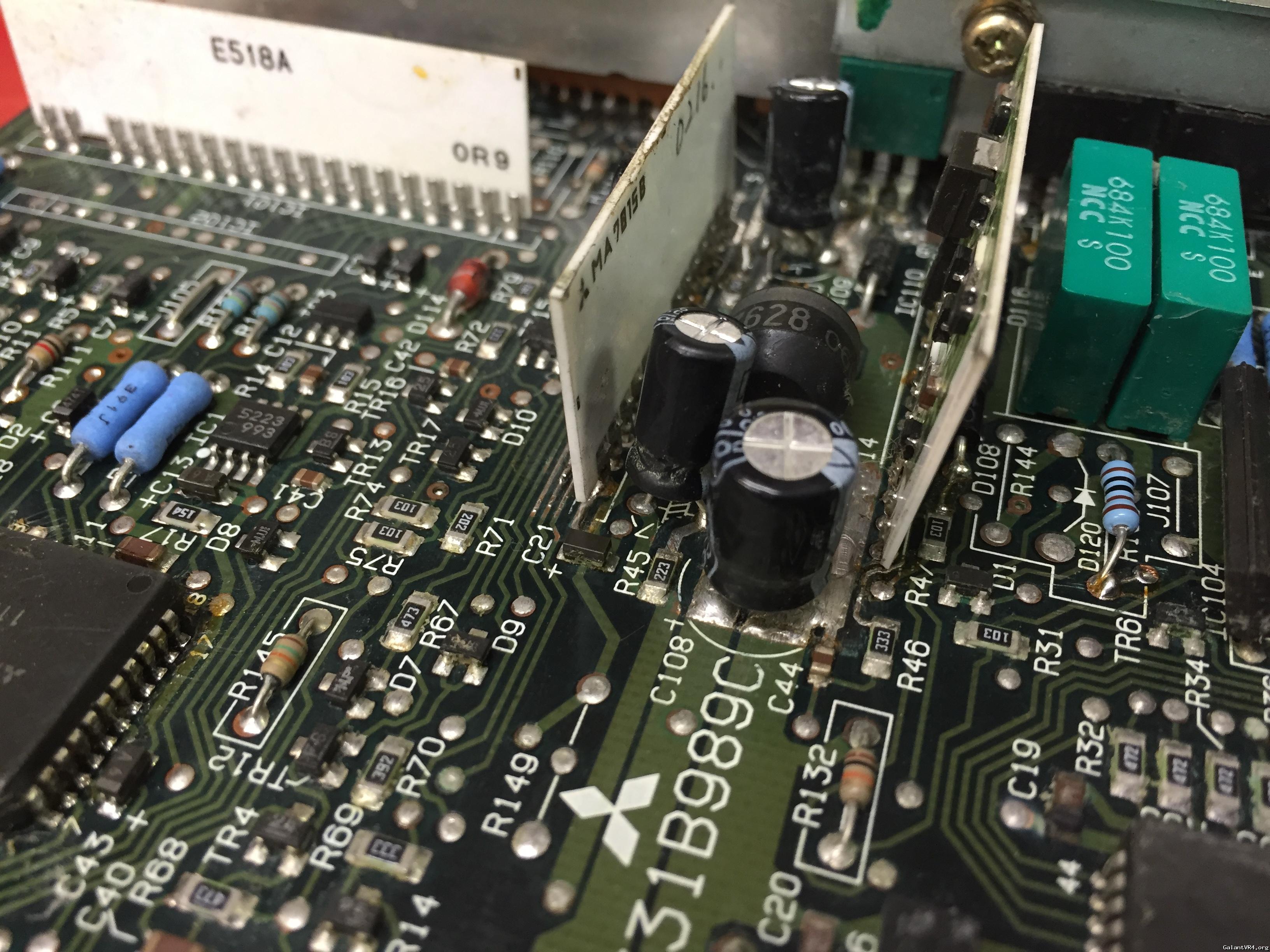

Maybe the ECU is sh*t? There's slight corrosion behind the eprom chip on the board. The capacitors seem to be in good shape with no acid leaks but I'm not so sure about the rest.

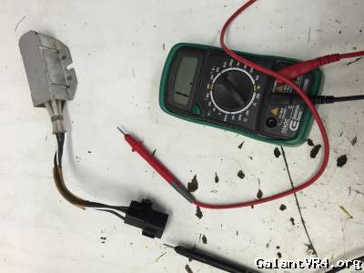

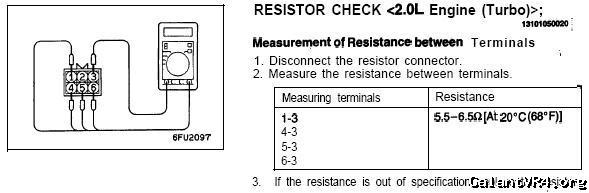

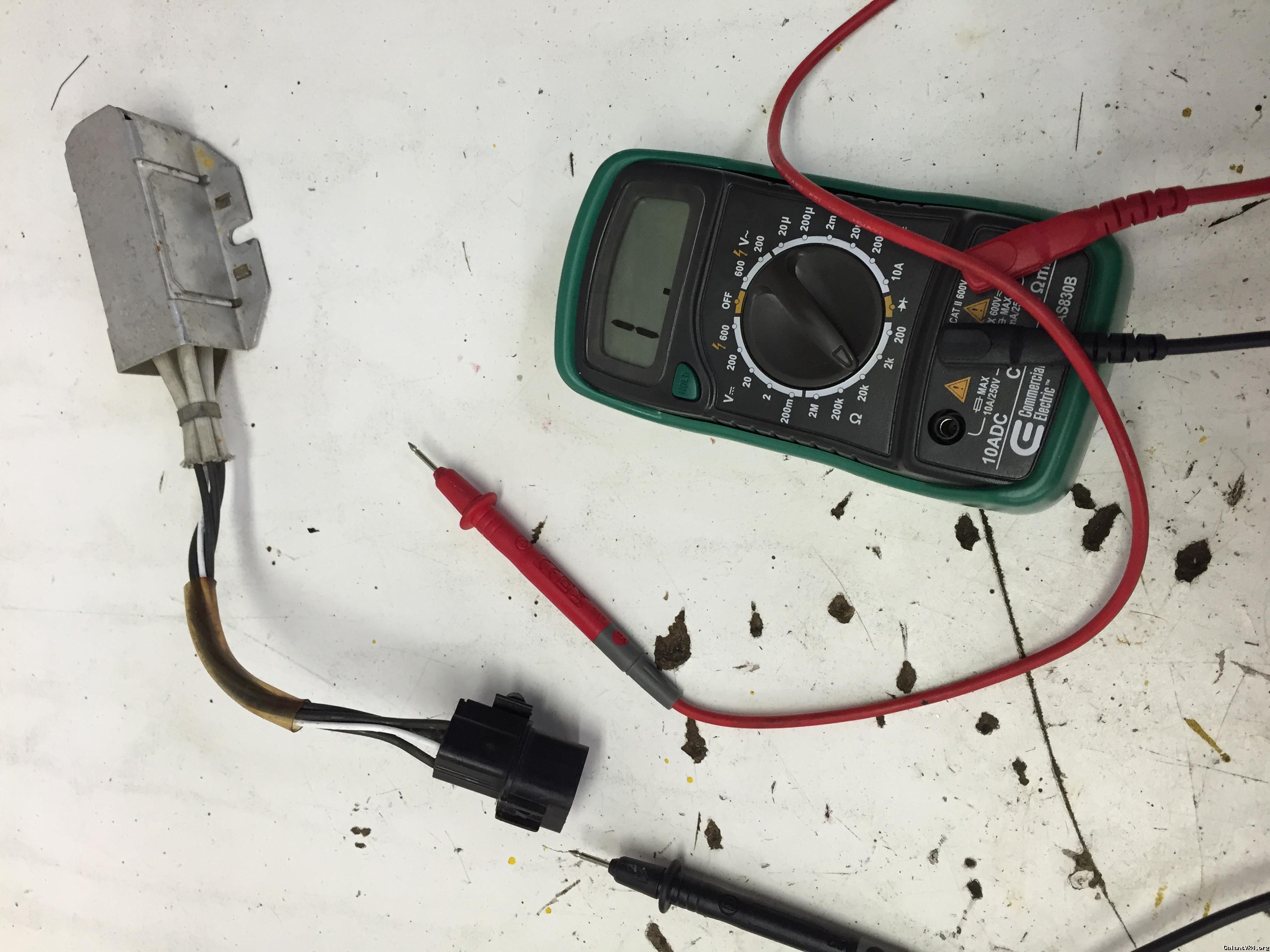

When spinning the CAS manually I have no 5v signal at the ECU plug on either pin 21 or 22 with the key on, I can't hear any injectors clicking either. I also checked resistance on the injector resistor pack (I think I had the right ohmmeter settings) and everything measured zero to pin 3. I presume that means it is bad as it has no resistance.

Have you checked the ECU for diagnostic codes? Sometimes it will show a ECU fault code. Seeing as how you monkeyed with the MFI relay there should be several stored codes @ least. If you have 12v at ECU, 5v signal from CAS @ the ECU, you COULD shotgun a ECU @ it. Do you get the "check engine light" when you turn the key on, then it goes out after a few seconds?
Edit: You little boogerbutt. Posted while I was curating a post.
If you have 12v coming into the CAS you NEED to see that 5v signal coming from the ECU. If you check the ground circuit integrity @ pin 4 and it's good. And pin 1 and 2 have 5v to the ECU. You can throw a CAS @ it. I am going to check my car right now to be certain what I am telling you about the 5v signal is accurate. EDIT:[CAS signal output to the ECU, you can't read it without a high-end multimeter or oscilloscope.]
If somehow your resistor pack went bad you can measure the impedance of your injectors to make sure they didn't take a hit. Also you need the smallest Ohm scale to measure the resistor pack. You are measuring single Ohms here.

Signal wires pin 1 and 2 @ CAS should have 5v reference from ECU at KOEO. Do you have that?
If not then you have a problem with your ECU. You can check other pins @ the ECU that should have 5v to see if it's a localized problem or the whole 5v rail.

The MFI relay supplies the 12v rail at the ECU, which means no 5v either. So maybe you are onto something with your power supply issue. Come back to it with fresh eyes and maybe you will catch something you missed.

OldHairyBastard
Apr 27, 2005
4,510
Northern Chicagoland Area
Look a little closer. It looks like you have two caps that blew. The one by the injector board and the smaller on at the top. Take a good look with a magnifying glass to see all around those areas.
