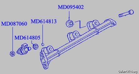

I wouldn't trust a non OEM part for something that crucial to my car not burning up. They are really cheap and I would suggest getting all three of the o-rings on each injector:
Top of fuel rail side: MD614813
Bottom of fuel rail side: MD614805
Bottom of injector/intake mani side: MD087060
Fuel rail mounting isolators: MD095402 (x3)
