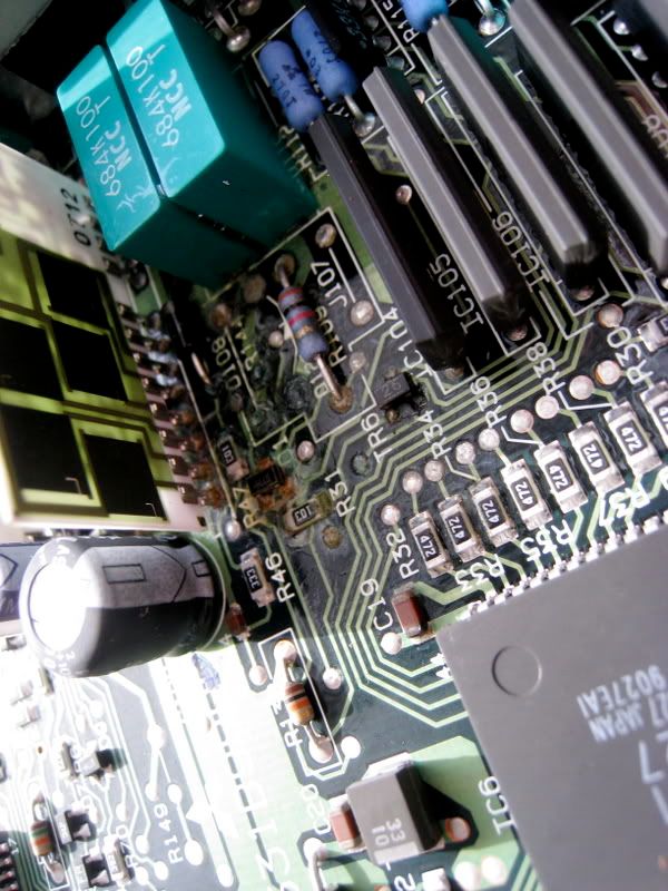

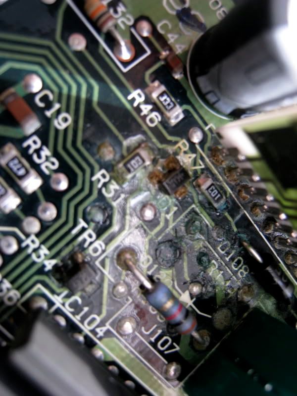

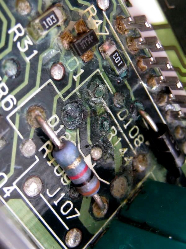

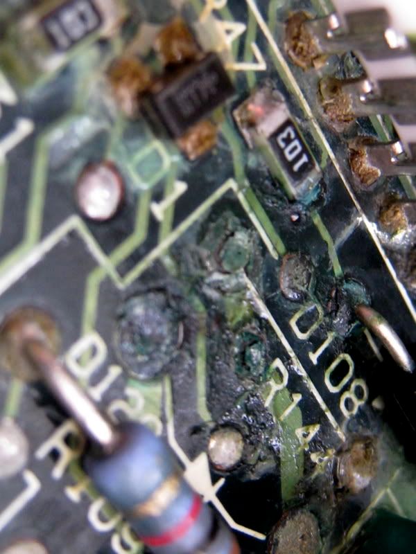

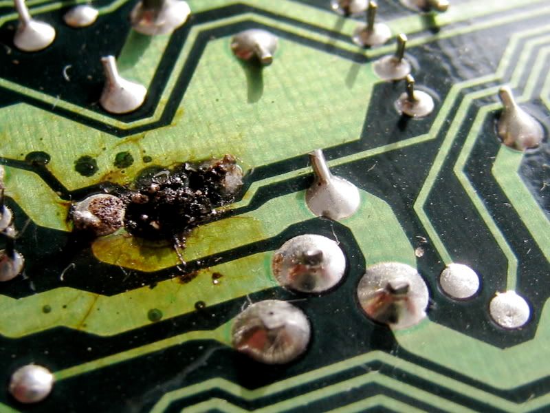

I posted a few weeks ago when I got 801 because it wasn't staying on. It would start up and run for a couple minutes, I could even drive it into my garage but then I would hear a click from the ecu and the fuel pump would cut out.. at least that's what I think.
Well, I finally got around to pulling the ecu out and this is what I found. I'm assuming it was the culprit. Now the question is, can I still salvage this? If not, what turbo ecu can be used to replace? I'm going to keep this guy stock so I don't care if it's eprom or not.. Thanks for the time guys.

Yea, that's what I looked into first. I bought it a month back and never got to wok on it til now. Is it salvageable?
I don't see anything wrong... just slap a little windex on it and hit it with a q-tip... /ubbthreads/images/graemlins/idea.gif
or... send it to terry and have it redone right.... your call

all 91-94 m/t turbo ecus will work fine
Not necessarily true. Some of the later 1993/94 ECU's had full EGR and emissions stuff going on, so its best to restrict yourself to 1991/92 Federal ECU's, unless its an EPROM and you plan to change the code.
2of9
Aug 29, 2007
869
IGH, MN
^^^x2. i'd say just get another 91-92 manual ecu. there should be a couple around. I know i've seen a couple locally. give that a try?
1990ggsxnj
Nov 21, 2008
525
Blackwood, NJ
I would just send it to Terry to get caps replaced and board cleaned up. That way you know it's done. (and done right I might add /ubbthreads/images/graemlins/wink.gif)
