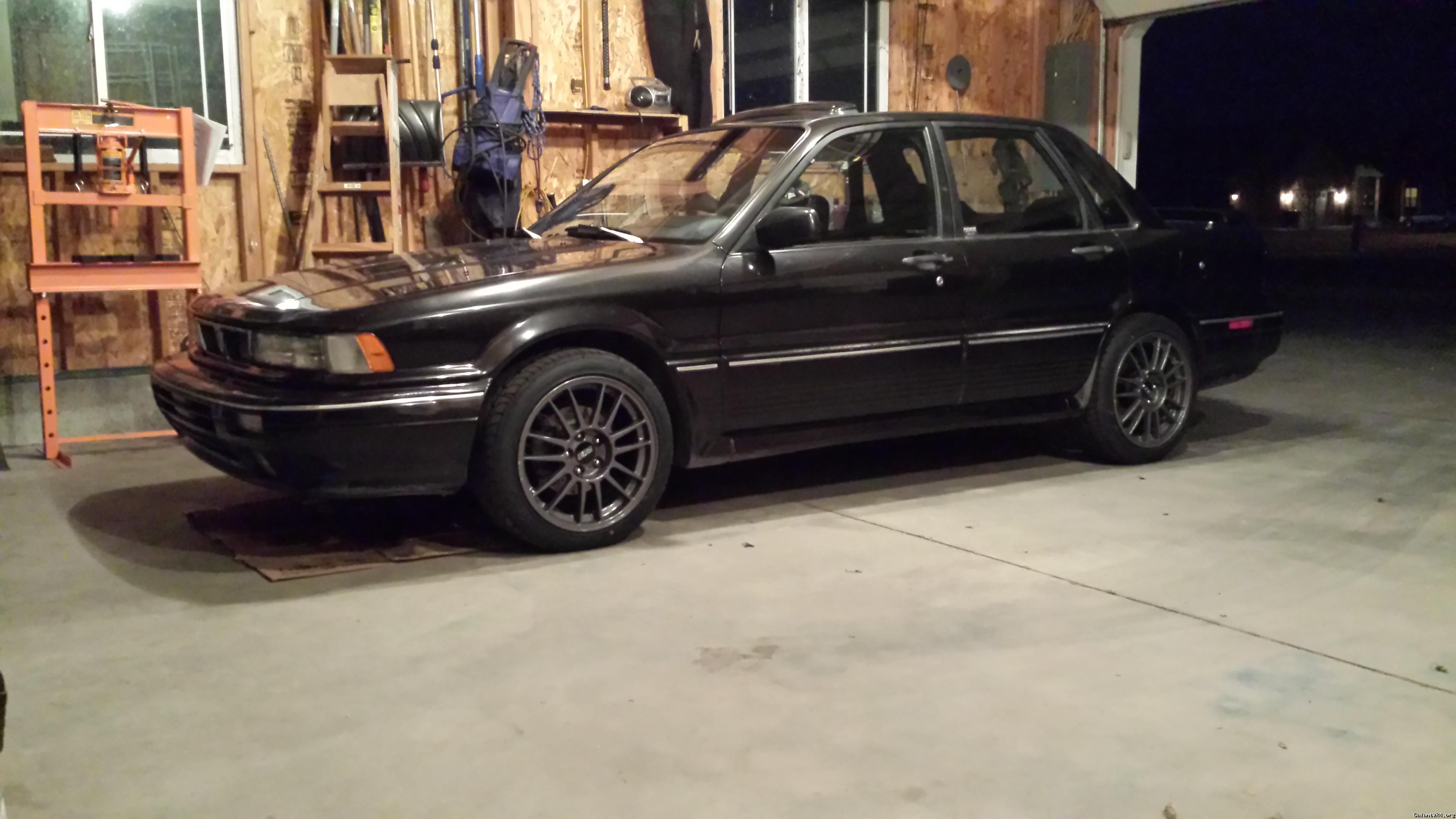

I recently purchased this 91 galant from a good friend of mine. First time owning a car like this, not the first time I've owned a 4g63 powered car however. A little info on my back round and previous cars I've owned. Always had a passion and love for cars and speed (who doesn't right?) I've owned multiple cars since I started driving at the old age of 16. My first turbo 4 banger was an Srt-4 I bought new in 2005, threw a stage 3 turbo and supporting mods on drove it for a year and decided I wanted an evo. Bought a new WW 06 evo ix, first time owning a 4g63 powered vehicle and I absolutely loved it, had the evo for just over a year and traded it in for another evo ix but in silver, threw a tune and exhaust on it and called it a day. I sold the evo in 2008 and haven't owned a Mitsubishi since. I'm a little rusty and continue to research and increase my knowledge ( a lot has changed in 8 years) on the 4g63 platform.
On to the current project
91 galant vr4 #383/2000
The car has a decent amount of upgrades, I plan on changing a few of them

*update*
Removed the fp cast exhaust manifold and 20g turbo. Installed new top mount manifold and 35r. Taking it to get custom fabricated intercooler piping and exhaust. Also swapped out evo ix wheels for some bbs mr wheels.
Should be ready to tune here in a month or so. I'll try to continue with updates and pics

Small update
Turbo, manifold and intercooler all mocked up. Getting the down pipe fabbed up. Ran into an issue with the waste gate placement, intercooler piping won't fit with where it currently sits. Sent the manifold back to jm fab for corrections. Also having issues with the JDM bumper fitting over the 3.5" ets intercooler. Haven't decided if I want to modify the intercooler or bumper to make it fit.
