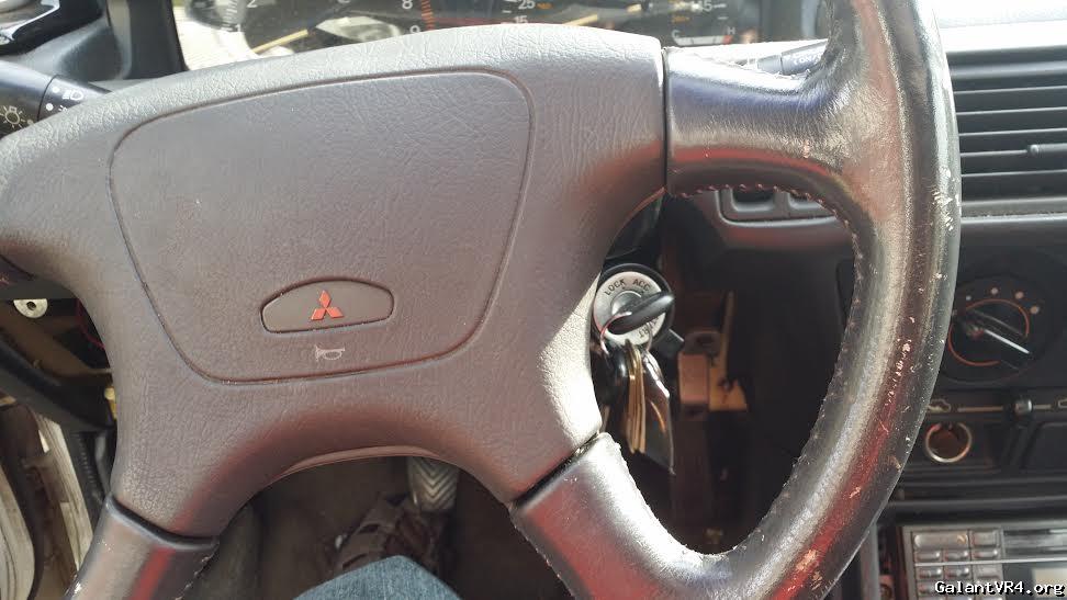

Every week I fire up #50 and drive her a short distance. The other day the electric company (ComEd) was trying to get in my yard to put up a new pole and hang new service lines, so I go out to move #50 out of the driveway so they can get in the yard. When I get in and turn the key, nothing, the key will not turn at all. Now mind you, I just started her up the other day and at least once a week prior with no issues at all. The key works perfectly in the doors but will not budge in the ignition switch. It's like I'm using the wrong key. I'm thinking the ign switch has gone bad considering its 23 yrs old. Has anyone else had this issue.

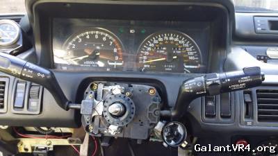

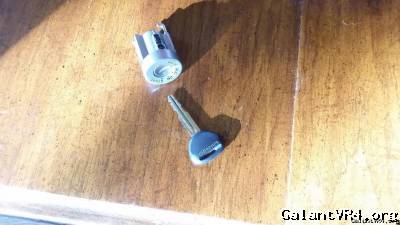

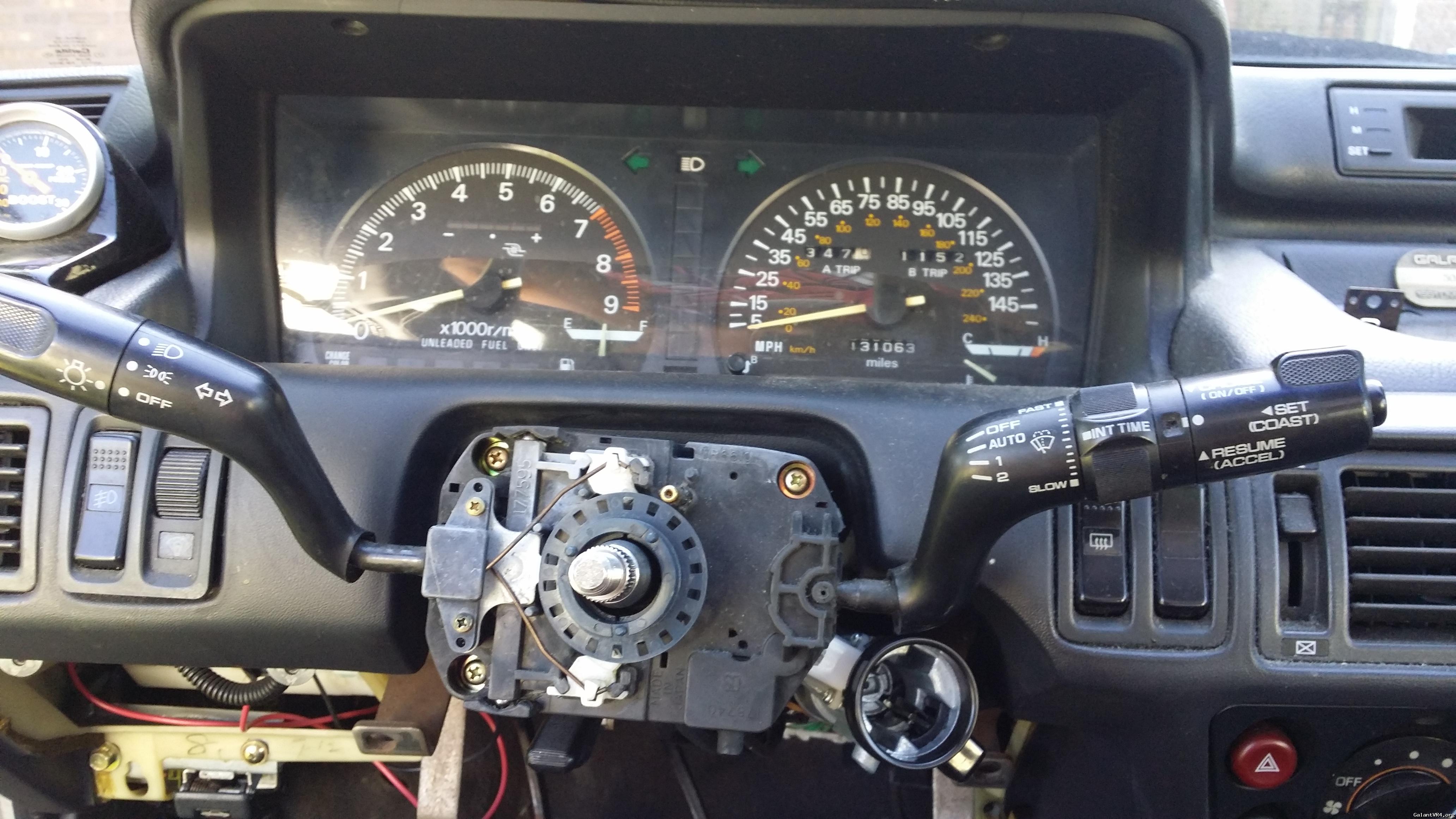

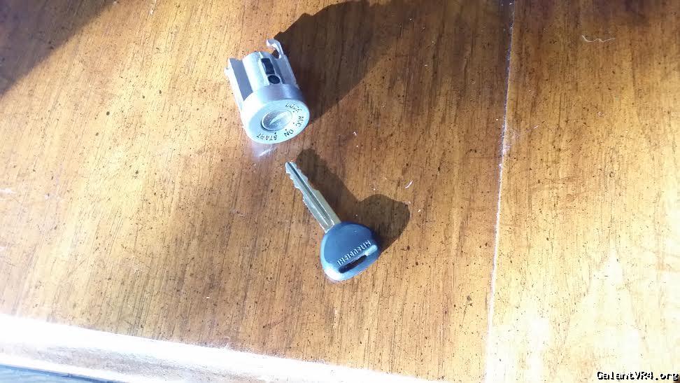

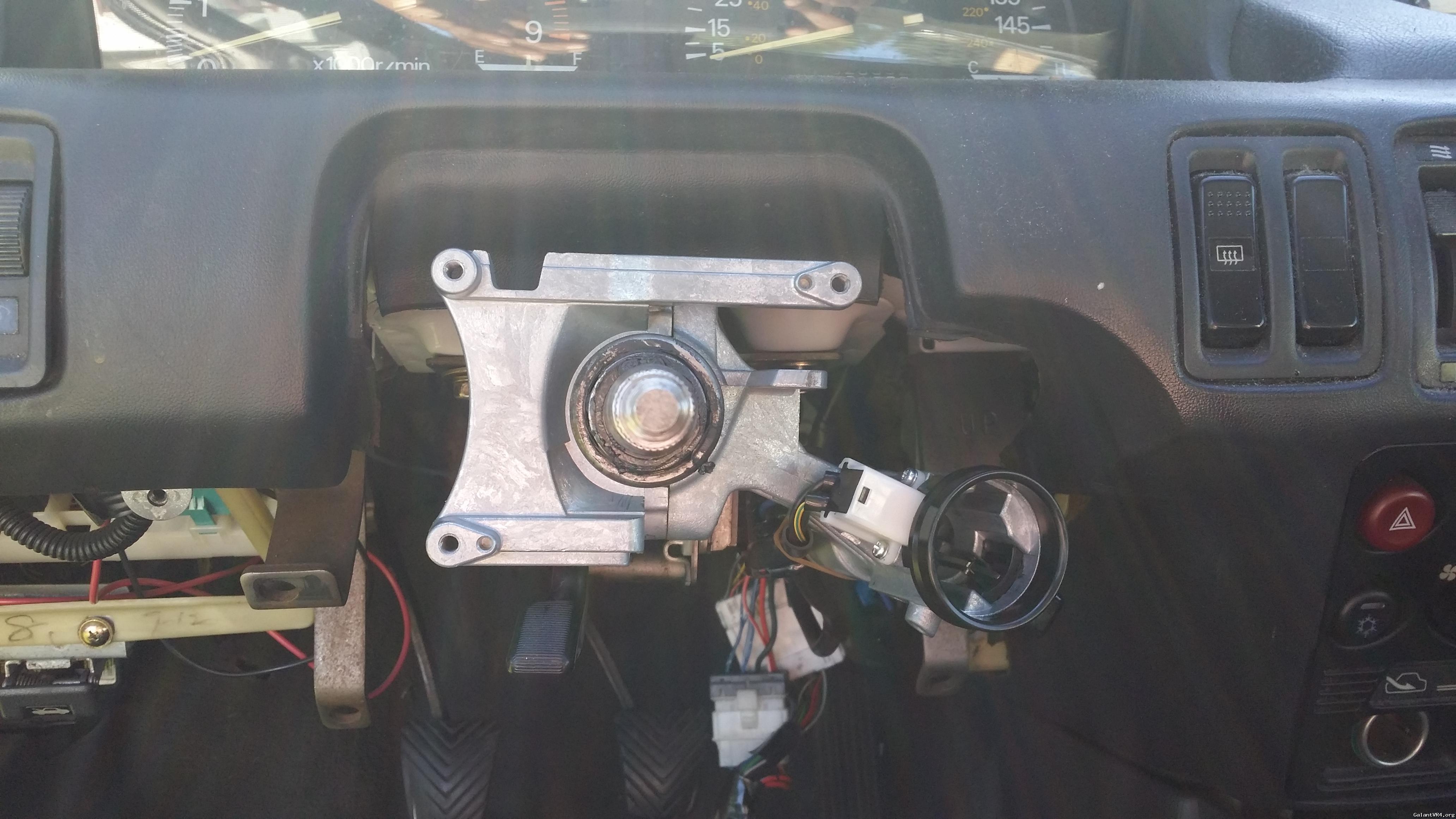

What I end up doing was removing the ignition switch and wheel lock as a complete unit. I then took it to a locksmith to see if he could remove the lock cylinder. Dropped it off Saturday, I haven't had chance to stop back through there yet.

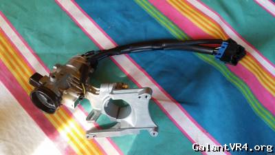

johnnyRacer
Jan 9, 2005
782
Tampa, FL.

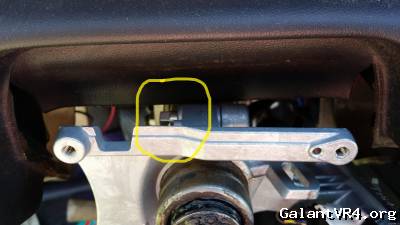

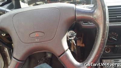

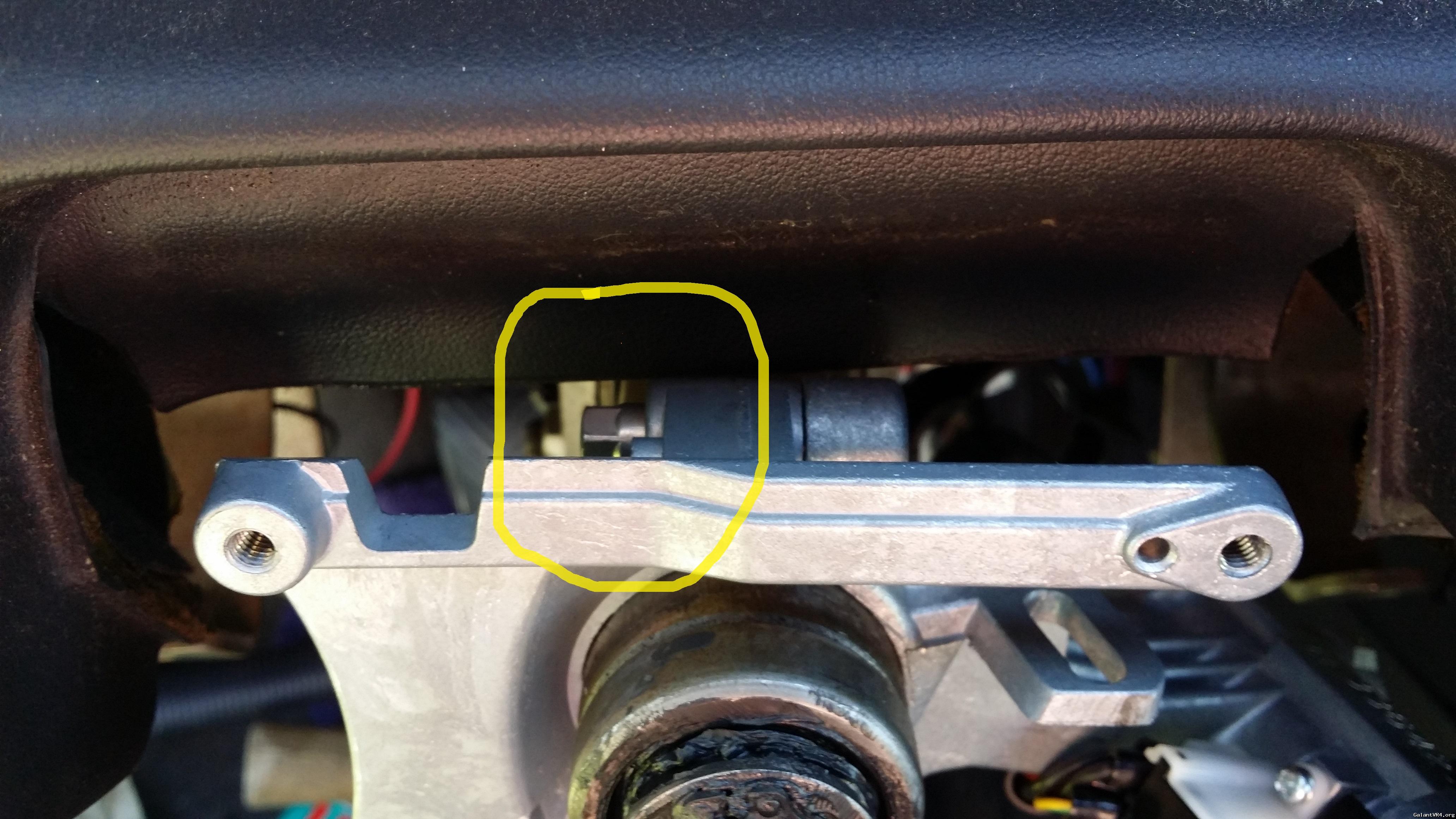

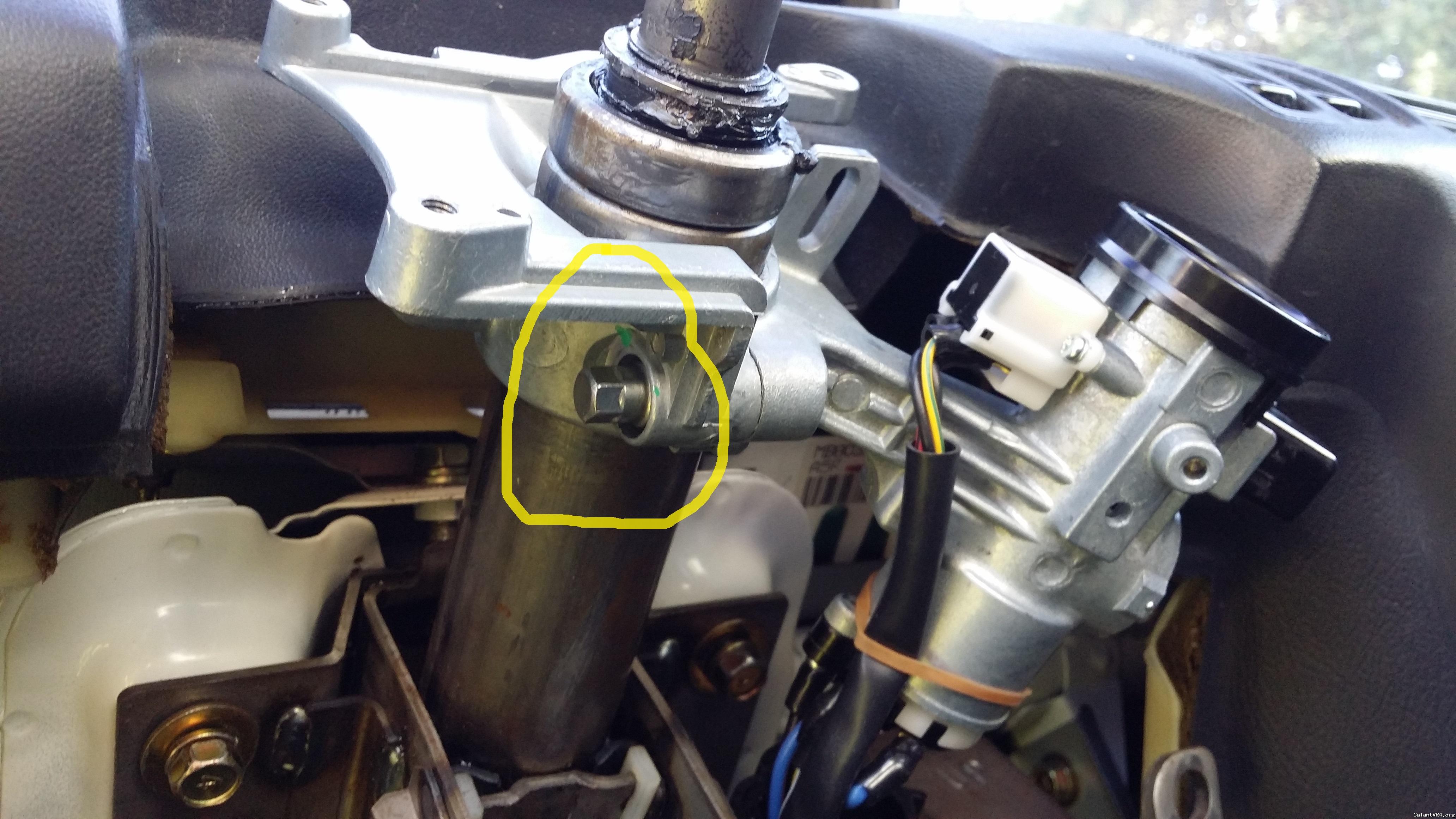

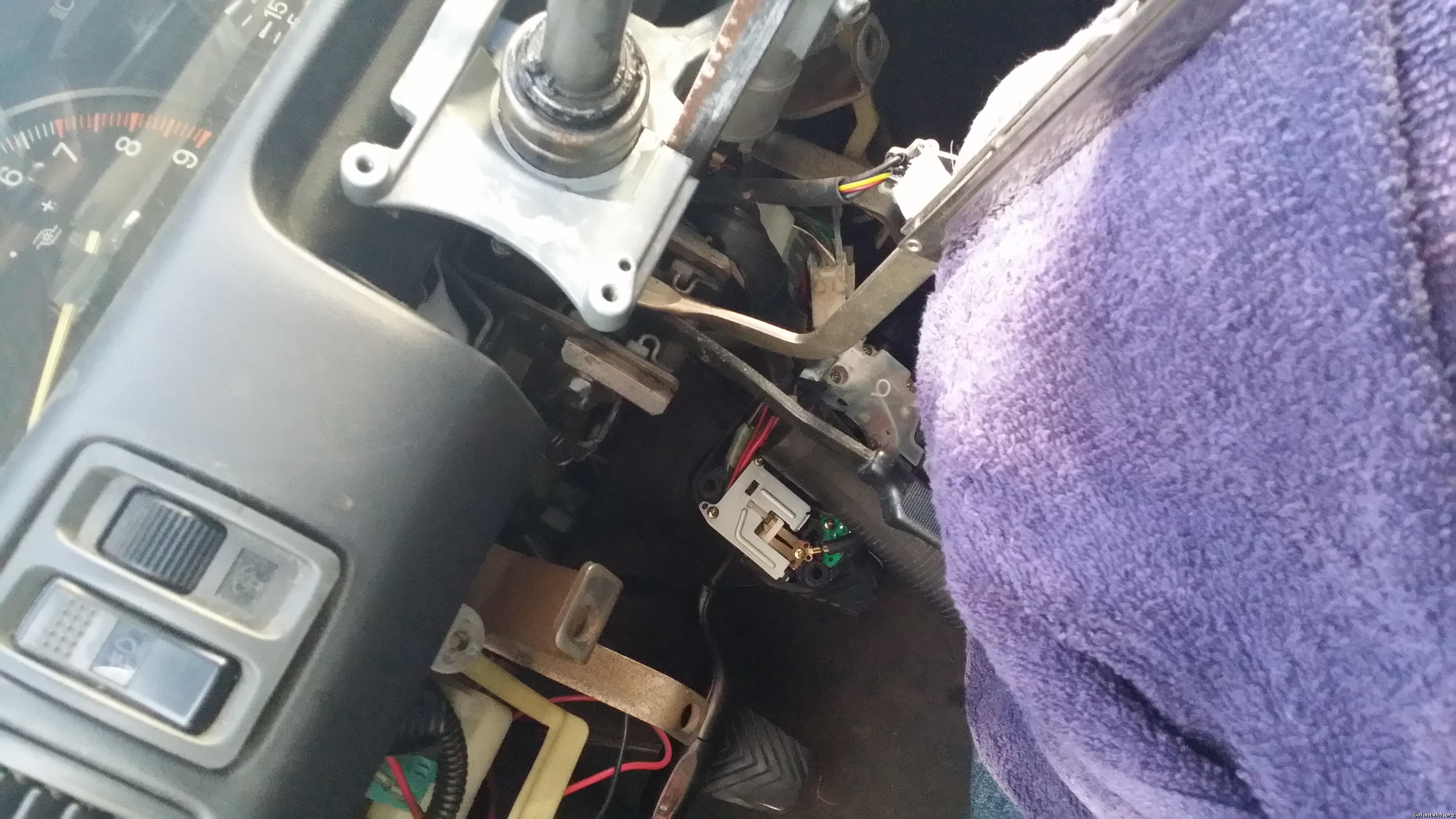

This is what I did, I had to cut off the security bolts to remove the ignition assembly. That's my knee under the blue towel applying pressure to the hacksaw. Yeah, I know I could've cut this with many different tools. The hacksaw is what I had handy.

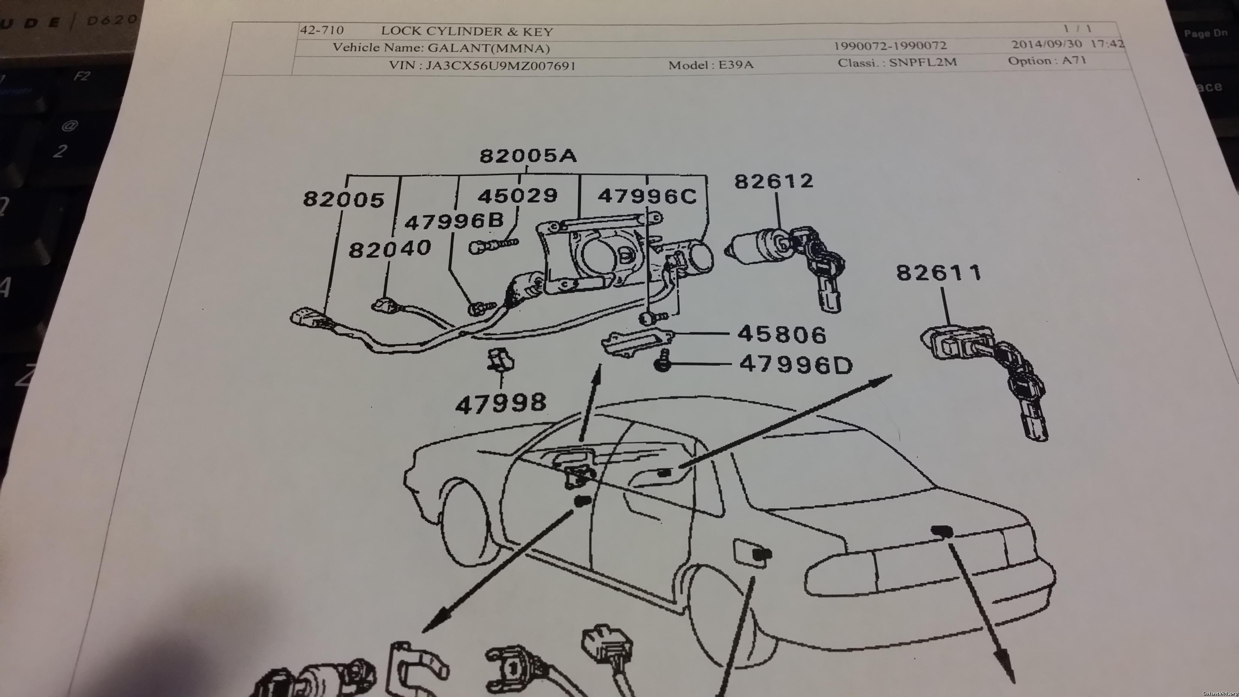

Instead of repairing my old 23 year old parts, I decided to just replace them since some are still available. This is what I ordered; everything on line 82005A along with the ign cylinder (82611). Got new security bolts, too.
johnnyRacer
Jan 9, 2005
782
Tampa, FL.

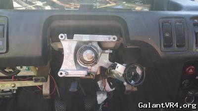

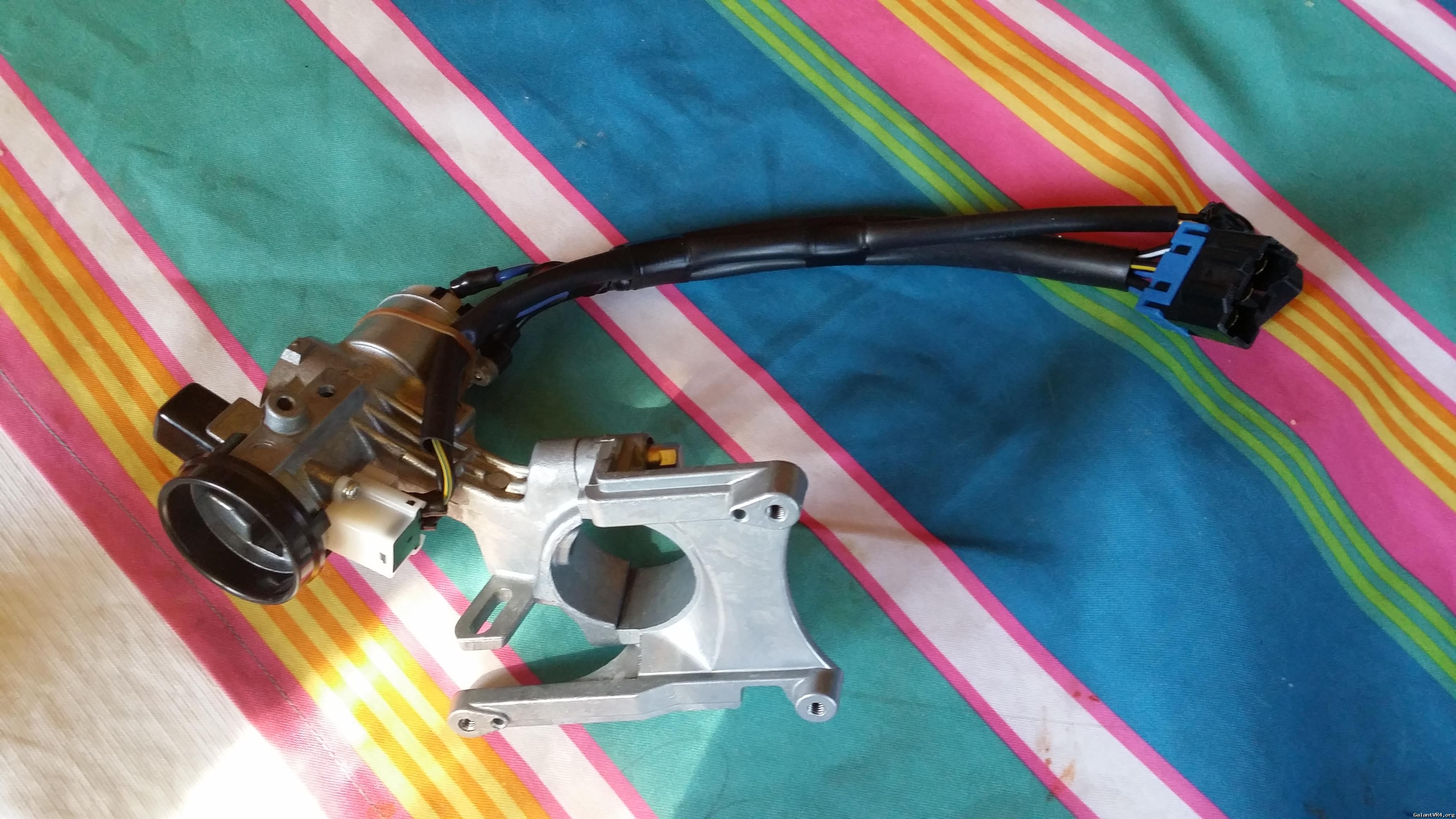

Okay, this is where I'm at with this.
1. New parts minus the lock cylinder, its at the locksmith for rekeying.
2. New parts go on

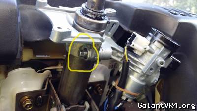

You can see the new security bolts here. I'm thinking of not breaking these off, it would've definitely made the job easier by not having to cutting these out.
Awaiting the steering wheel and lock cylinder.
johnnyRacer
Jan 9, 2005
782
Tampa, FL.
No special socket needed. When you torque it down continue on until the nut part breaks off. This leaves you or someone else no ability to back these now headless bolts out, except for cutting them out.
