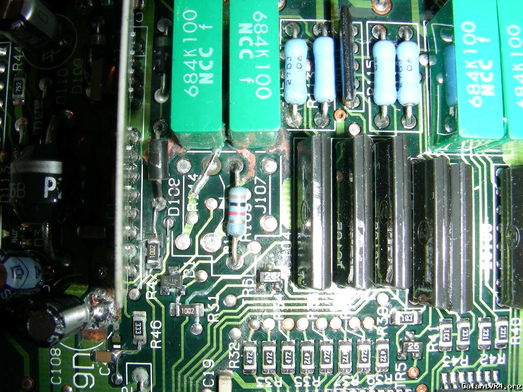

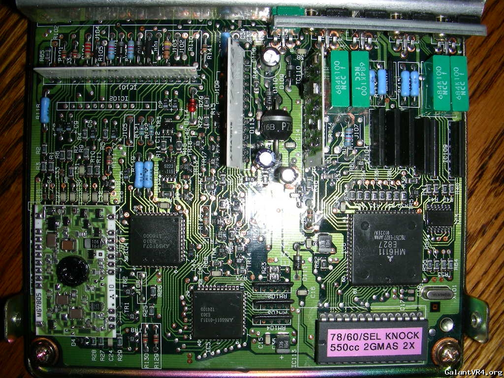

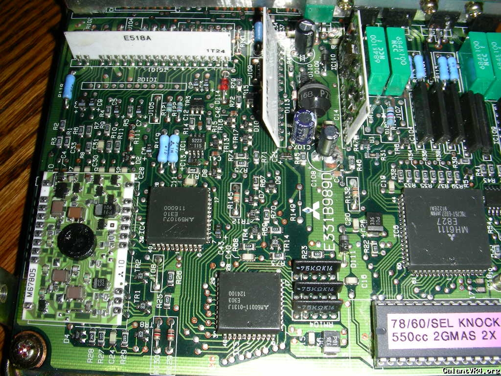

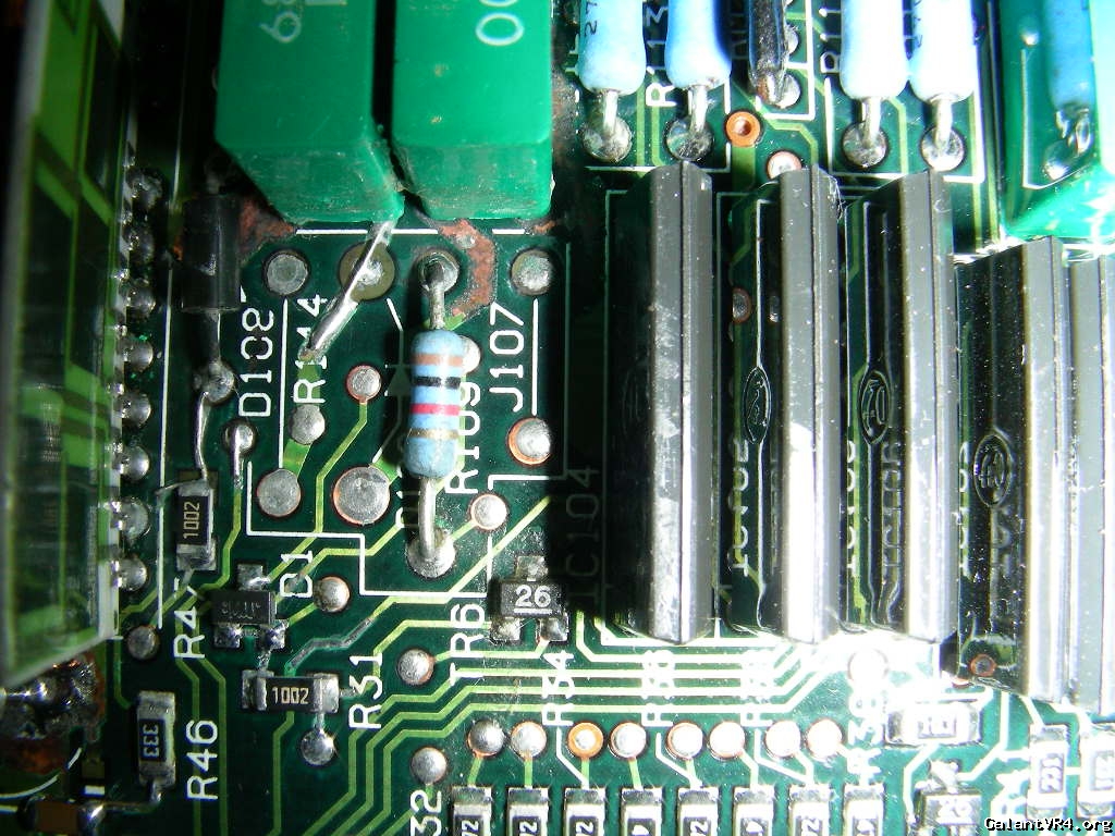

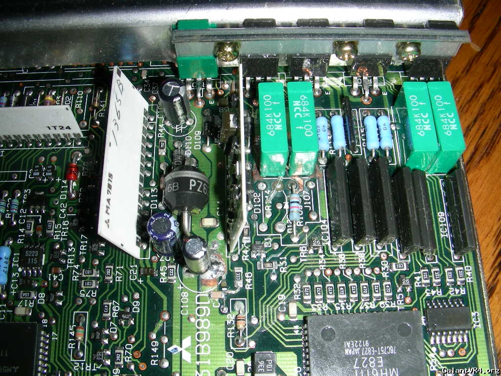

I went ahead and put my old TBI back on ( my throttle seals were newer) and my second ISC which tests out fine,but have the ECU out to photograph the board which does have some staining onthe area around a smaller replaced cap also one of the green square caps has some trace exposure on the board as well as what looks liek a previous attempt at a jumper ( see 1st pic then click to enlarge) , kind of looks like they sweated the solder on the leg of one of the round caps to get good conductivity , theres one small black chip in the vicinity of 105-7 that the board underneath looks a little irregular (has a "26" on it)
hopefully my POS nikon ebay refurbished camera will focus in enough for all to see what I am talking about .
toybreaker
iconoclast
Apr 30, 2006
3,581
There's definately been a repair there.
It also looks like the corrosion/damage in the area was extensive.
The residual acid really does a number on the board when it's not properly neutralized. /ubbthreads/images/graemlins/banghead.gif
