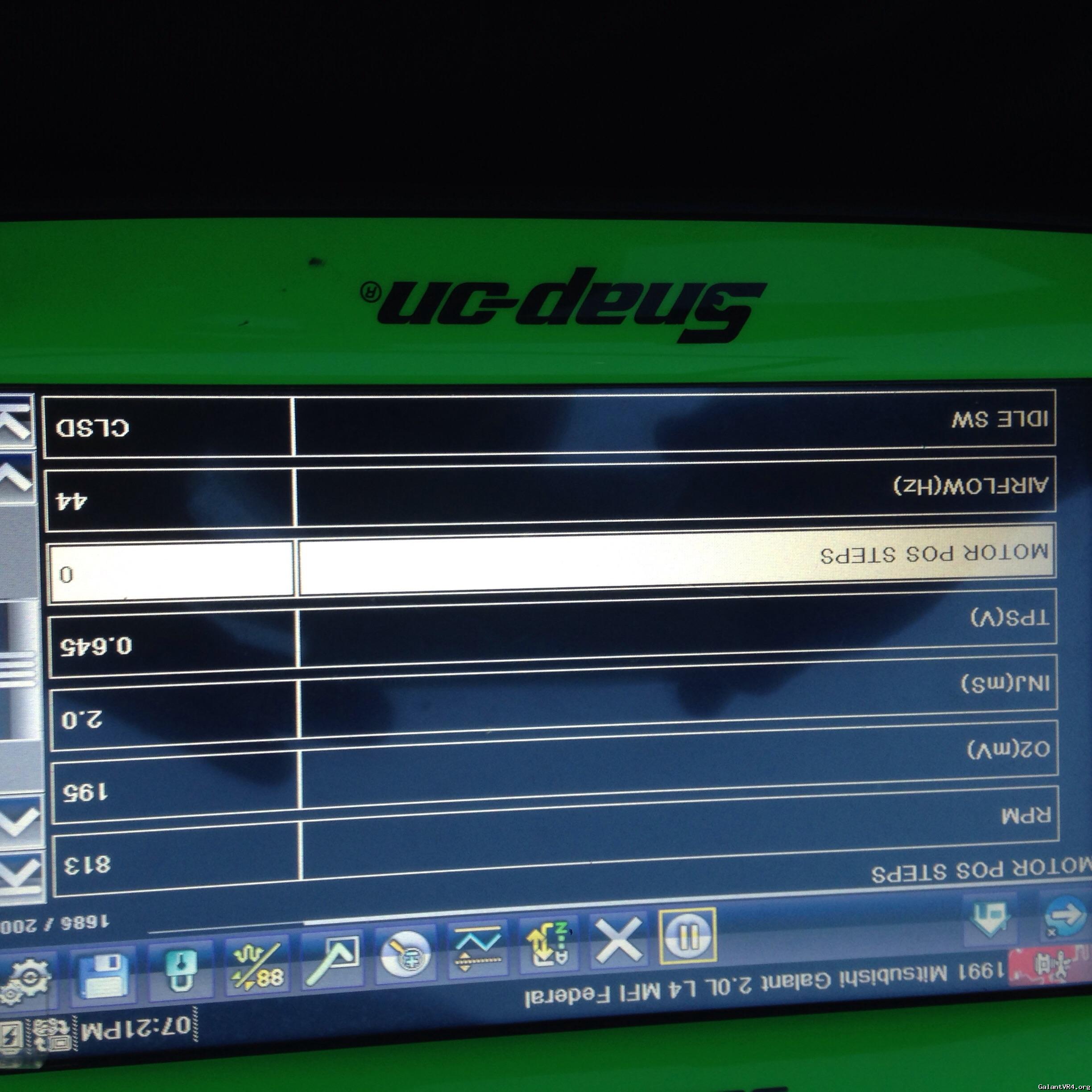

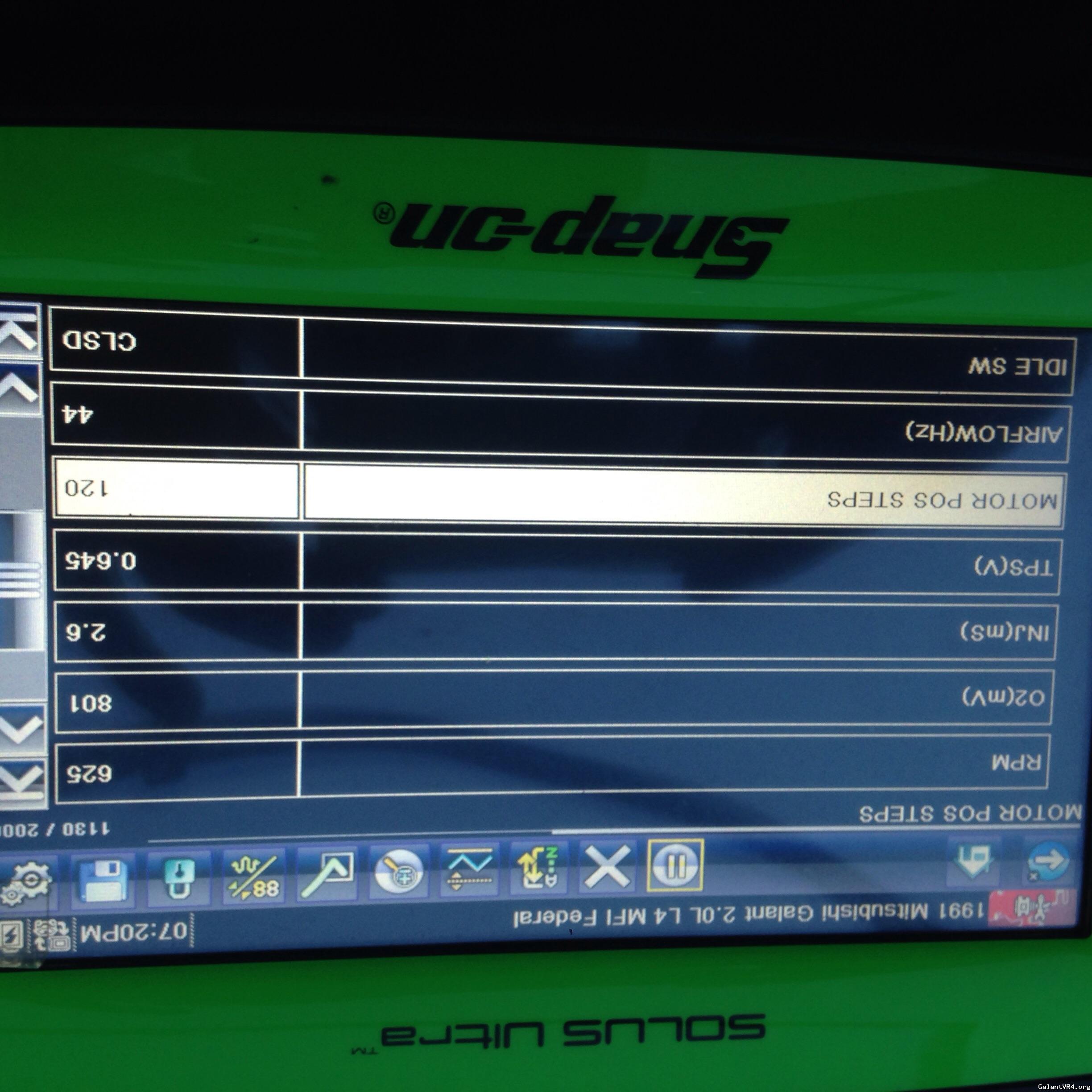

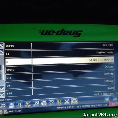

There's an isc test code on dsmecu.com. it lets you test all the different steps to see if all your coils are functional. It sounds like the isc is shot.
