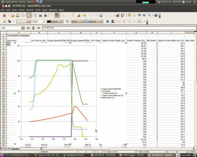

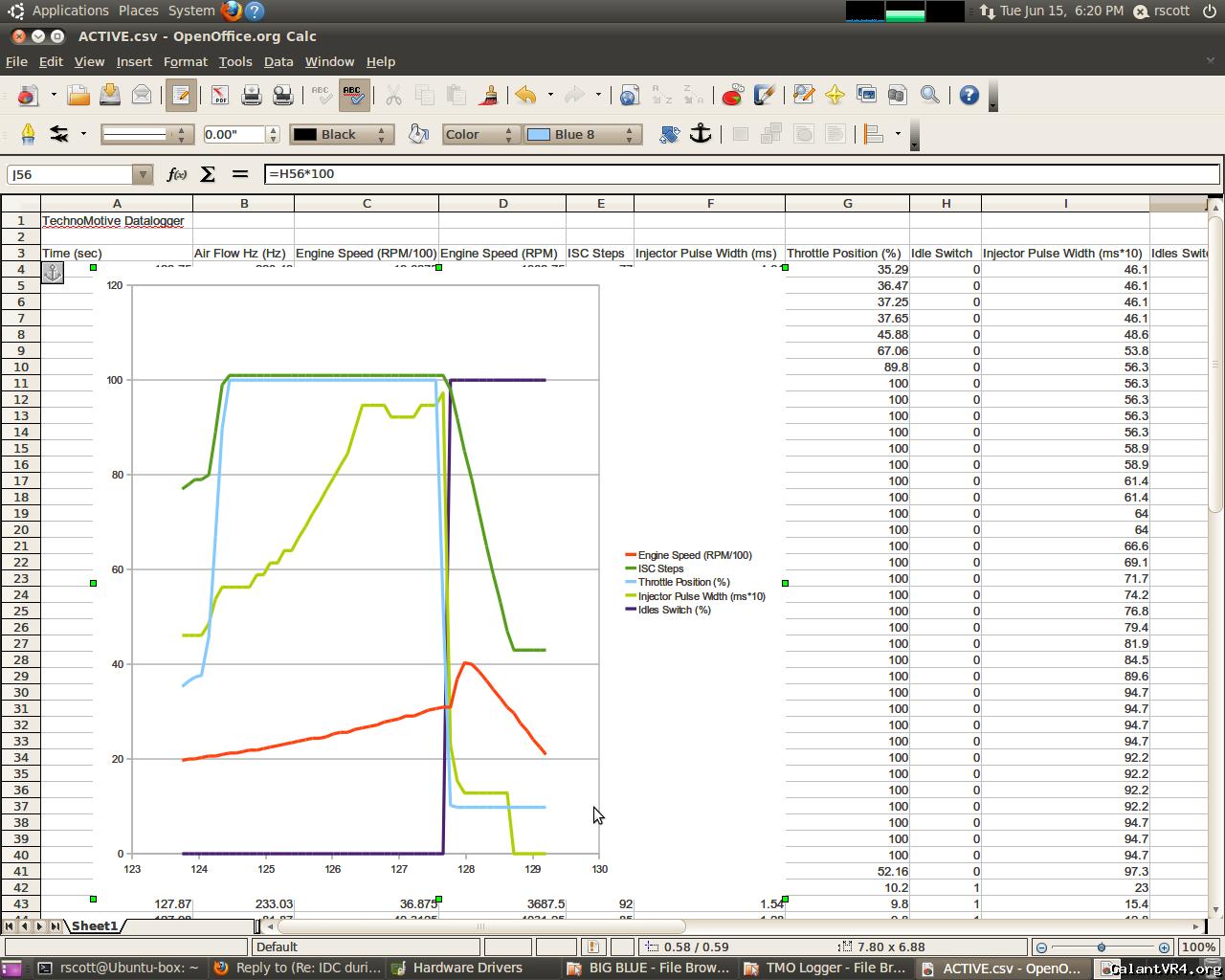

I'm not sure when mine kicks back in. I've never datalogged that range because I've never had issues with idling/stalling. My concern is more about when/if the injectors are supposed to shut down at high(ish) rpm when the tps goes low and the idle switch triggers.
Here's an excel plot of a recent log.
Note that I have rescaled things so that everything is visible on the same plot. At about 10psi, 3krpm I abruptly release the throttle and engage the clutch. The airflow quickly drops (not pictured) but the injectors don't shut off. They go to about ~1.5ms and hang there for just under a second. They then shut down and I can feel the car "settle" as the engine braking increases. It's this second of continued fueling that has me concerned and it has been suggested that maybe it's not supposed to do that.
