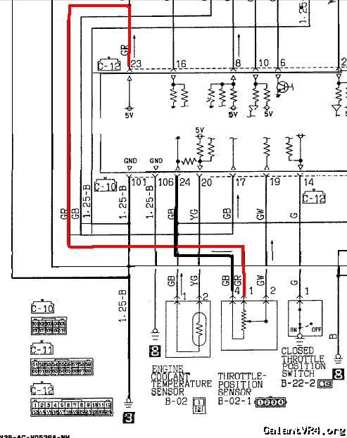

Paul, how many wires does the TPS have? If its just a simple 3-wire setup, it should be easy to figure out which wire is which with an ohmmeter. Two of the pins should show the same resistance no matter where the throttle is set, those are your 2 ends of the potentiometer. The pin that varies resistance is the wiper, which goes to the TPS pin of the ECU. The pin that shows very low resistance to the wiper when the throttle is closed is the sensors ground, and the end that is high resistance to the wiper at idle is the +5 volts from the ECU. If possible, you also want to calibrate the TPS so that at idle it is .45 to .55 volts on the wiper.
cheekychimp
Apr 19, 2004
7,333
East Sussex, U.K.
It's a three wire sensor. JAM got back to me and stated they only have wiring diagrams for aftermarket ECUs so I just asked for any diagram showing the sensor wire colours and inputs.
Yes, those wire colors exactly match the ones in the GVR-4 diagram I posted above.
