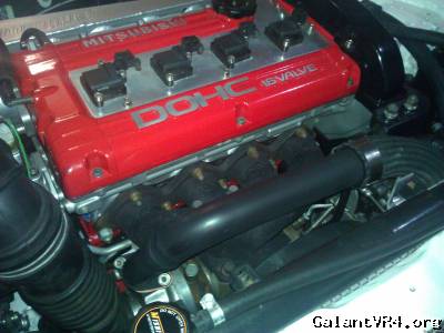

This FP manifold is becoming more of a pain in the ass than it's worth. The intercooler pipe that routes over the manifold is way too close. The heat and pressure blew the soft pipe I originally had there apart in about 30 min. So, I fabbed up a new hard pipe to go over the manifold in place of the soft pipe, but it gets hot as hell. It gets so hot, that I'm afraid the coupler on the end might blow up next. To further complicate the issue, there's pretty much zero room between the hard pipe and the manifold. I wanted to fab up a heat shield, but the intercooler pipe doesn't leave enough space for fitment. Here's a pic:
So what should I do about this? I thought about heat wrapping the intercooler pipe, but I think heat wrap looks like ass. I also thought about a manifold blanket, but they also look like ass IMO, and I don't know if they make a blanket for the FP manifold. Another thought was to just start over with the intercooler pipe, and fab another one that routes up farther, and allows me to use a heat shield.
Shoot me some suggestions here, guys. Thanks!

I think the heat blanket they make specifically for the FP manifold looks great. Transparentdsm has one and he has only said good things about it:
Maybe you can see about getting them in a different color? Not sure what you're looking for but I guess your options are limited. I do agree that a heat wrap does look crappy, especially on a cast manifold that you can't really tightly wrap. The jnz shield is expensive and may not fit your setup.

There's a pretty nice FP manifold heat shield here, not sure if it'll fit though. click
Here's a nice FP manifold heat blanket thing, designed for the FP manifold, that actually looks decent. I know you can run both the blanket and the above heat shield for extra heat paranoia. click
You also should look into getting your upper intercooler pipe ceramic coated, if not: click
I think that should cover all your heat resisting needs /ubbthreads/images/graemlins/smile.gif

Distance and air flow are both good insulators.
My ets pipe has a couple inches both in front of and above the manifold. It still gets pretty hot though. I'm going with a Metal heat shield eventually.

I heard the blankets or wrap can cause the manifolds to crack. So I did the oppisite and I use the exhaust heat wrap around the intercooler piiping to block the heat, surprisingly it worked really well. I wrapped it from the turbo to about an inch to the coupler and I touched the other side of the coupler after driving it for about 30mins and it was cool to touch.

I ran into the same issue, and wound up swapping to a ported EVO III manifold and had my intercooler pipe ceramic coated, along with the turbine housing, O2 housing and external wastegate housing. The coupler coming off of my compressor outlet was way too close to the runner on the FP manifold, so I decided to swap back to the factory style stuff with a heat shield. I was OK with it, since I figured it might be a more reliable setup in the long run.

Brett, in my opinion with the Fp manifold, it's a win loss situation. You gain spool up and some top end power over the E3 manifold, but have to deal with higher IATs. Mine kicks my butt too, especially in stop and go traffic. The pipe will get hot. I plan going to a down firing compressor housing, which from my research on tooners has pretty much been the best solution. You will need to make a compromise on getting the goal you want. If you want to stay over the top, then your better off building a shield for the hot side piping or moving away from the manifold. Don't wrap the Fp manifold, they are starting to crack at a decent rate with wrap on them.
One idea I had was to build an "over" pipe. Basically you put your hot side pipe inside another pipe, the air trapping in between acts like a blanket (think Thermos cups). It might be tricky to fab up in a appealing way though. Otherwise, you might just have to deal with heat wrap.
Sorry bud, but there are no quick answers. I really think that Fp designed this manifold with having a down firing compressor in mind.
