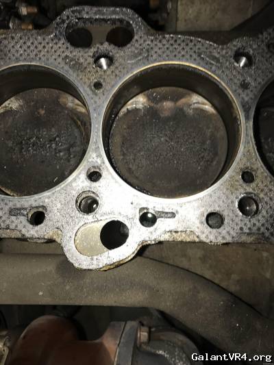

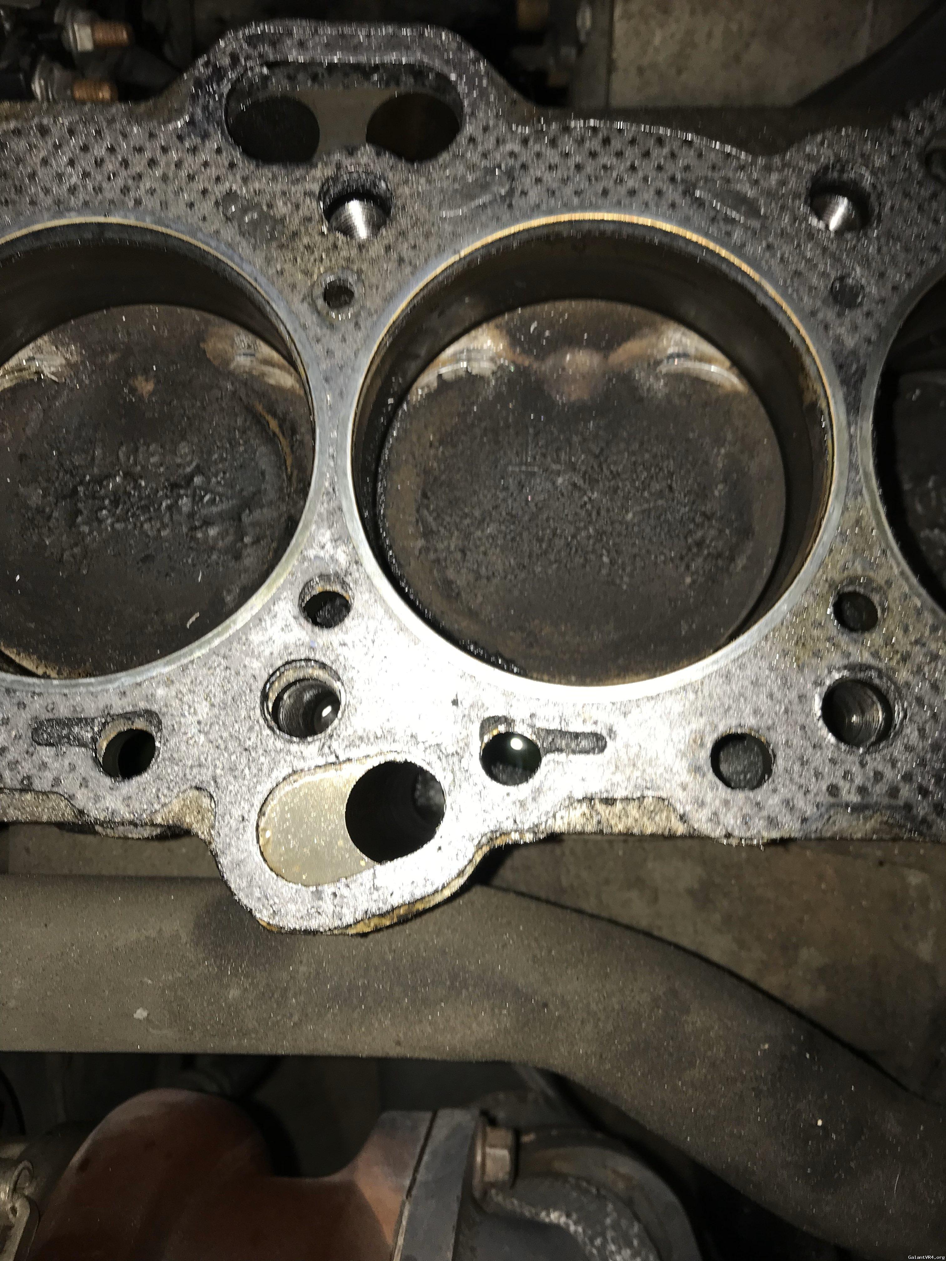

The intake cam gear skipped two teeth and made love to my pistons, I don't know if they're saveable
If this pic is too blurry I can grab a new one sometime this week.

I would inspect and make sure your ring lands are ok but those pistons look fine to me. I would run the stock longblock as is sans some mild cams like HKS 264s or equivalent. Everything else is fine....stock valvetrain as well. Just make sure they're in GOOD condition. The stock engine is really stout. No need to mess with it for the power you're looking for.

Like I mentioned before it was very common practice to just sand down the sharp edge and send it. Think of it as porting the piston /ubbthreads/images/graemlins/smile.gif I'm sorry I missed it but I didn't realize you jumped time. The short block is %99 probably OK. Did you have compression numbers from beforehand to gauge the status of the rings?
