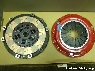

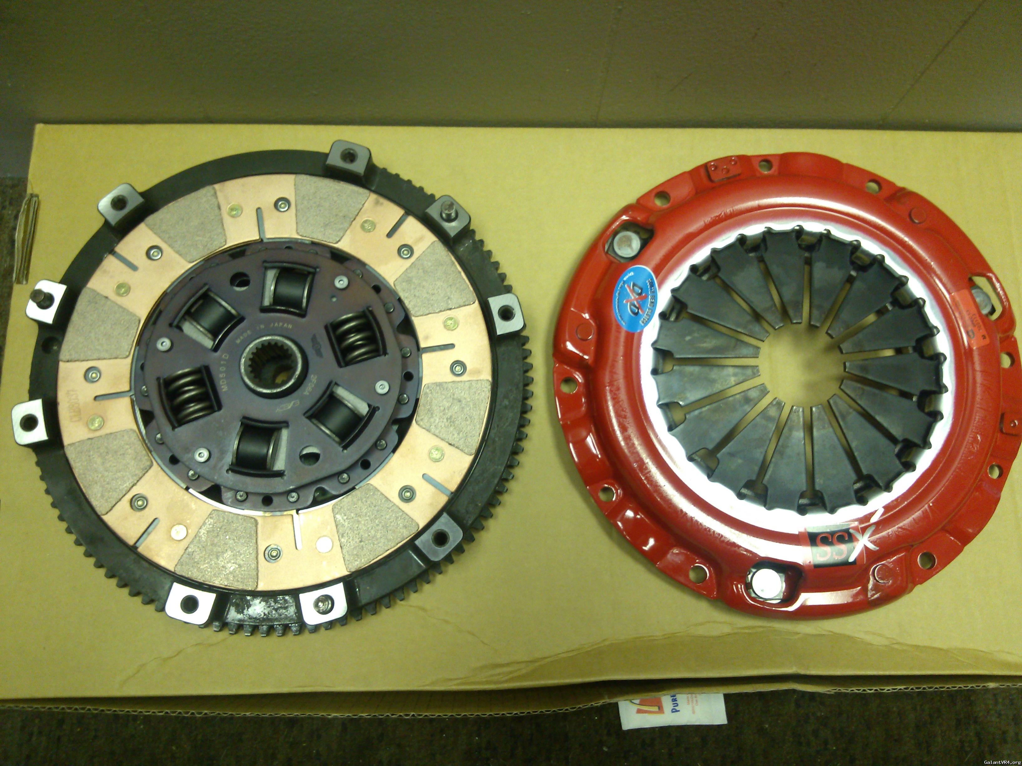

Speaking of clutches. I just picked this up this morning. It's the SS-x/B ceramic on both sides. It was recommended not to use the Kevlar on one side because I use slicks.
I bought this based on WOP's recommendation. TRE said my center diff was done and shipping back today for tomorrow. I've got all the gear stacks apart and ready to go back together with new parts later tonight.

Looks like a exedy disc with re-painted clutch cover /ubbthreads/images/graemlins/dunno.gif /ubbthreads/images/graemlins/dunno.gif
