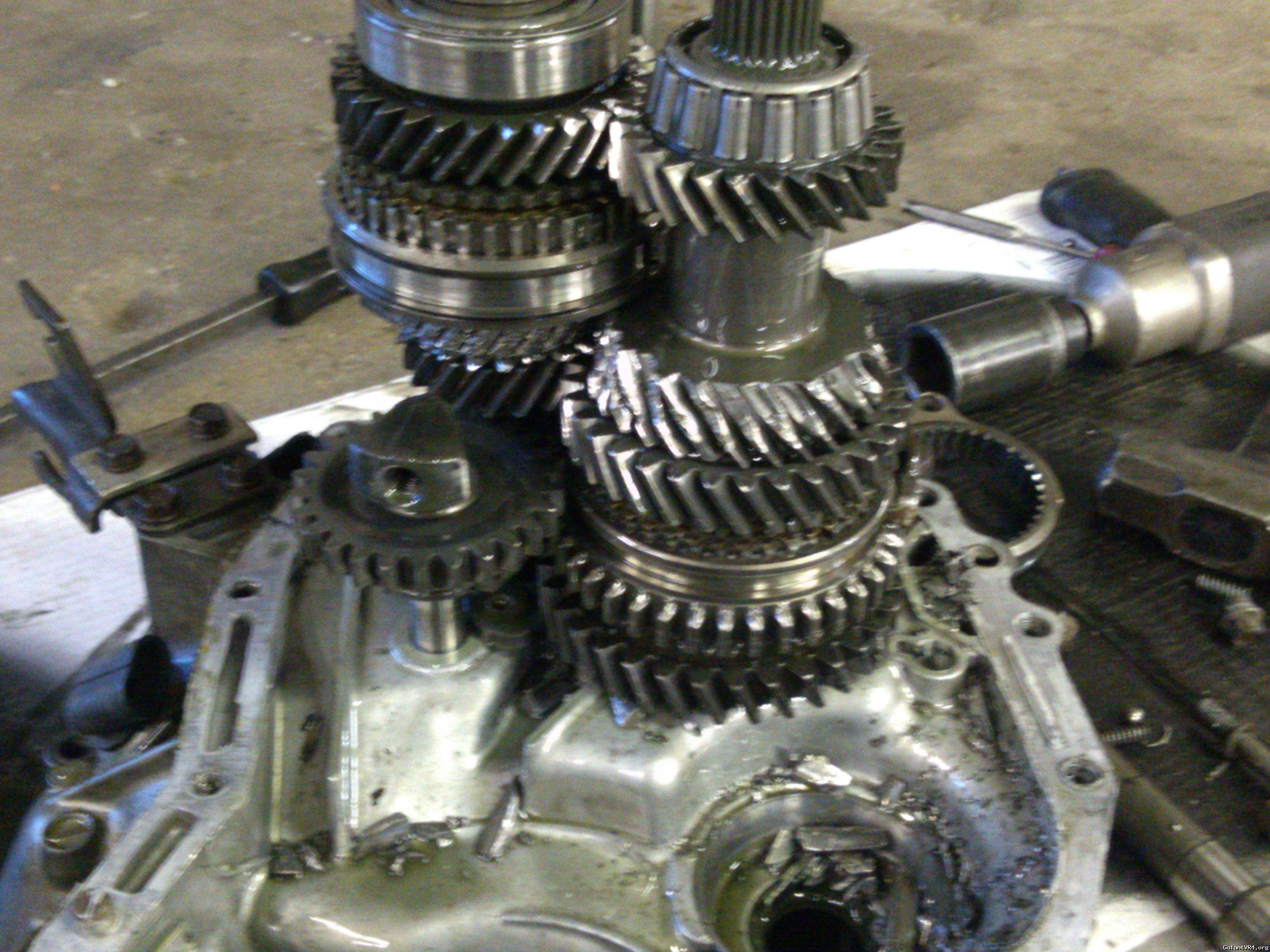

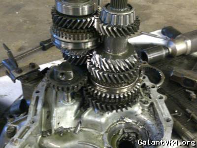

I knew that my luck with this transmission was too good to be true. Out doing some logging and tuning yesterday on my way home from doing my taxes I get on this nice straight section of road I decide to stand on it and run it though the gears. First gear was awesome spinning all 4 just rolling into it. 2nd felt real good, 3rd only lasted about a second before the $hit hit the fan and all kinds of bad noises started coming from the transmission. Pulled it over and got a ride to pick up the truck and trailer. Really bad noises and not wanting to roll to get it loaded. Hopefully I can get it all apart later tonight. I just hope the center diff and my evo 3 first gear are still good. It doesn't leak fluid so hopefully the case is still good. This is exactly why I never drive it on the street anymore.

Transmission was built by me. Had TRE Evo 3 1st, 94 dbl syncro 2nd and stock 94 3rd through 5th. TRE 4 spider center diff. Trans had approx 7k miles on it. 5K of which are all racing miles. It has many many launches on it on auto-x slicks. I knew the stocl 3rd and 4th were the next weakest link. I had planned to tear it apart and magnaflux everything when I did the clutch. Just wanted to make it through the first event which is the 5th and 6th of April. I've been wanting to upgrade to the evo 3 3rd though 5th. I now have to try and get it all put back together to try and drive it some to seat the gears and the clutch. I'll be taking the launches easy. It's making some serious torque since the switch to E85 and the 2G cylinder head swap. It could be the transfer case as it has an unknown amount of miles on it. It was a spare I had lying around that I threw in there when I swapped out the output shaft last year. The old one kept leaking even after replacing the seal. I've got to finish the car I have on the rack now so I can start taking things apart. The hard part is going to be getting it in the shop as it doesn't want to move.

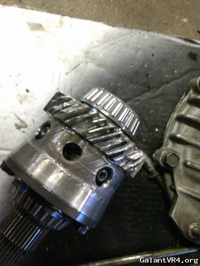

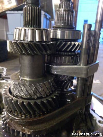

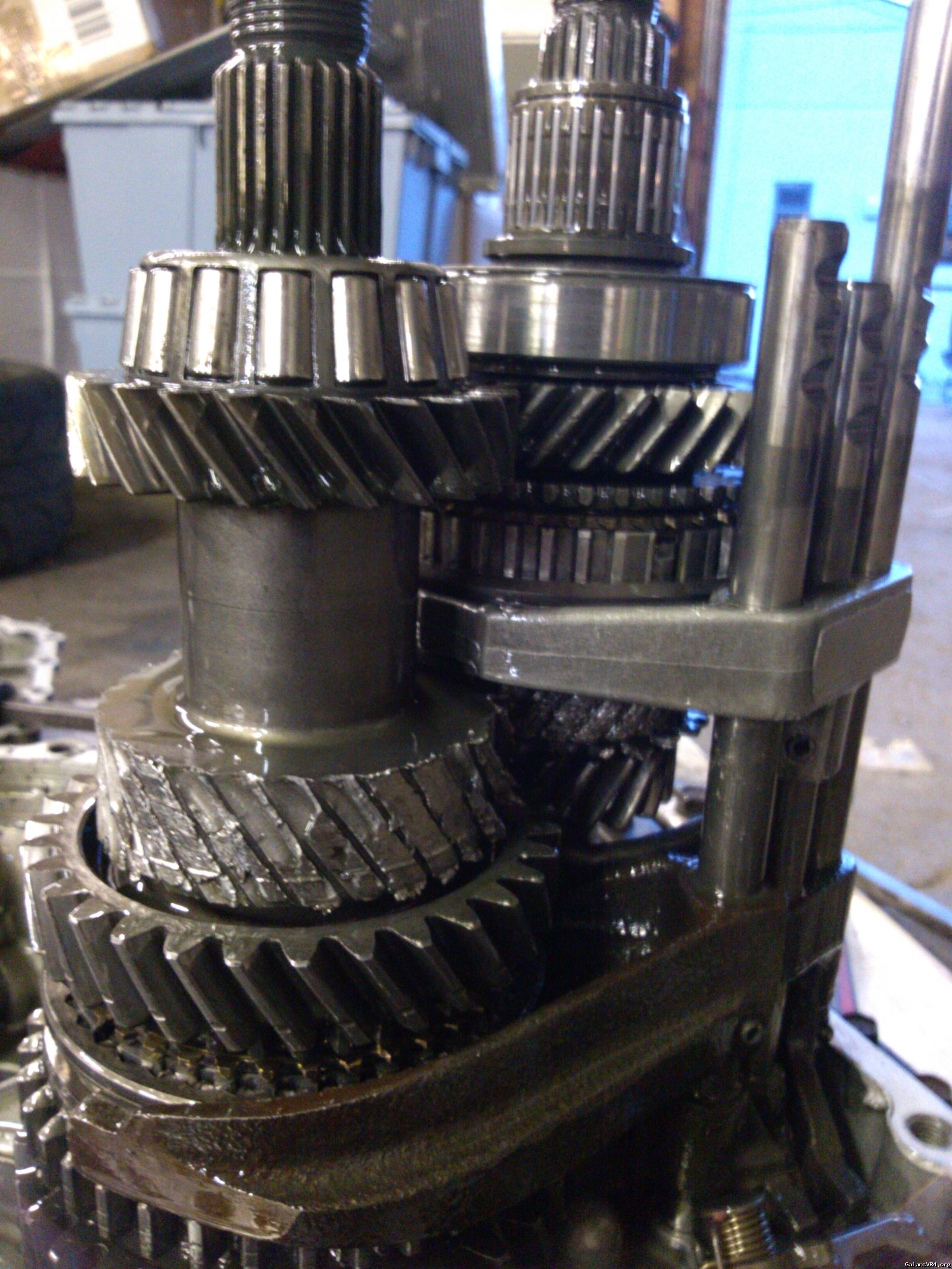

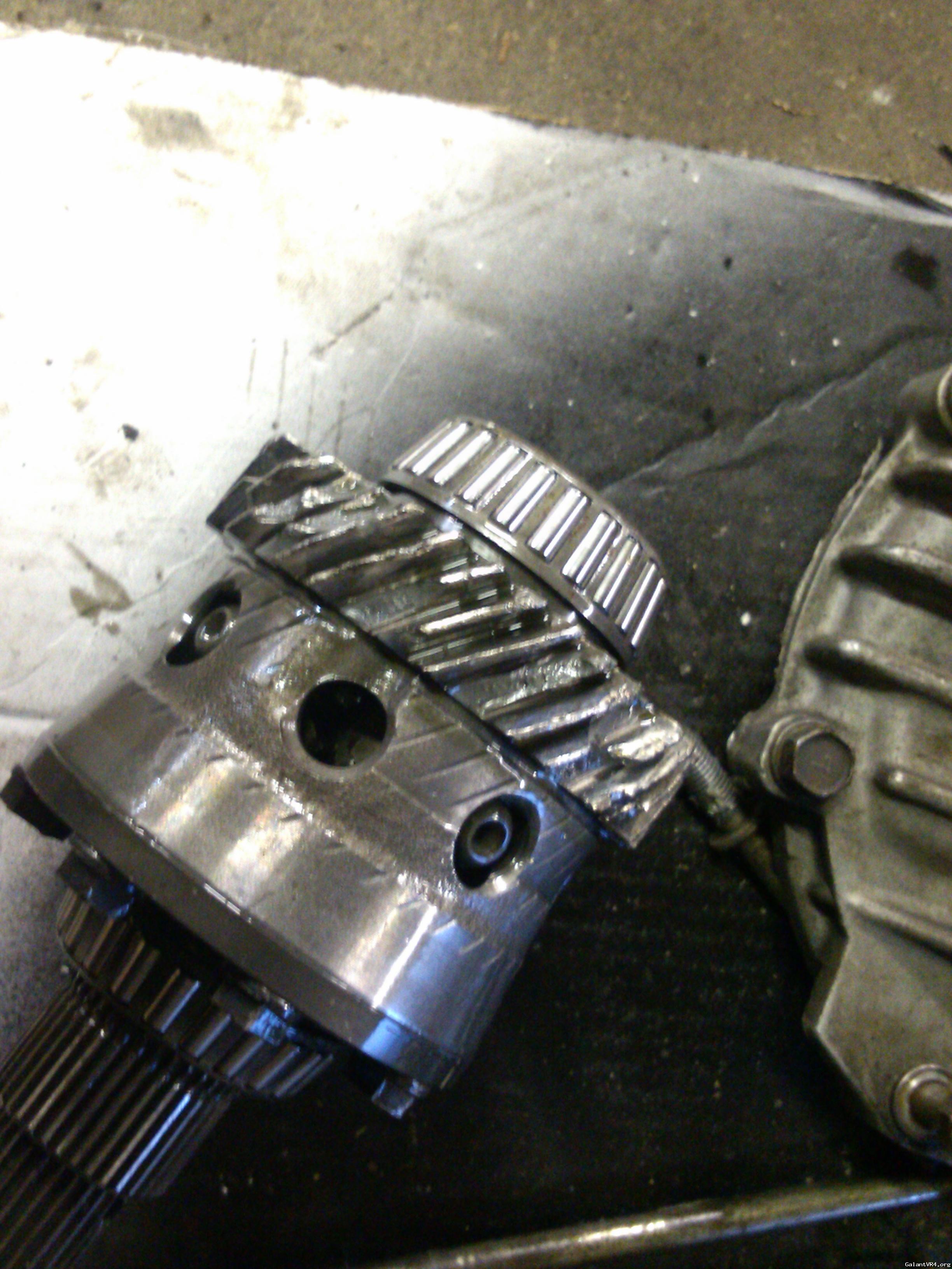

Yup. 3rd gear carnage. Unfortunately it also got the TRE center diff. That is the biggest bummer. 1st and the input shaft are still OK. I'll have them magnafluxed to be sure.

That sucks it took out the diff. Tough luck dude /ubbthreads/images/graemlins/frown.gif
I had too many launches to count and over 150 passes on my stock center diff and it never decided to take a dirt nap. Have a 4 spider in there now but I fear this type of carnage will strip a gear and chooch the center diff too.
