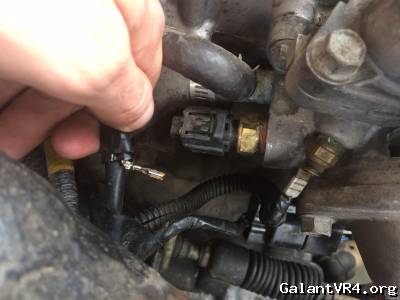

Maybe not ALL the problems, but start there and get that sensor feeding the ecm data. Being a two wire sensor, IIRC, that's the ecu temp sensor. You'll probably notice an increase in fuel mileage as the ecu isn't dumping fuel.
Might wanna do an oil change as well to be sure no raw fuel made it into the pan. No likely, but could have. (good insurance)

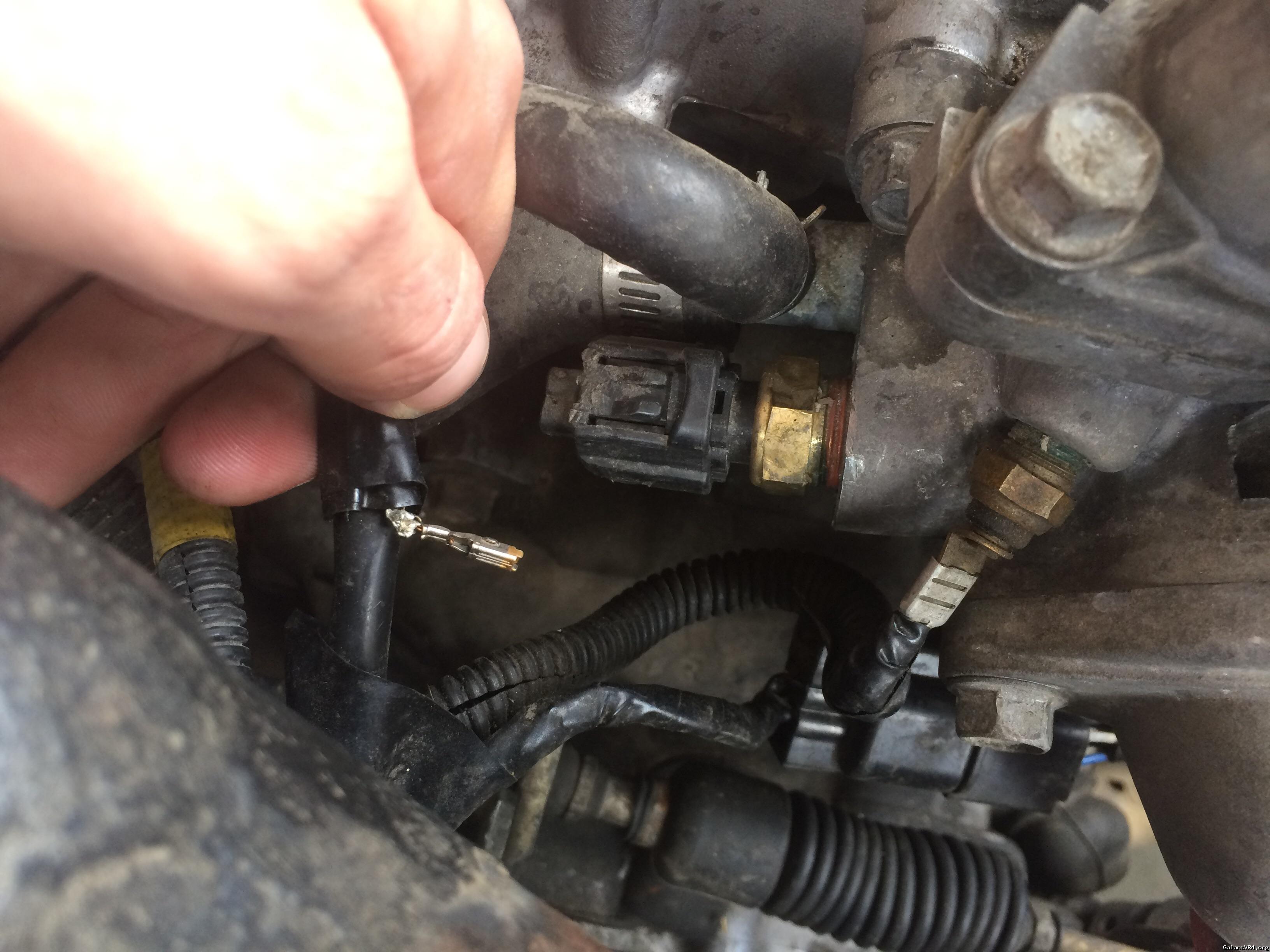

Okay here is the sensor, and I'm holding the broken wire
Here's what can happen and yes, it causes crazy problems.

The culprit:

Great. Absolutely get that coolant sensor sorted out. I've also had an IAC die and that will cause these sorts of problems. But for now, replace that fan and fix that sensor. Nothing else will behave correctly unless that is sorted out.

I got the one wire fixed and boom it starts fine now, it's still a little funky on the throttle when its cold but it now starts no problem, and idles fine. Thank you very much guys! I haven't had any overheating problems since I filled up my rad it was a tiny bit down, didn't realize I blew so much water out when it overheated one time. But she seems solid, the weather has cooled down a lot so it is also a factor, I want it to be hot to test it but when it's cold outside she's golden.
