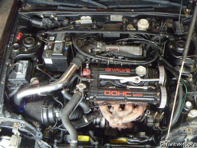

That sucks about the Diff, I'll drive it till it breaks. If its welded that doesn't both me as much as a towing mishap. Here is a pic of the top of the motor:
My understanding is that the AMG intake was a 2 piece like the cyclone, minus the dual runners. This one is not. It looks just like a 1g intake, but with cyclone on it instead.

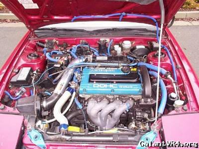

Mod number one: Remove NASCAR sticker from bumper
Most deff an AMG, the only other type it could be is the NT AMG
Click

Quoting Jesse_W:
http://img.galantvr4.org/94000/94344-0-0-0.jpg[/img] -0.jpg]Click
I thought that the amg,s were all nonturbo /ubbthreads/images/graemlins/dunno.gif
But anywhos... The intake in the link you posted doesn't have the "ribs" that a 1g manifold has, which mine does.
Some one show me a pic of a 1g intake labeled "Cyclone" /ubbthreads/images/graemlins/grin.gif

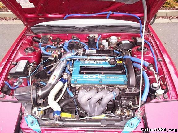

As far as I have found, the intake is from a JDM NA Cyclone:
Someone correct me, this was the only picture of an intake like mine, and I doubt this guy would even know what an AMG intake is.

those manifolds are not AMG's.... i've seen quite a few of those on NA 4G63 Galants here in australia, that mani came standard on one model year i think.... 89 model if i remember correctly....
we had 3 6th gen galants here... model run was from 89 - 92...
Galant SE - SOHC 4G63
Galant GSR - DOHC 4G63
Galant VR4
that mani with cyclone written came on 89 model GSR......
i stand corrected.
