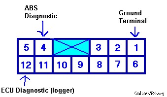

I don't think most people realise you can actually read ABS fault codes on our cars. Well you can, just not via the ECU (i.e. via a logger). I collected most of the following information and links from searches on here (mainly Keydiver /ubbthreads/images/graemlins/wink.gif), but it was dispersed and not clear. Hopefully this will help anyone else who's trying to track down an elusive ABS fault.
All you need is a simple voltmeter (preferably analog). First go for a short drive so the car has gone over 4mph; this allows the ABS system to complete all of it's own tests and startup diagnostics. Leave the car running whilst you read the codes. Then ground pin 1 on the diagnostic plug with the negative lead, and apply the positive lead to pin 4.
![](https://www.galantvr4.org/img.php?id=38315&width=400)
Now, read the codes according the same method used on this webpage.
Lastly, correlate any codes you get with those listed in this document: ABS Codes (you'll need Acrobat Reader).
