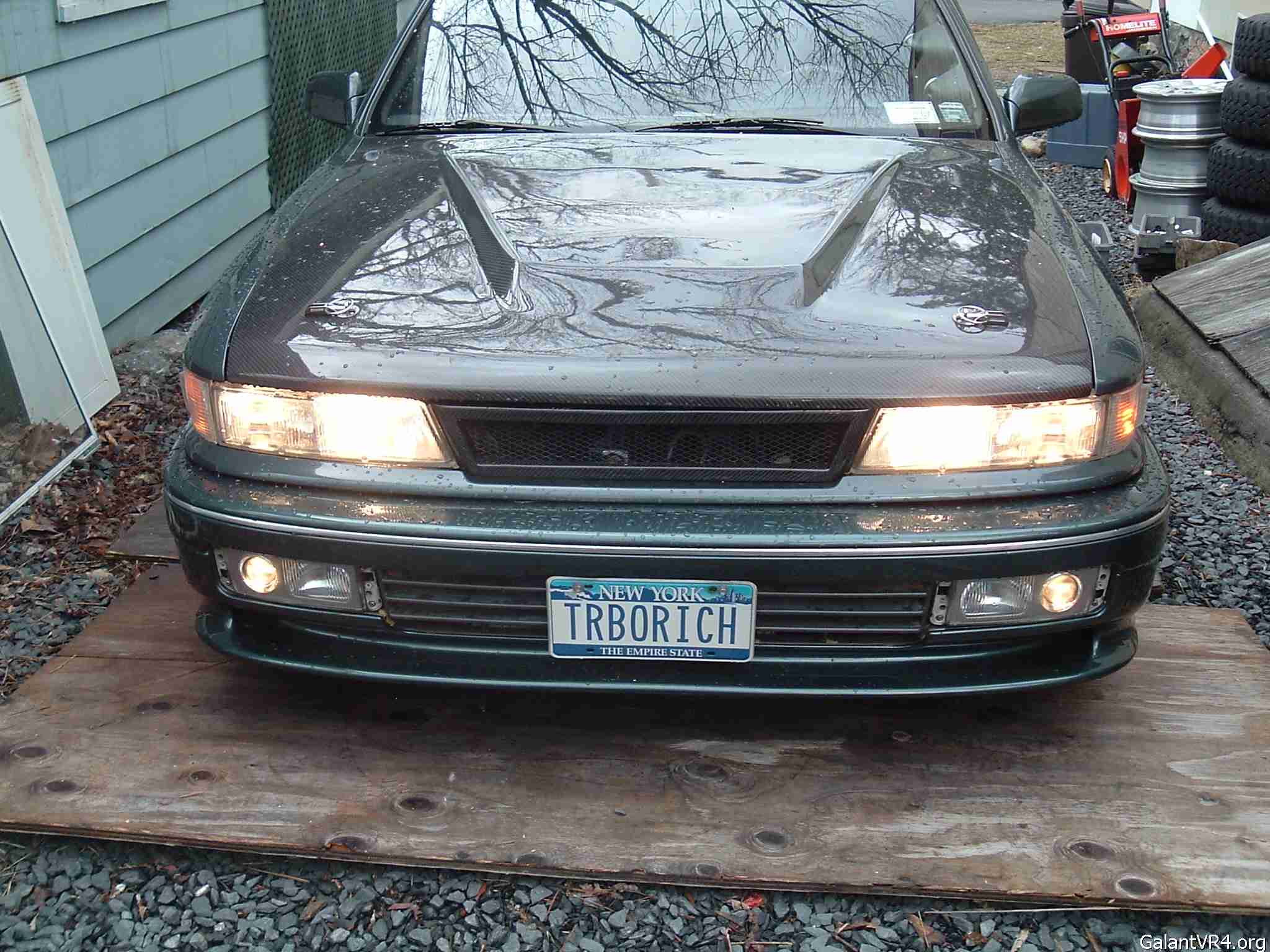

After doing a lot of searching both here and on VFAQ and not finding an answer that I deemed acceptable I decided to make my own "How-To" on this topic. The mission here was to make TurboRich able to rock the JDM projector fogs (and eventually the daytime lights in his soon to come JDM lights) anytime the parking lights are on rather than only when the low beams are on. This will work EXACTLY the same for the USDM fogs since I just hooked his JDM projectors to the USDM fog light wires behind the bumper. Also understand that the fogs can be switched on via their standard switch anytime the parking lights are on. Even if the high beams are on, the fogs will still be on, that is definitely not legal but please don't bother telling all of us about how we are breaking all sorts of laws and do these mods at your own risk.

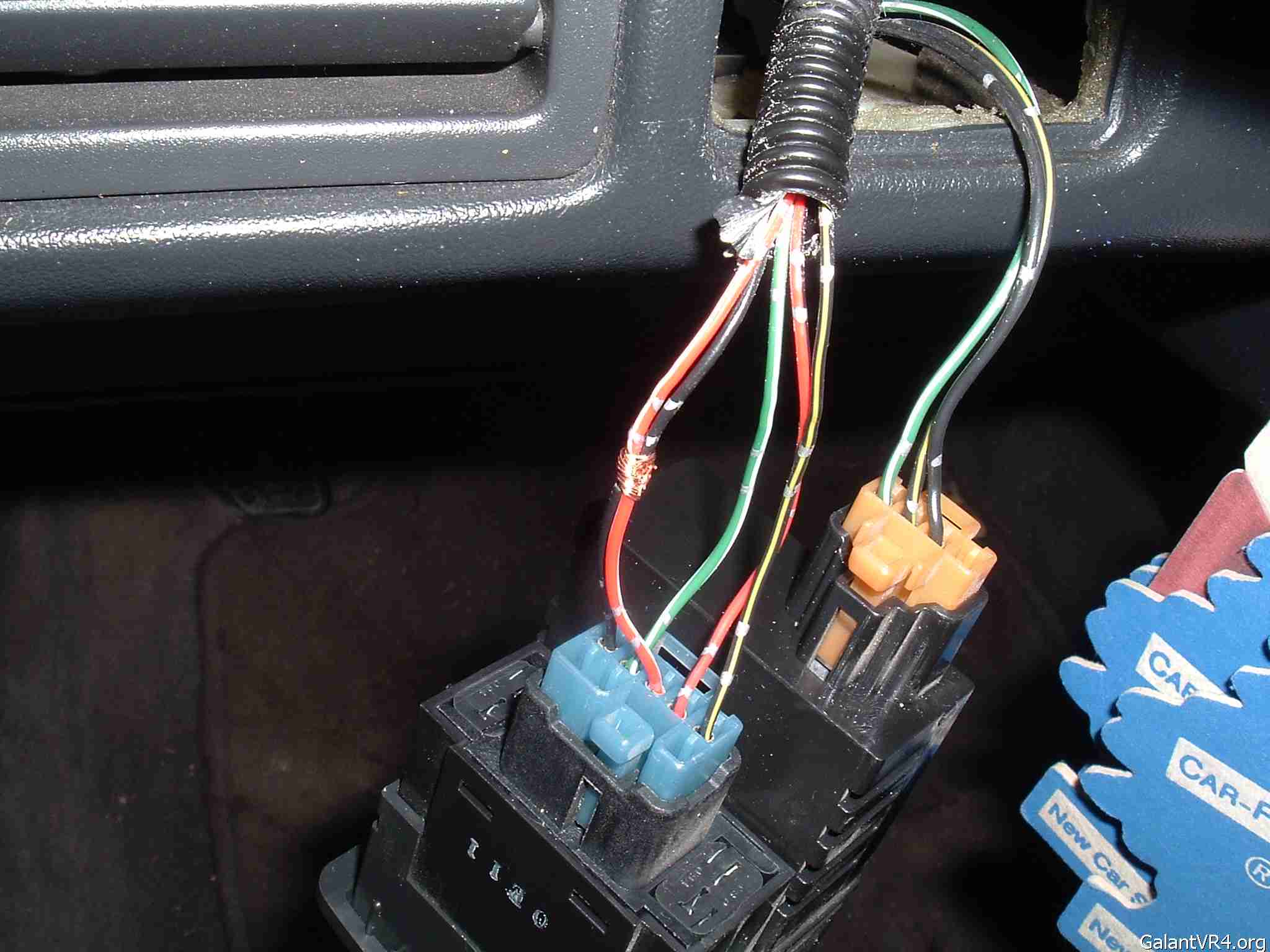

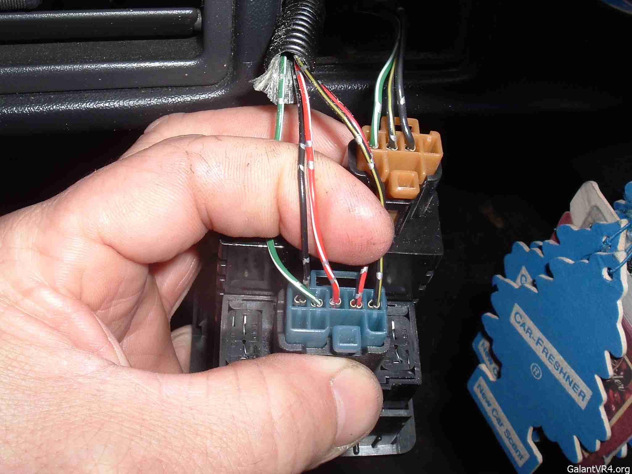

1. Remove fog light switch from dash (it just pops out) and locate the black wire and the red/white wire on the blue connector.
2. You will strip a little off of each of them and tie them together either by soldering or wrapping a piece of wire around the two of them and then tape it up appropriately. If you only want to be able to make the fogs work with both the high and low beams then you are done. If you want to make them work with the parking lights then continue to step 3.

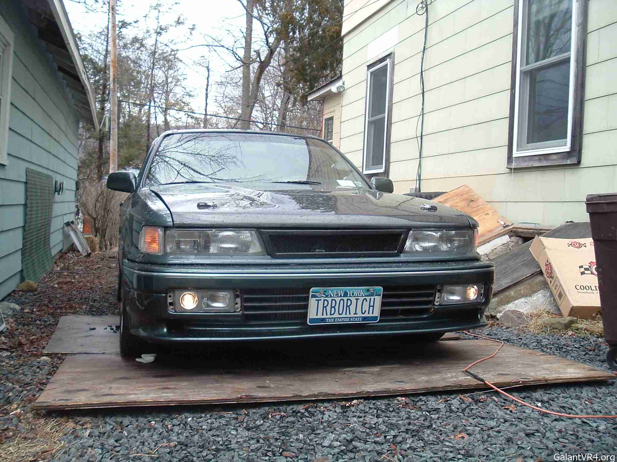

At this point you can have fogs with both high and low beams as show below:

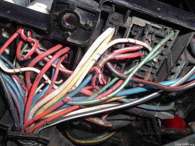

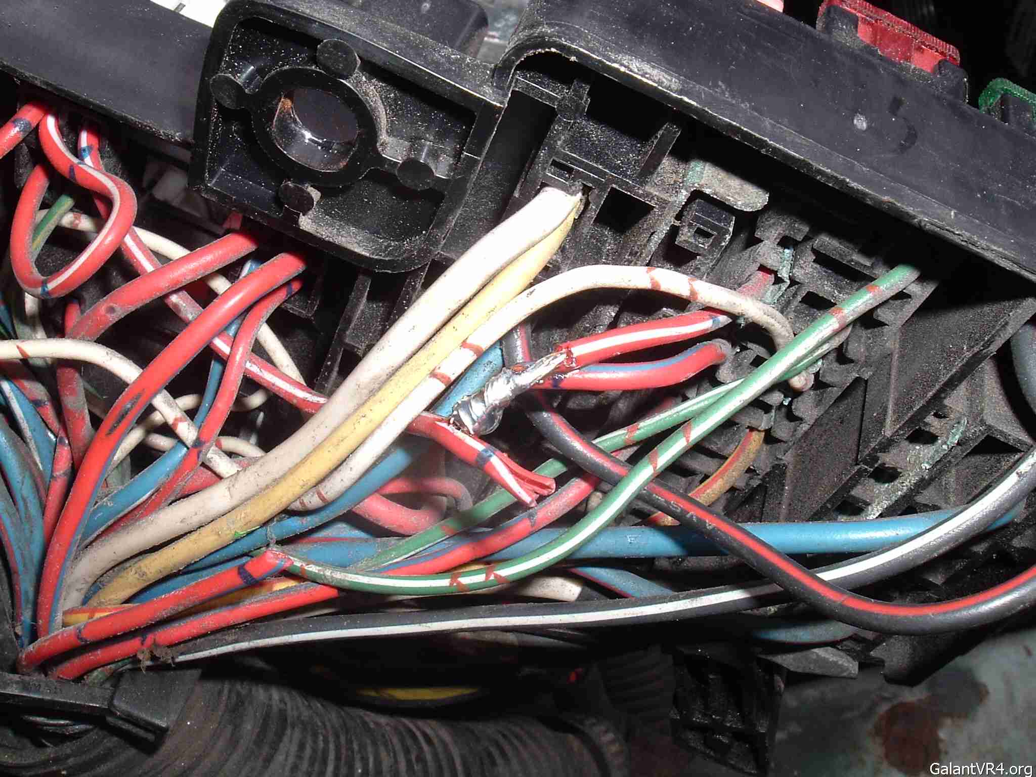

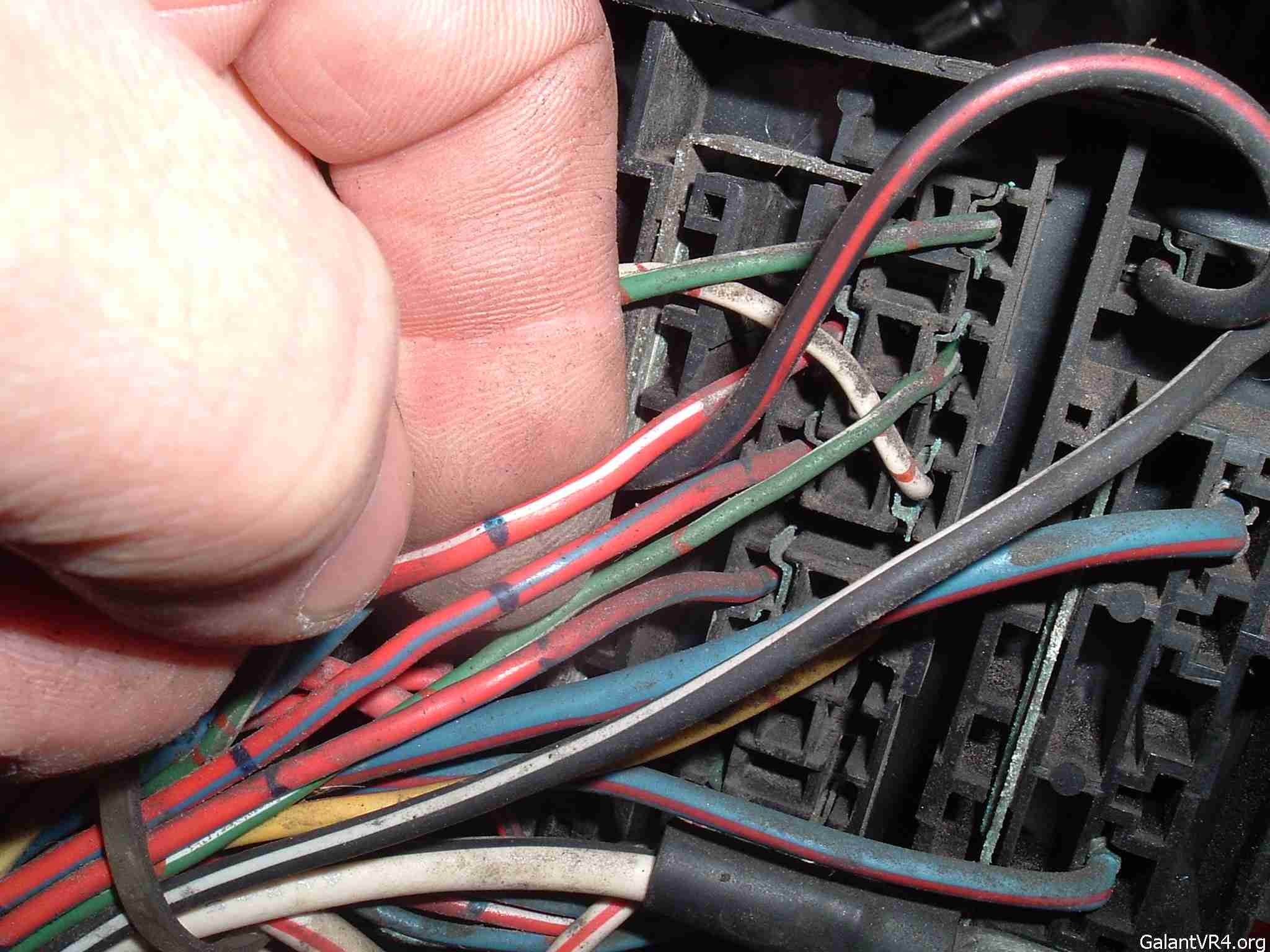

3. Locate the under hood fuse/relay box on the RF fender, notice the 10A fuse labeled "TAIL" and the 15A fuse right next to it labeled "FOG LAMP". You will be taking the wire that feeds power to the fog lamp fuse, cutting it, and splicing the fuse side of it into the wire that feeds power to the tail light fuse. Now you can remove the lid and the 3-10mm bolts that hold it to the car, flip the fuse box over and locate the wires I'm holding in the pic:
4. Cut the red/blue wire a couple of inches from the fuse box, leaving yourself enough wire to work with. You can tape up the harness end as you will not need that anymore. Strip the end of the fuse box side of the red/blue wire, strip a section of the red/white wire so that the red/blue wire can be wrapped around it.

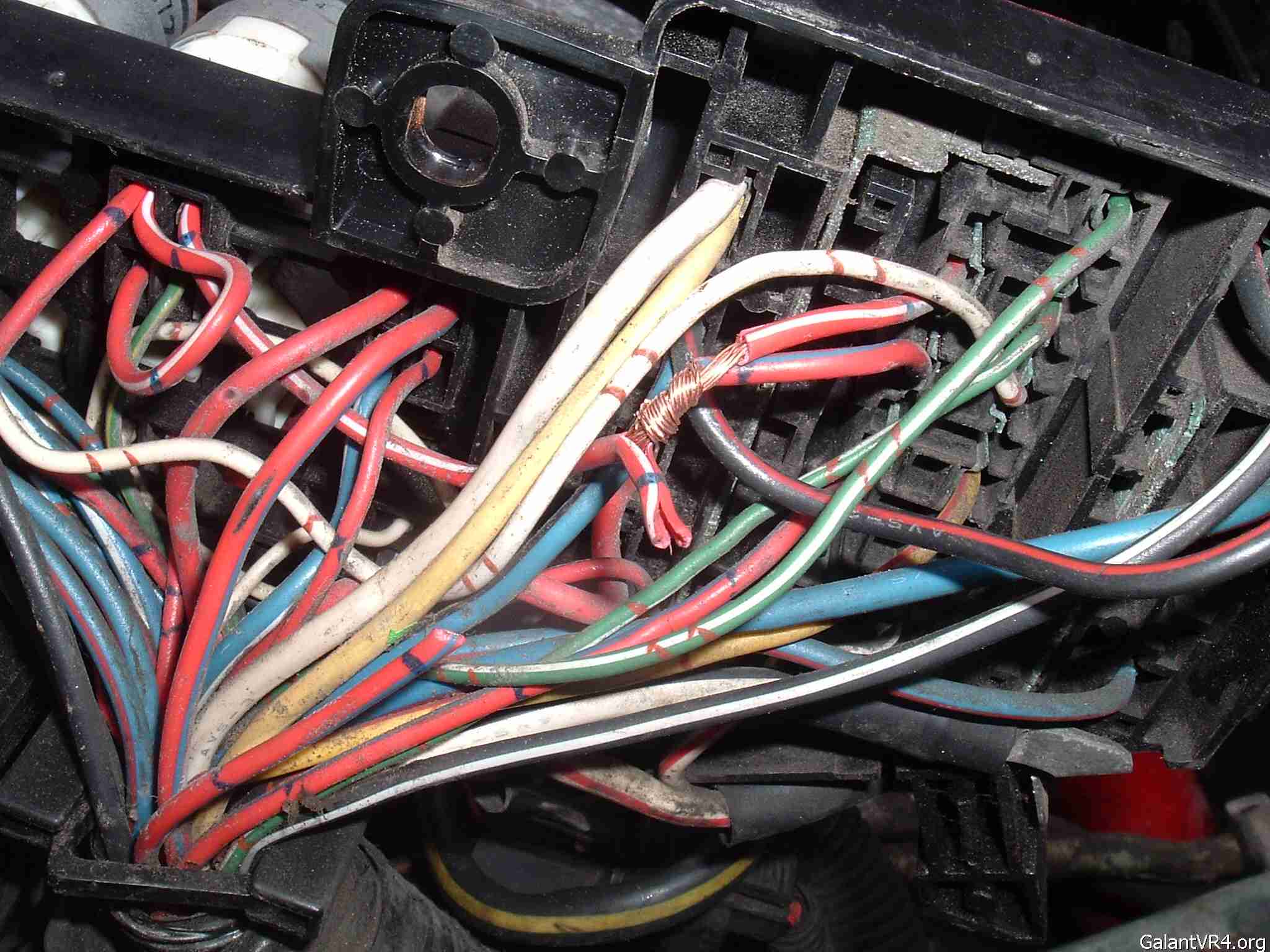

5. I HIGHLY recommend you solder the connection as it carries a fair bit of current and it is outside in the elements. It should look like this when you're done.

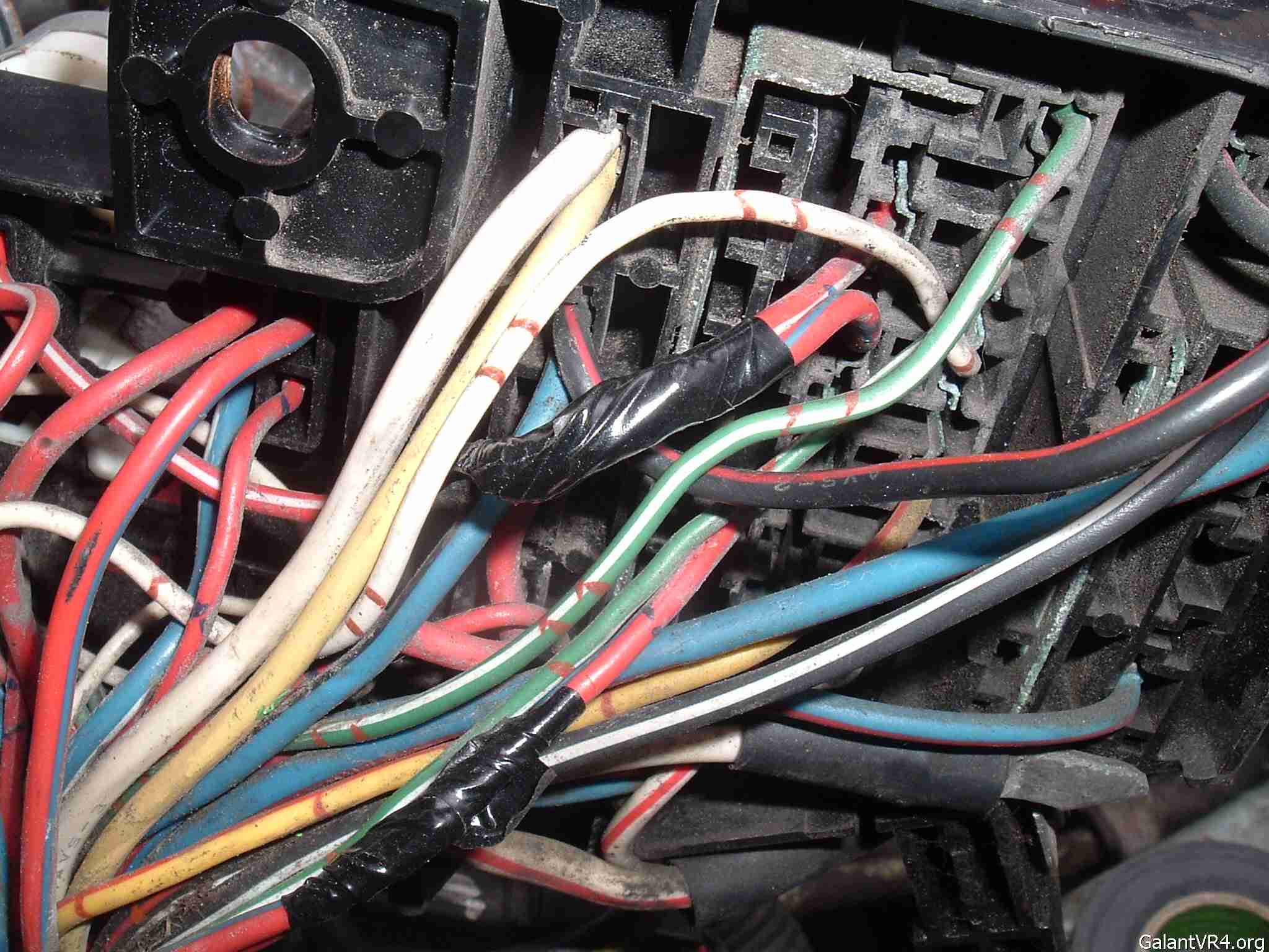

6. Tape up the wires thoroughly and remember to tape the loose end of the red/blue wire. The top wires you see taped in the pic are where you just soldered the two together. The bottom tape was just a convenient place for me to tape the red/blue wire to another red/blue wire so it didn't fall down and rub the wheel well.
