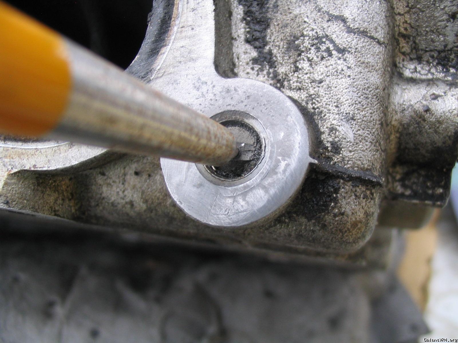

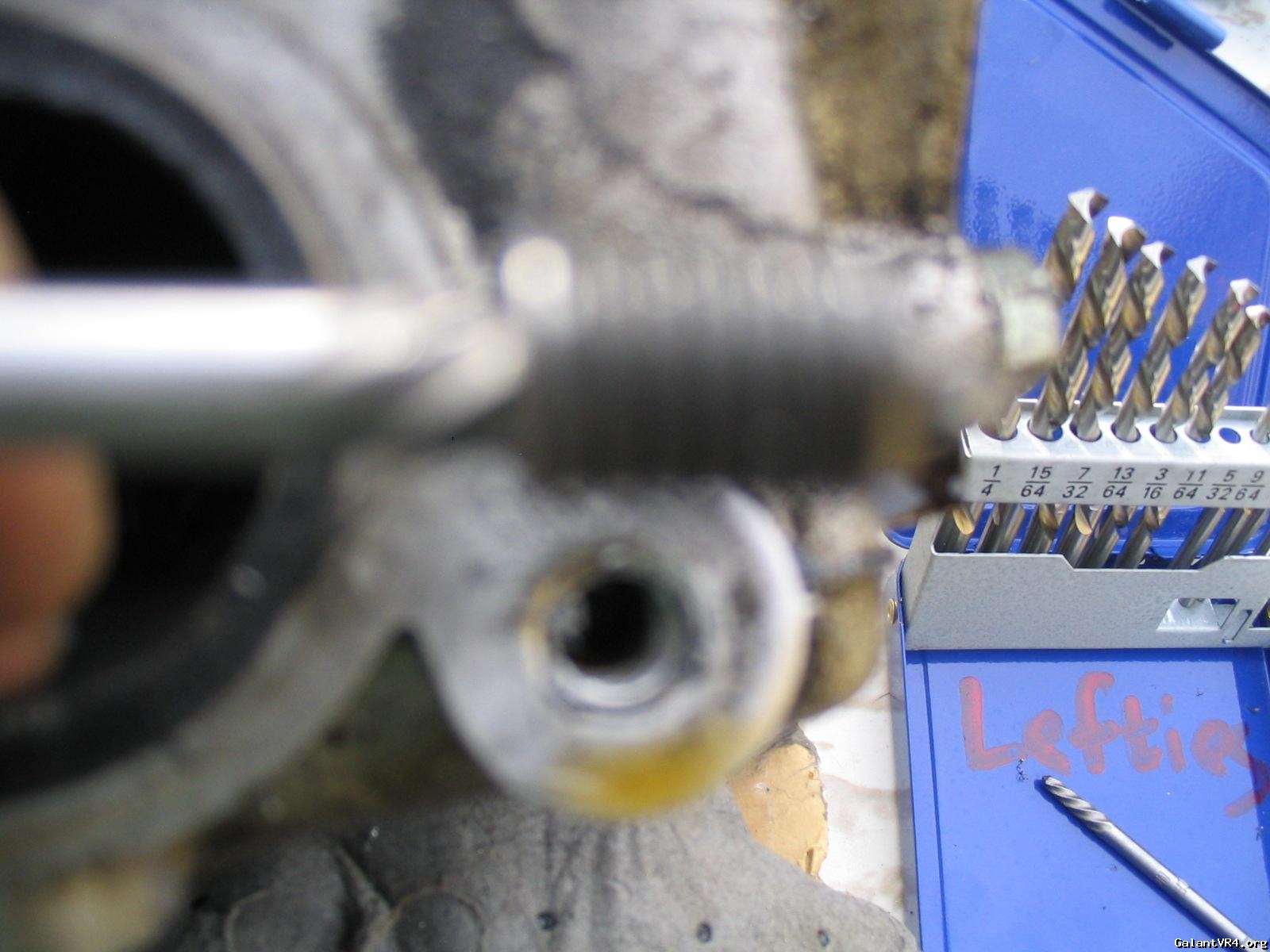

Notice the little buggers always break just below the surface, and usually at an angle.
Center puching the exact center will give us a place to start.
Did I say the exact center? .... /ubbthreads/images/graemlins/rofl.gif ...
It may take a few shots to make a starting point, but now is the time to pay attention. You will be basing every step after this on the center point, so time spent here will pay great dividends later.

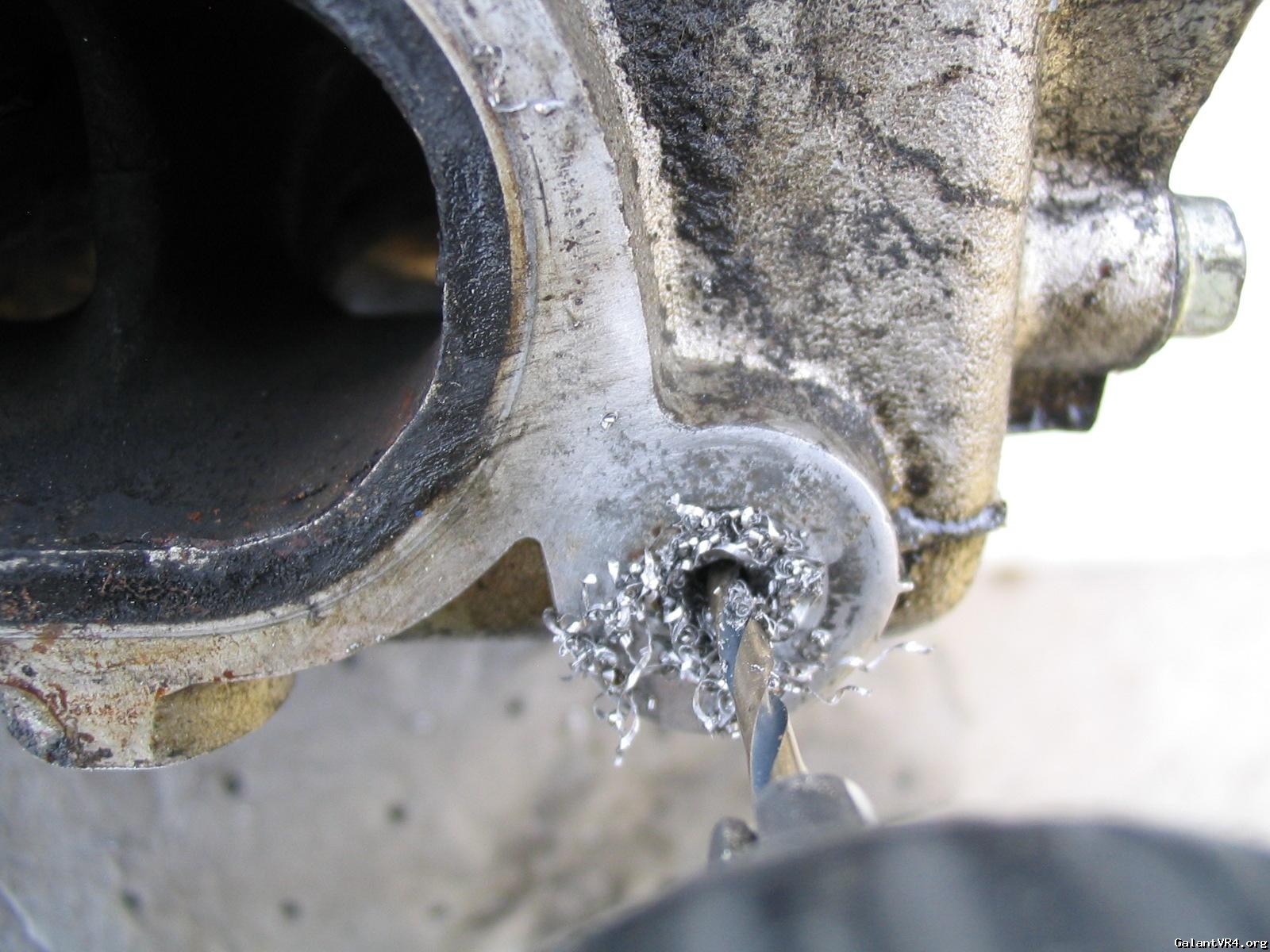

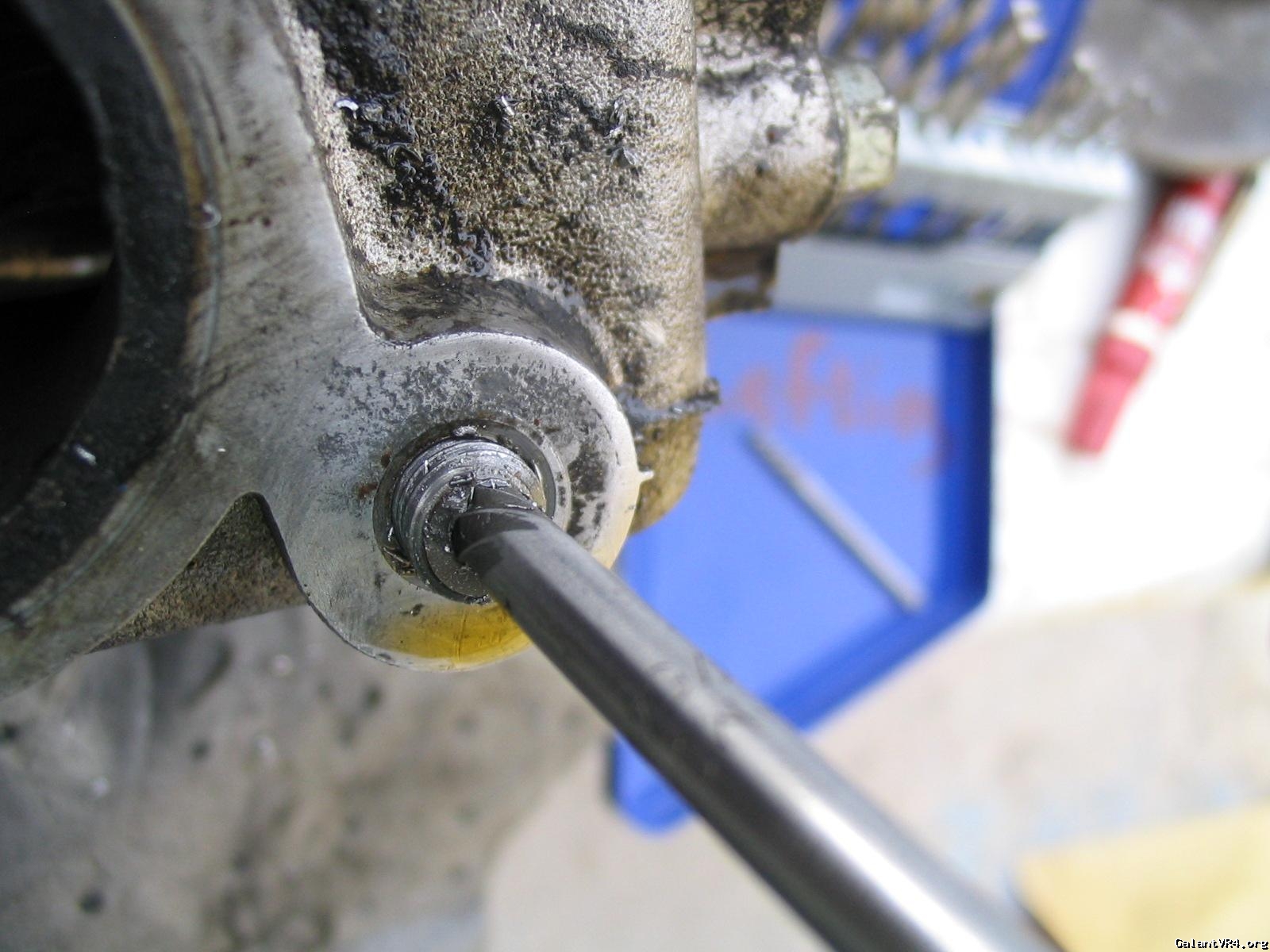

Drill a small, short hole with a 1/16th's inch bit.
It doesn't need to be deep, just on center.

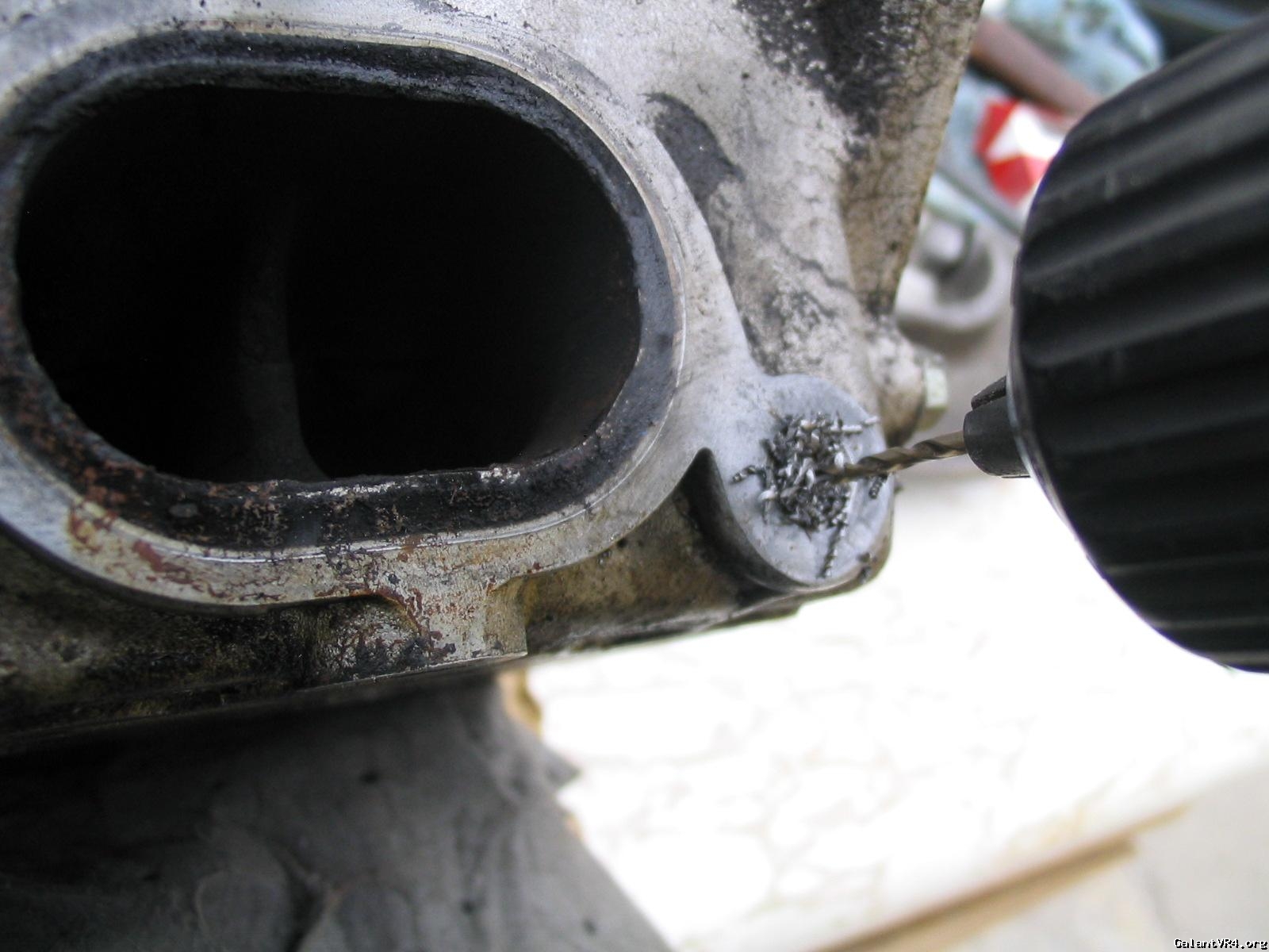

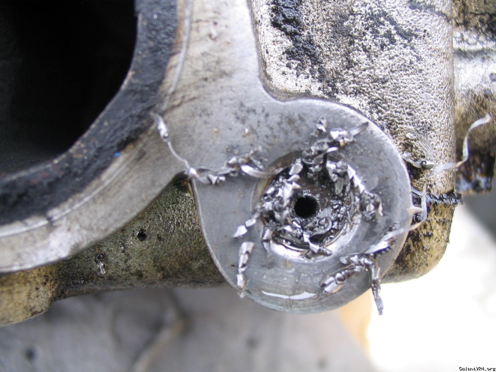

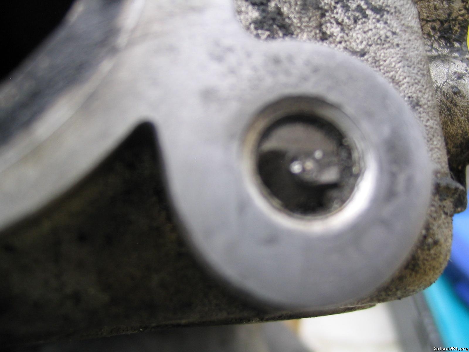

Fill the hole with lubricant, and drill all the way thru the stud with an 1/8th inch drill bit. It will relieve some of the tension, and also allow you to get penetrant to start working from the inside.
A good drill bit, some lubricant, and the shavings should look like this. If they come out blue, you're getting things too hot, and run the risk of killing the cutting edge of the drill bit. Taken to extremes, this will result in breaking the bit when it won't cut and you start pressing too hard trying to get it to cut.

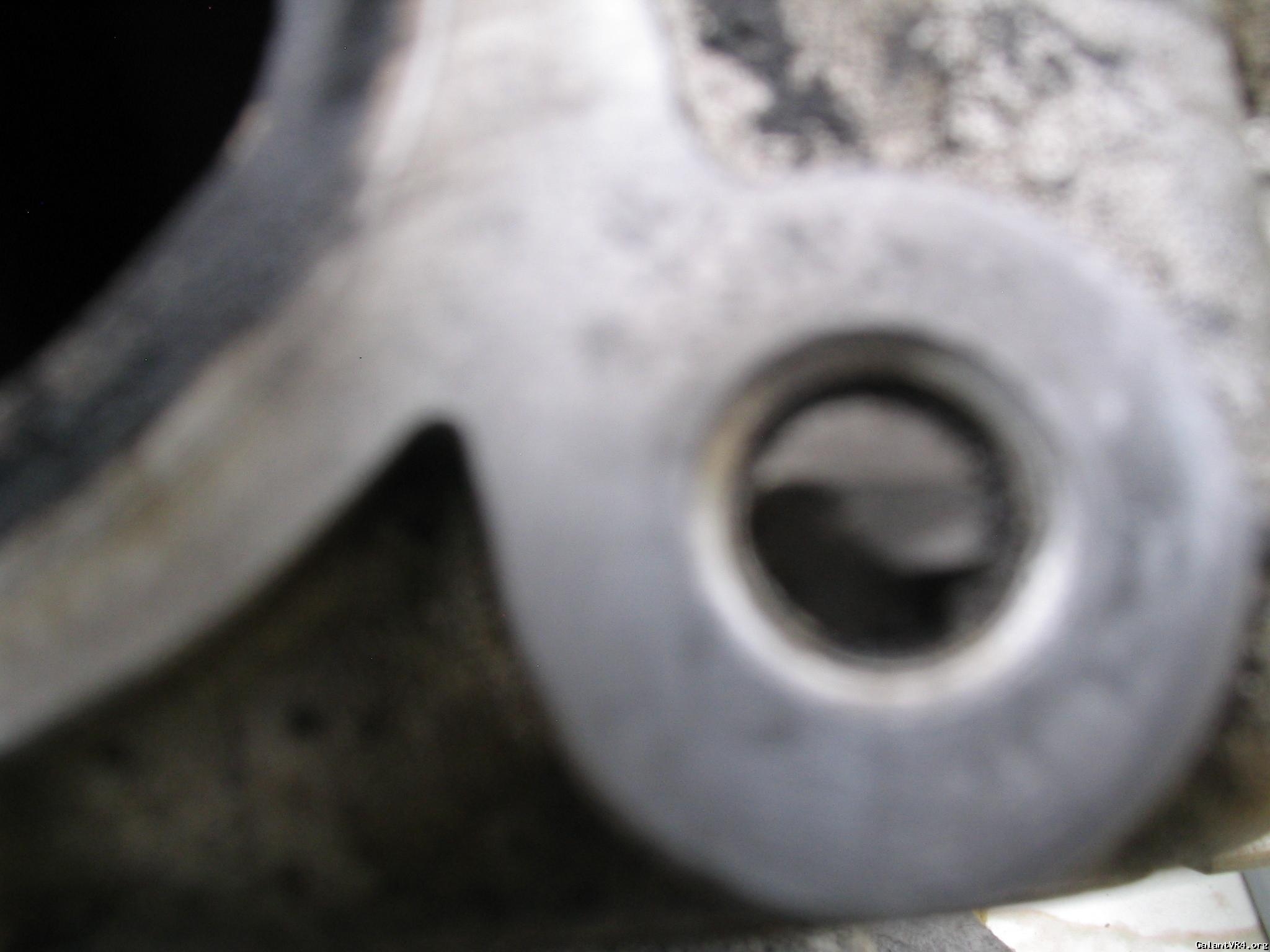

Once I get to 1/8th inch, I start using left hand drills.
I usually go up in 1/16th inch increments, and most of the time, the broken stud will back itself out.
Sometimes, an extractor is needed.

If the drill bit won't cut, get another that will. You should get curly cue chips when you're drilling at the right speed and feed. (like in the pics) I buy quality 1/16th and 1/8th drill bits in bulk, ten at a time and just pitch them when they don't blaze thru the workpiece. Lifes too short to be drilling triangular holes in slow motion.
Done right, most broken hardware will come out during the left hand drill phase, and you'll rarely need a thread extractor.
