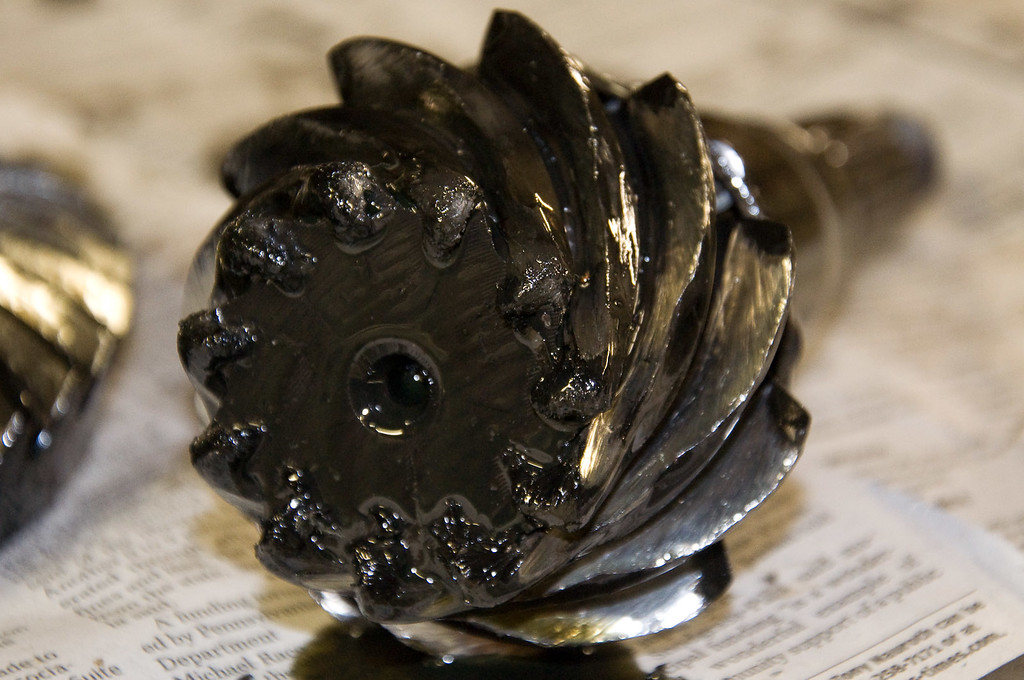

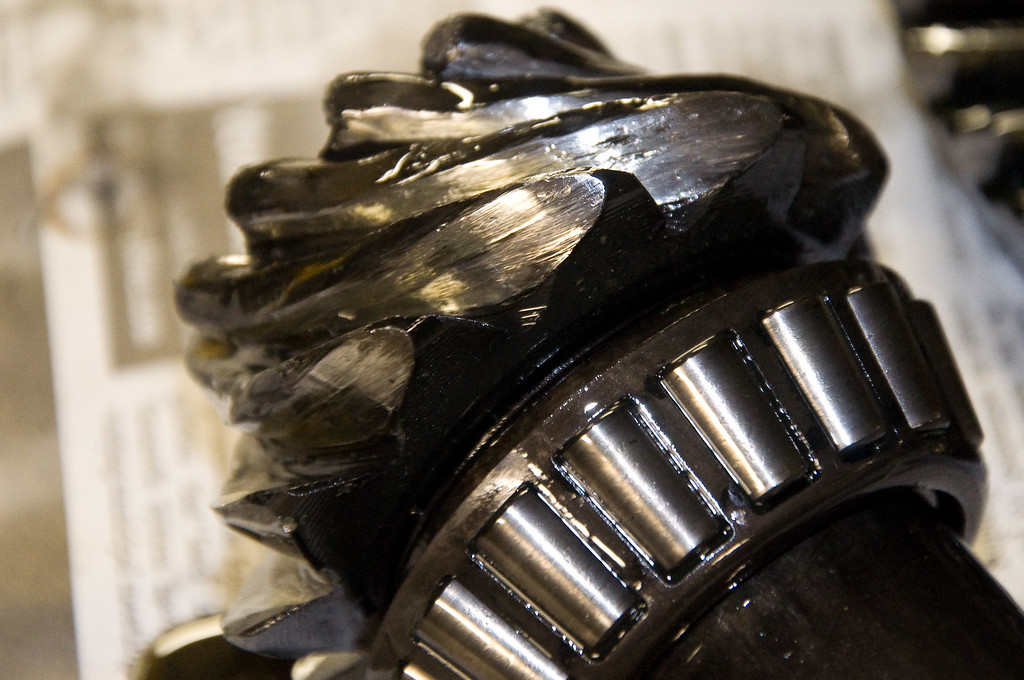

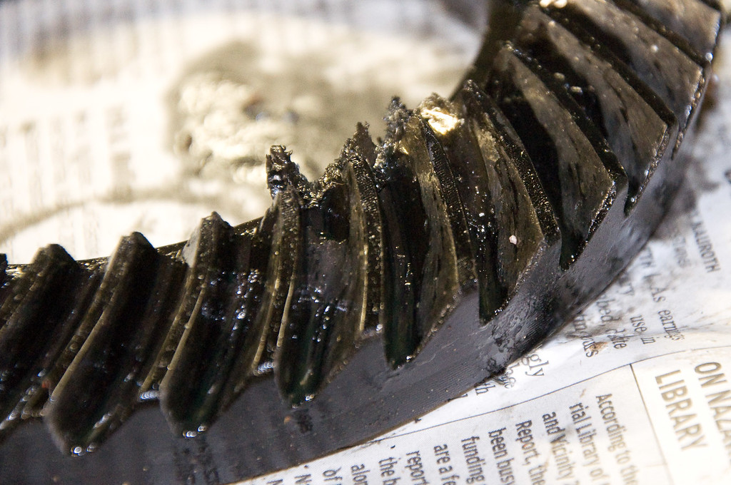

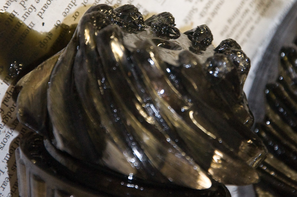

GTluke is the best. He came up tonight ad brought some parts: a good ring and pinion gear & lsd carrier.
I pulled the 4bolt out...holy crap: I MELTED the pinion gear. It was SMEARED into the ring gear.
So we get all the junk out of my 4bolt case and clean out all the metal shavings and knock out the bearing races.
We take his good pinion gear with good bearings and install it in my case, then find out his carrier is a 3 bolt one for smaller axles...no good.
So we take his good ring gear and put it on my smelly 4bolt carrier/bearings. Somehow the side bearings still were totally fine, not chipped and still smooth.
We ended up using Luke's good pinion gear, ring gear, and pinion bearings with my existing 4bolt case and lsd carrier. hopefully this "home brew rebuild" will hold up for a while. Luke gave his stamp of approval on the gear mesh and pinion bearing drag, so I'm crossing my fingers.
Will stick the rear and axles back in tonight and go for a test drive (with gear oil this time):biggrin:
