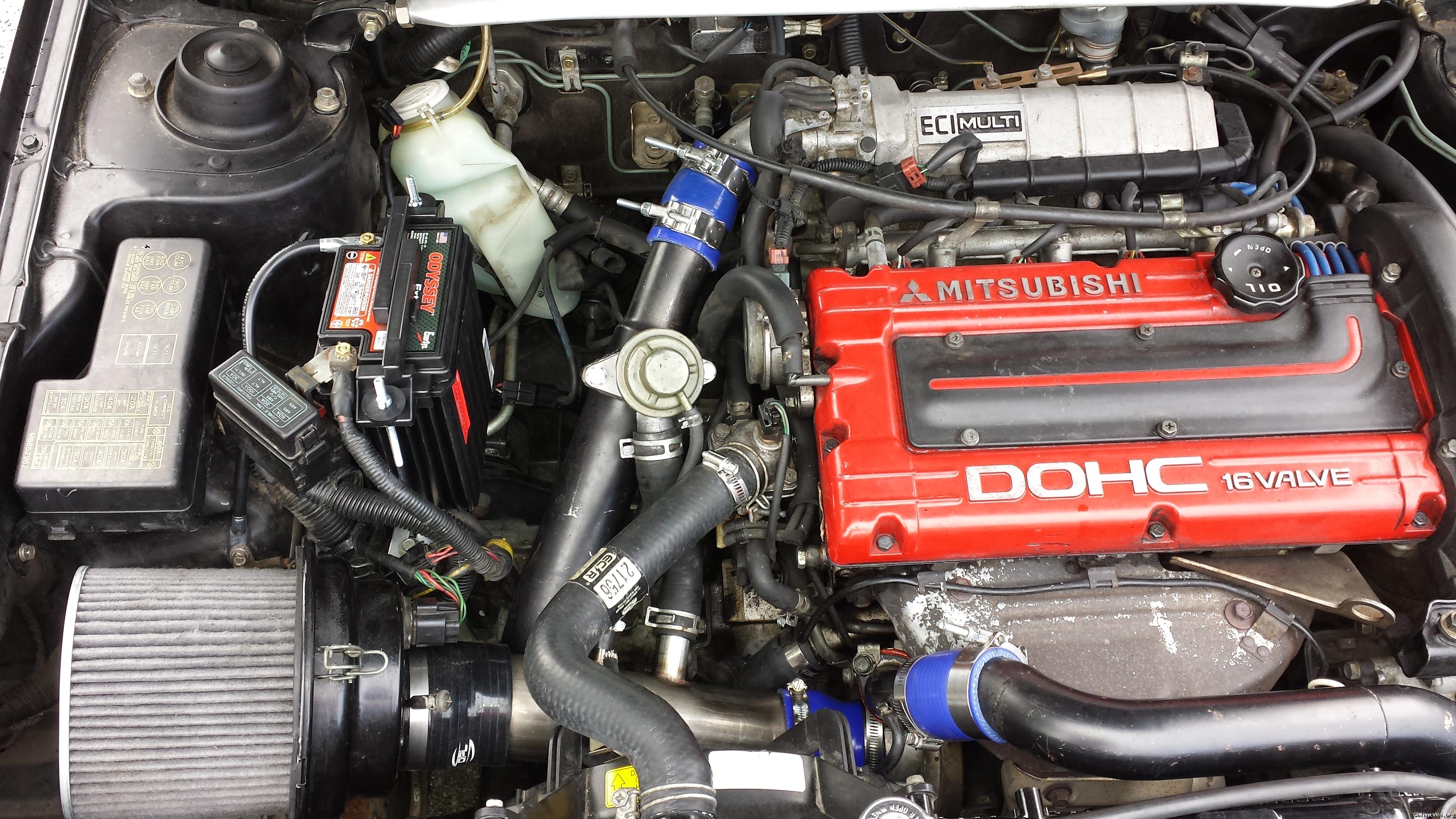

Mind you that the car is rather loud. Before I did the dodge mod, I was getting very noticeable flutter when the valve would open. After the dodge mod, the flutter is gone. now I'm not saying it isn't opening. It's perfectly possible I wouldn't hear it. That being said, are there symptoms I can check for of a BoV that doesn't open? The car runs, boosts, and idles just fine.

I have the dodge mod with ecmlink controlling it. Under light load I hear it very well. Under heavy load and quick shifts, I barely hear it. Currently using a 2.5in steel intake with no MAF. Running a S16g at 22psi. There's a lot that can change the sound of the valve.
I think with yours since you have it venting through a 180 bend, that might be absorbing noise quite a bit.

yeah, this is why I'm asking. I'm running around 24psi and I don't hear a noisy pssssh. That being said, I don't hear a scream or screech from compressor surge either. Might just not be all that loud. I have a partial hard-pipe, but a full pipe would certainly be an improvement so I don't have hard rubber elbows.

I should say that it dawns on me that I know my BoV must be working since it literally blew off the old dump hose. You think I would remember that thread since I'm the one that wrote it....

I've got a T3-T04 w/ a .62 clip, 2g MAF, big K&N, custom 4" hard pipe w/ welded recirculation pipe, hard rubber intake bends, a recirculated dodge-modded 1g BoV (not crushed), ETS FMIC kit w/ all hard pipes, and I'm running 24psi as well.
I'm not hearing the woosh, but I"m also not hearing the scream or flutter of a compressor surge. I'm wondering if my recirculated setup is simply not as loud as the rest of my car at-speed. Like I said before, it blew the old rubber recirculation hose off, so I must assume it's doing something...
