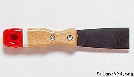

I do this daily at my garage.Get a paint scrapper
apply duck tape on each side of the blade,but put it on the edge of the blade on both sides,spray the decal as your scrapping it with hot water,go slow,once it's off there should be hardly no glue left,and if there is goo-gone works,or a heat gun does the best.
