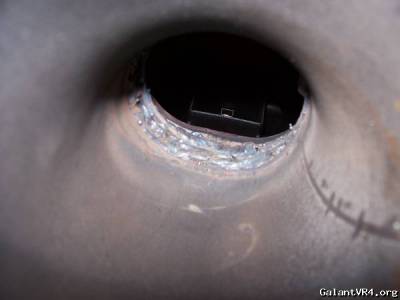

I plan on removing all ic piping and doing an inspection and cleaning. I have a vertical flow IC so would you think it would still be in the bottom of it or did it already make its way through the engine? Haven't looked at the hotside yet, I guess that will show if it did. Man I am so bummed this happened. I only drove the car 20 miles. Thats usually my luck.

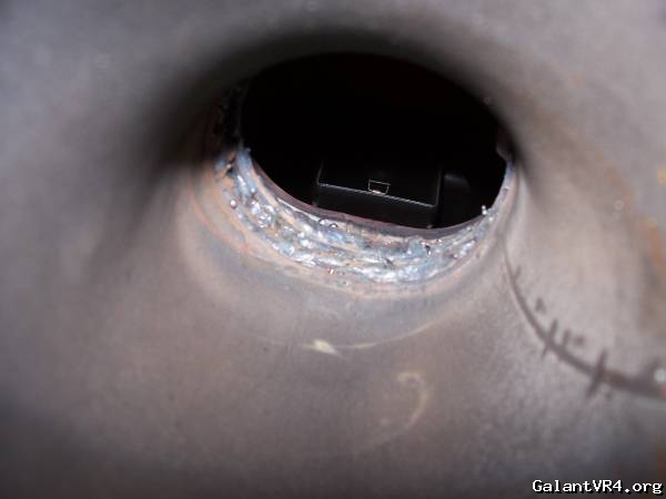

Looking at that intake piping, its no wonder it kills the turbo. Don't put another turbo on that car till you do something with that intake piping. Big difference between someone knowing how to weld and someone knowing what to do and not to do when building something that will go on a car's induction system. You should make the guy who build that intake piping pay for the cost for the turbo repair. There is a consequence for every action. I hope the imbalance isn't too bad causing your shaft to be bent out of straight as well.

The previous owner installed/welded the intake (I think). I didn't even get a chance to find the problem because I ONLY DROVE THE CAR 20 MILES. I am pretty much SOL on this one. I have another intake and I am going to throw a stocker turbo on for now. It not like the previous owner going to replace it for me anyways.

Take a look at that weld job.
Holy crap, that's the problem right there. My first welds i ever did were never this bad. IF they were this bad, there's no way i'd leave it in its current state in my intake pipe. You definitely had small metal fragments from those welds jumping around on your compressor blades.
Hopefully you can get by with a new wheel and a balance.
