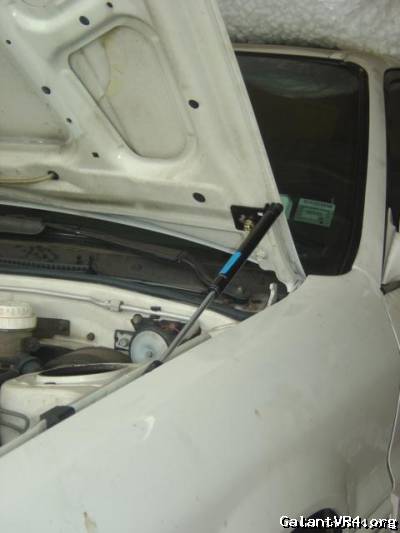

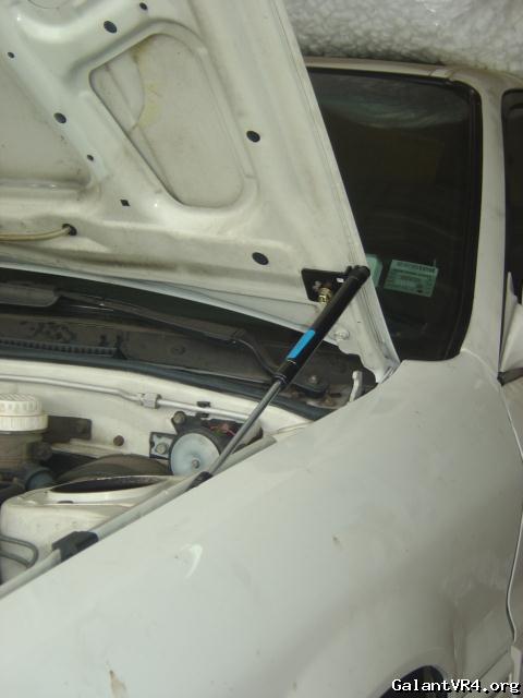

Installation is easy. Takes maybe 15mins.

You won't have to remove the fender. Good quality hood struts. Don't see a problem with them.

You just remove one of the bolts that hold the fender on. Replace it with the ball mount bolt and then snap on the strut. Done

I really like having these on the car too. Before I was working around the hood prop and it was always in the way. Which I am sure you guys know the feeling. Great to have them on the VR4.
