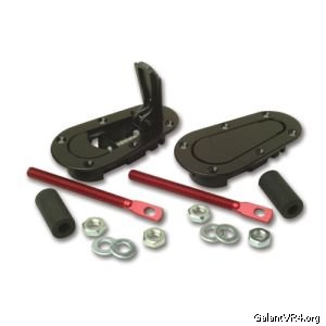

I found these bonnet ... sorry /ubbthreads/images/graemlins/grin.gif "hood" pins on Demon Tweeks' site
The description is as follows:-
The Aerocatch is a new design of bonnet pin, available in locking or non-locking versions. There are two types available; Plus Flush and Flush. The Plus Flush has a 2.5mm thick flange that mounts on top of the panel, the Flush mounts from underneath leaving the panel completely flat on the surface. Made from glass filled nylon and stainless steel, the standard finish is black, but they can be easily painted to match bodywork. Strike pin can be used through the base or side, making them suitable for bonnets or boots. SVA compliant. 126mmx69mm.
According to my snail mail catalogue they do make a locking flush version in the black. Seems to be a pretty nice kit for a carbon fibre hood.

Those Aerocatch pins seem pretty slick but then again $52.77 US (29.95 GBP) for the non locking version and $59.11 US( 33.55GBP) for the locking is pretty steep.
Although the Top Secret version is a bit more; $182.00 with locks $162 without locks. Aerocatch lists TopSecret as one of their US vendors.
SPA Technique is another company listed as a us vendor, I might have to give them a call on those, they aren't too far out of the daily comute.

These are great pieces, we use them on our Audi World Challenge Race Cars, We get them from Coast Fabrication here in Ca. the fit, finish and quality is far superior to anything else on the market.

Yeah I was thinking about that. I doubt you could install the flush version yourself, as it would require the hole to be perfect, not something cut out with a dremel. It seems as though the Plush Flush would be the better option for a home install.
I also can't really see how the flush version (in my catalogue) mounted from underneath can attach to the hood securely since it looks from the pictures as if it is actually secured to the hood on it's underside. That would make the whole thing as strong as the screws holding it to the carbon fibre ... /ubbthreads/images/graemlins/uhh.gif
I think if you used some good flathead machine screws with washers on the underside and nuts, it would hold alright; provided you have the adjustment against that 'box', of course...
