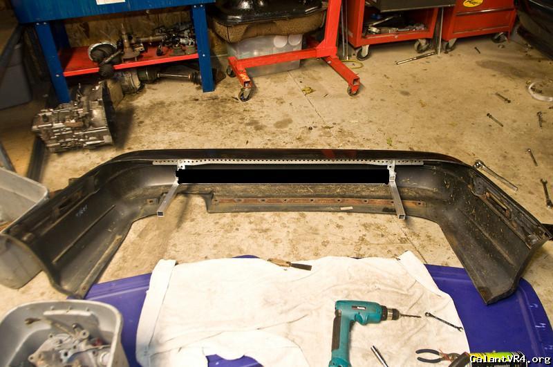

A post I made in a different thread (USDM bumper vs JDM bumper):
To be fair, JDM bumpers are nothing but cosmetics. /ubbthreads/images/graemlins/rofl.gif
You can lose the same 90+lb of weight by taking off your USDM bumpers, removing the giant 40lb steel support beam, the 10lb block of foam from each end and putting the USDM urethane covers back on. Make a couple brackets out of home depot metal to hold up the original USDM bumper cover. This gets you all of the functional JDM bumper weight loss that makes your car faster for about $10 in materials and some elbow grease.
Here is the rear bracket I made..they are less than 2lb for the pair: /ubbthreads/images/graemlins/tongue.gif

This is the post I was referring to. I really like that setup. It is practical and straight forward. Would it be possible to add just a little bit more support to that setup? It obviously holds the bumper up just fine. Just with the kids, I'd want a little bit more support. I know that you side with the idea that the rear bumper makes no difference over 5 mph and obviously very qualified to say that. However, some say otherwise.
Any thoughts? Thanks

Maybe add something like the area in black? Whatever piece of metal in there should be lightweight I am guessing but strong enough to make a difference in an impact.

i dont see the big deal.. look on curtis' thread with the volvo support. I remember someone going and using box aluminium for the support
I dont see why you cant just cut off the stock support bracket "tabs" and get some box aluminium(sp?) and either rivet or bolt the tabs on, and then figure out a way to fasten the bumper to that box...
or just go get a stock galant bumper cover, they can be made to work they just aren't as pretty.
I don't remember seeing someone using the box channel. I think Curtis suggested it. Good idea on cutting the bracket tabs off. What would I need to cut them off with? Again, the stock galant bumper cover is hard to get around here. I would rather kill myself in my yard instead of driving a few states and burning up gas. Our junkyards are massive and yet have like 10 mitsus in them on average. You can bet there won't be any Galant of any trim in the yard.

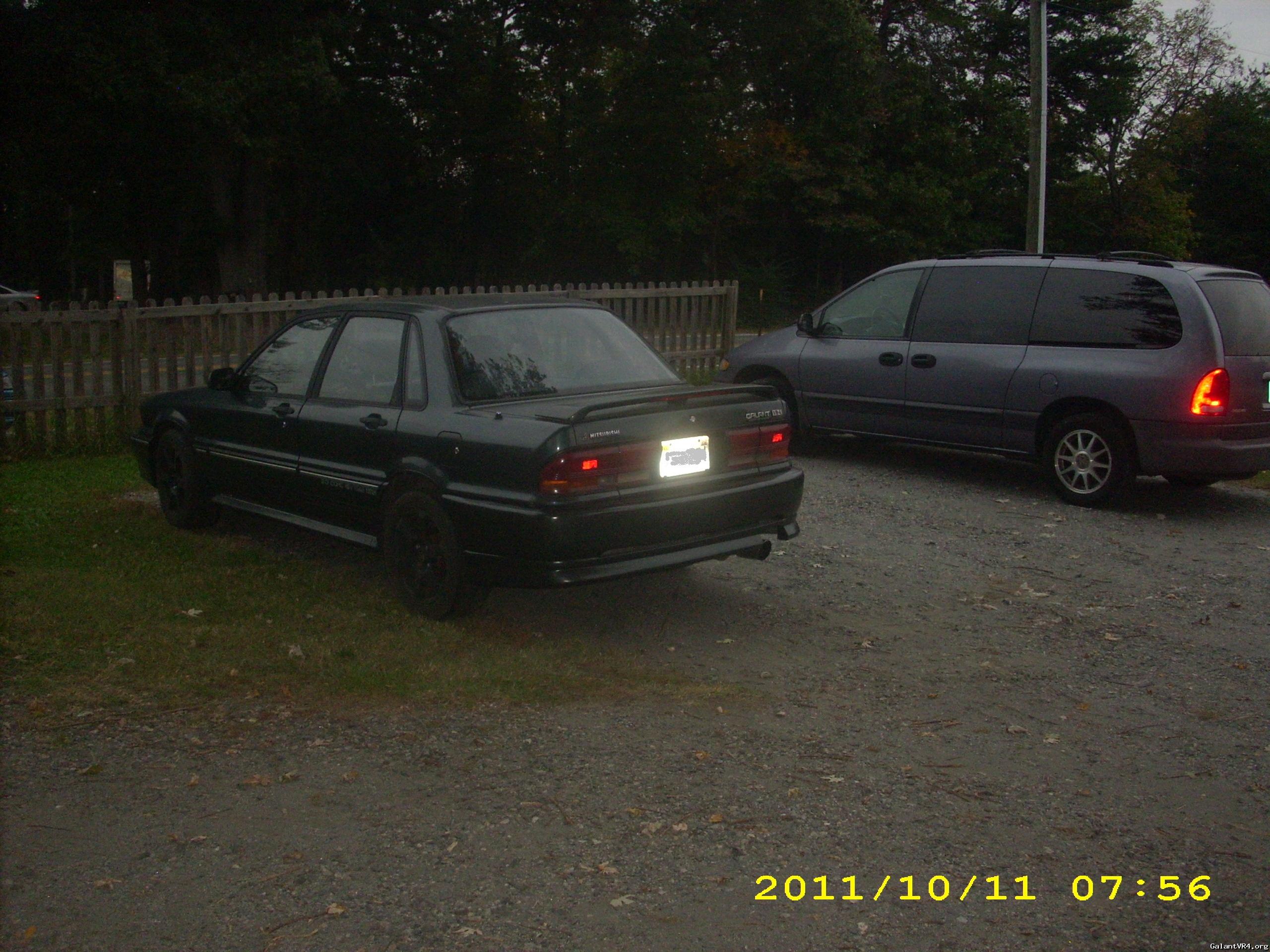

Finally got this done. Cut the stock brackets off, ground them down to bare metal, and brushed them down with Ford corrosion inhibitor. Added some brackets etc, etc, etc. It took me about 2.5 days of nearly non stop work to get it all right. I hope that I don't have to go through this again for a LONG LONG LONG time. I left the muffler tip angled a bit low to avoid the hassle of melting my bumper again. I used 3 rattle cans of BG basecoat and 3 cans of clearcoat to ensure coverage. I am happy with the outcome.
Here is a pic...

That actually doesn't look half bad,although the pic is kinda dark.
