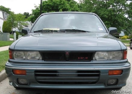

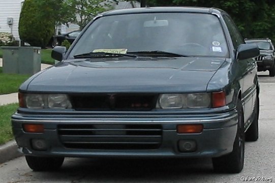

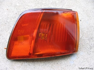

I just got done finishing my amber corners. I was going to try and get them from australia or europe, but decided to do it myself. I'm actually a lot happier, because the true EDM ones are all reflective as these are somewhat see-thru. I picked up an extra set from the local junkyard and bought Krylon 9023 orange glass pain from Here.
My total spent was:
corners from the junkyard - 5.00
9023 Krylon paint plus shipping - 13.00 (shipping was kind of high)
Total: 18.00!!!
I know people can get these, but they will cost anywhere from 40-70 bucks.
Here is a pic of the passenger side one.

Nice work man! They look good. How exactly did you get the lense separated from the housing? Or did you just spray them while they were assembled?
I didn't separate the housing at all. I jsut cleaned the surface with alcohol and sprayed about 5 coats on to it. It's a real sticky paint so it take about 20-30 minutes between coats.

I think they look good. SO did you use any clear over the paint? If not over time since they will start having some paint chips and scratches, because they are upfront and you get everything from the person in front of you. You should clear them so they will last longer. I actually like how they look and way cheaper then $70+.

thanks man...I didn't use clear. I didn't want it to look too shiney to look different then the turn signal lenses. The paint is really thick. Almost like a see-thru rubber. It can't jsut be chipped off like the paint on my grille. Like I said I still have the oem ones so if they take a $hit and get scratched I'll just put the oem ones back on. But I truly think it won't be easy to scratch and chip them.

also I think I might be the only one that noticed the full orange lights in the bumper. They match well....+10

Nice work bro! How close of a match are they to the turn signal lights in the front bumper? I've been looking for a set of the amber lights too. Nice alternative to sending $70 on used lights. Could we make this a sticky?
