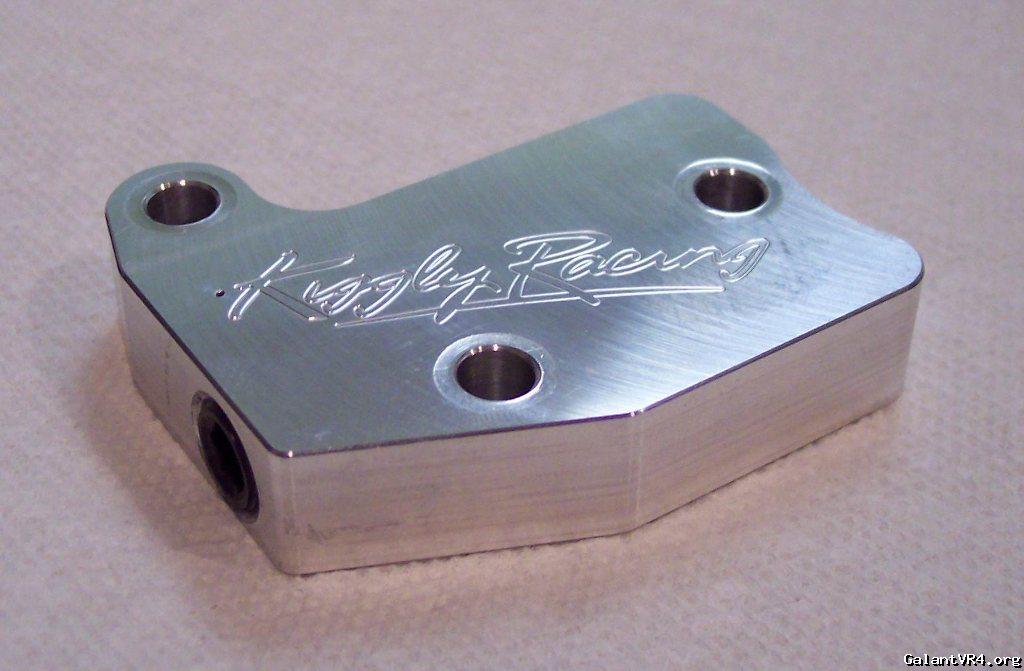

I have not really heard or seen much about these. Does anyone use them or is there really any advantage to them? Kiggly racing sells them which is really the only place i have ever seen them before. Any comments on this?

great piece i recentley installed one on an evo8 motor i just built for a customer. and i will be using one on the vr4. it lowers the oil pressure in the head keeping the majority of the oil in the block for the bearings. makes a big difference. i defiantly recomend getting one if your interested.

i see its keeps the pressure in the head at a constant 15psi. what is the pressure usually in the head without this? im sure it fluctuates and probably gets over 15psi at times.
i was thinking about purchasing one but i wanted to get some comments from some guys using them first

Same here. Will this make the lifters clatter more becasue its running only 15#'s? Understandably, if the lifters have already been changed over to the 3G revised style, it shouldnt matter, but im concerned about the cams also. Just looking fo more info. /ubbthreads/images/graemlins/wink.gif

I have it on my race car, it works beatiful, helps a lot on high rpm lifters problem , tested and approved by c.f.t.!!!!

I have one in my VR4 and AMG.
Kevin has proven his products in his own car so I trust what he sells.
Have you ever opened up a stock distribution block? They are very simple. Kiggly's stuff has an internal plunger in it so it regulates the pressure properly.
The stock ones regulates it by dumping the oil back out into the head/block.
The datalogging of the oil pressures in his site explain it all.

15psi is plenty at the head.
From memroy, when I measured, I had less then 5psi at the head with the stock setup at idle.

it definatly seems like a good product that has been proven to work, but my only other question would be is it really worth the $200 investment? is the stock unit hurting anything or would it be more worth while for the higher
revving and horsepower motors?

With a 0w-30 oil and I get about 7psi of oil pressure at idle, about 15psi at cold start (this is measured at the head close to the turbo feed)
This is with the standard distributor / ported oil filter housing.
