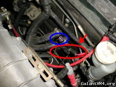

I tried to find that plug under the hood and I think I did, but it was already unplugged, could that be the issue.
here is a pic so im sure its the right 1.

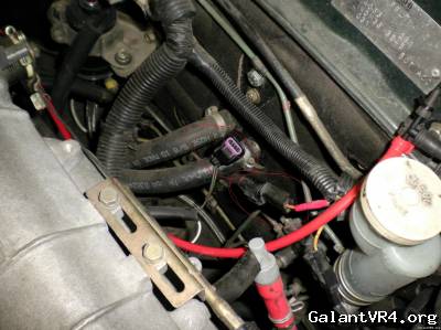

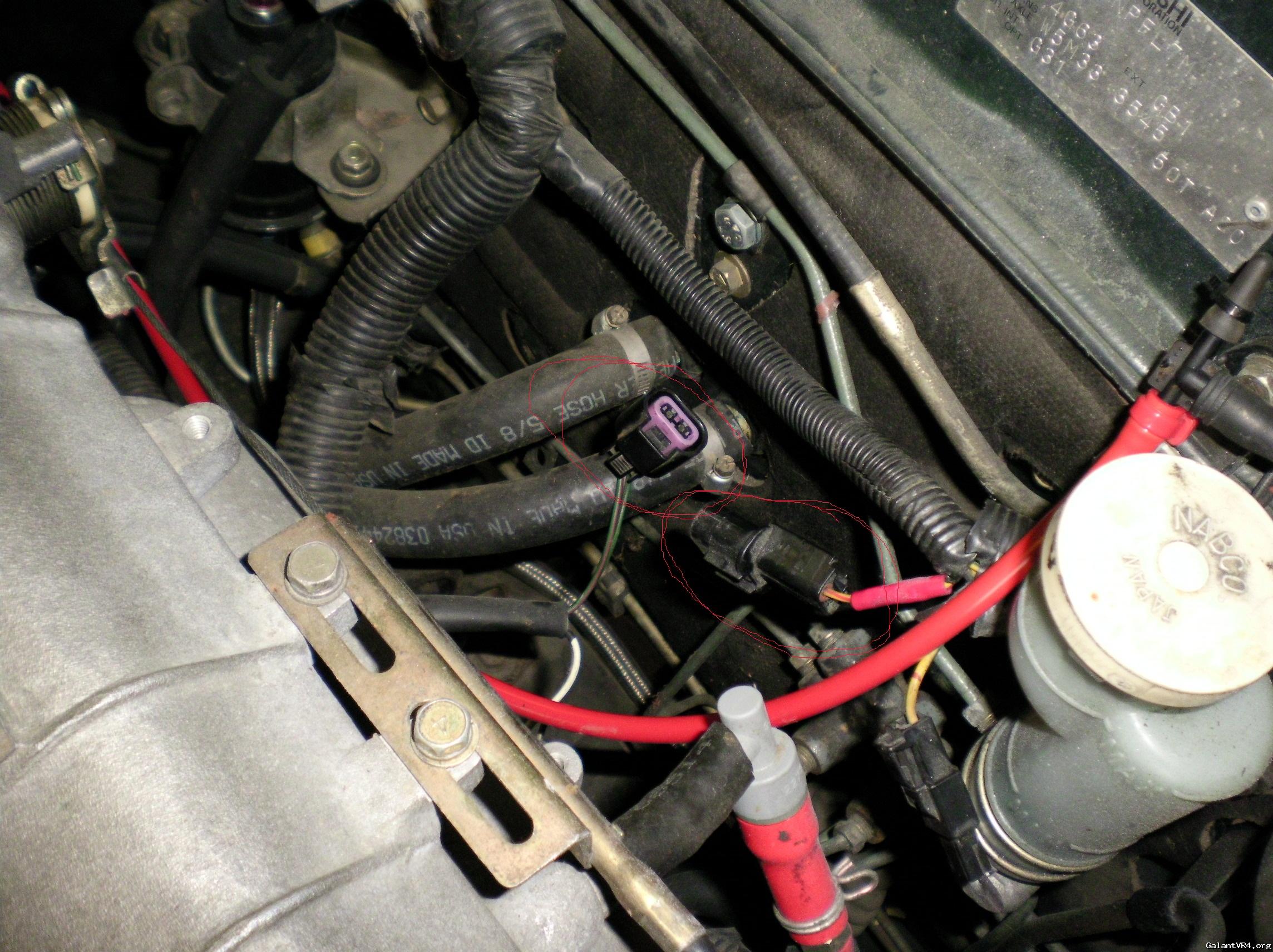

Ok Man,
The one circled in red is the plug you need to ground.

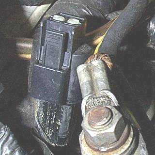

Grab it and look at the top. It will look like this:
As you can see, that is actually like a sorta cap thing on the end of the plug. Remove the cap and you will expose the pins that you need to ground.
Ok, so for the other connector I circled in blue (the 2 pin female connector with the purple center). If my memory serves me correctly this is your BCS (Boost Control Solenoid) connector. I doubt very highly you are using the stock boost control system if your car is modded at all, as this is usually one of the first things to go. Either way, to my knowledge and experience, this won't affect the issues you are having now. This connector is unplugged and lose on my car at home. I would say 90% of the people here are not utilizing this connector, and it's just chillin loose on their cars as well. Someone please chime in and correct me if what I'm saying in regards to this phantom connector is not true...
