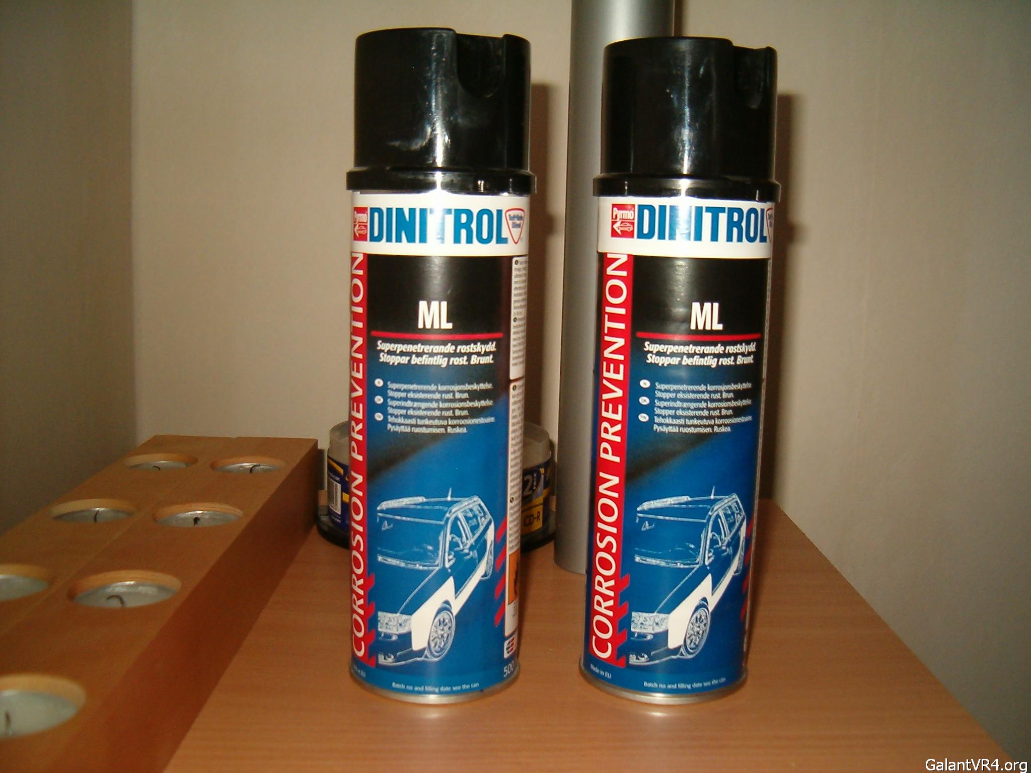

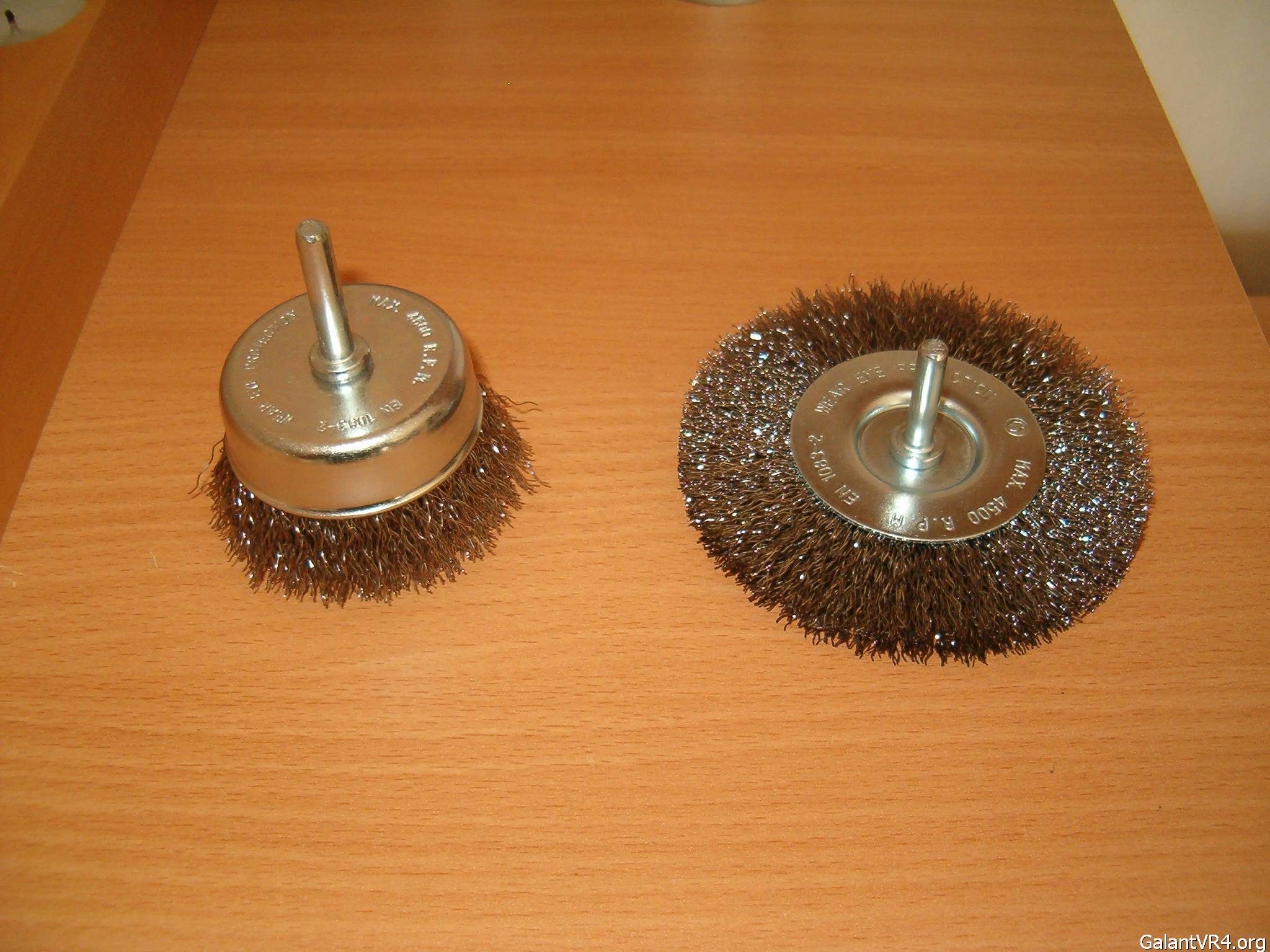

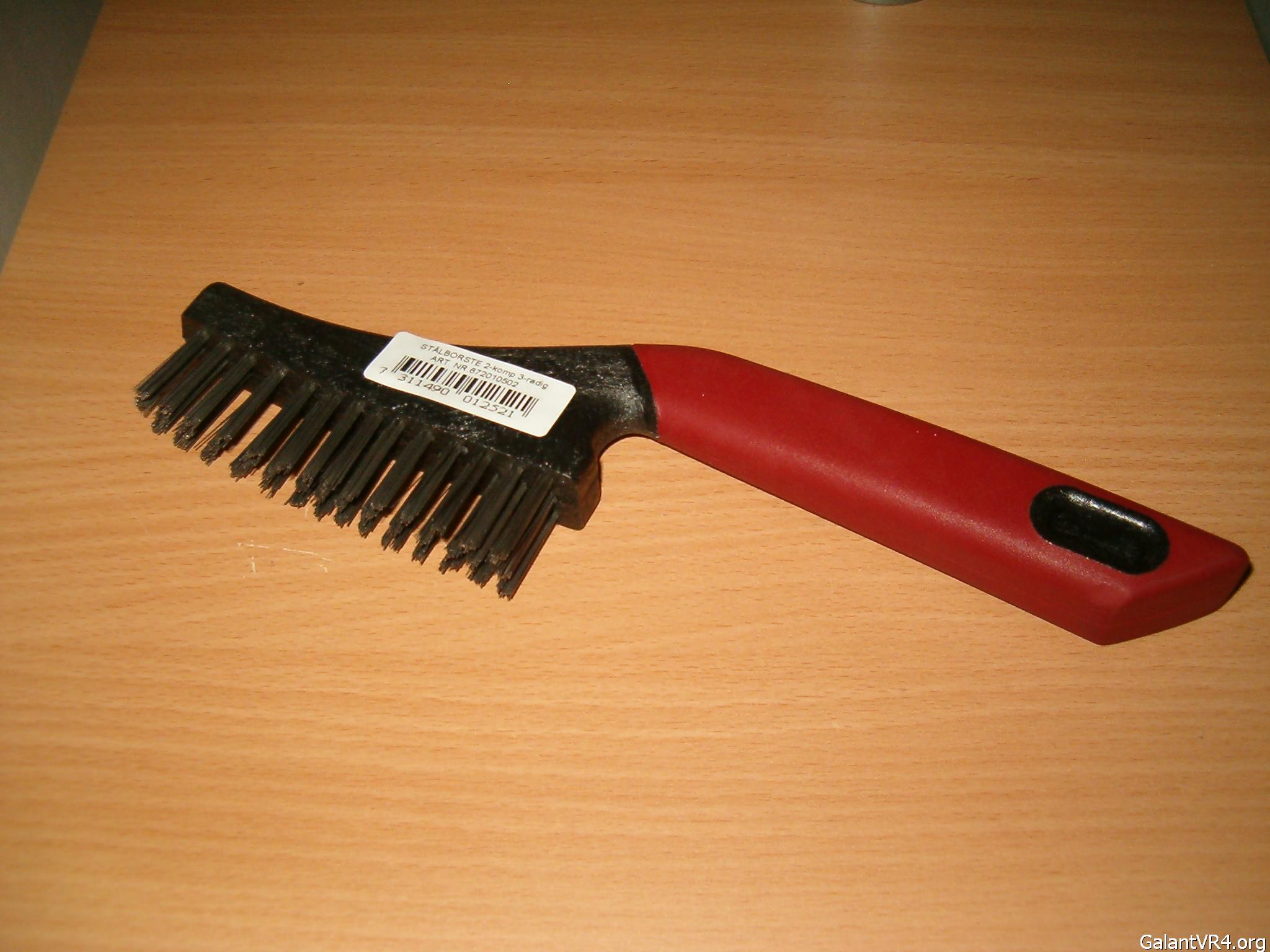

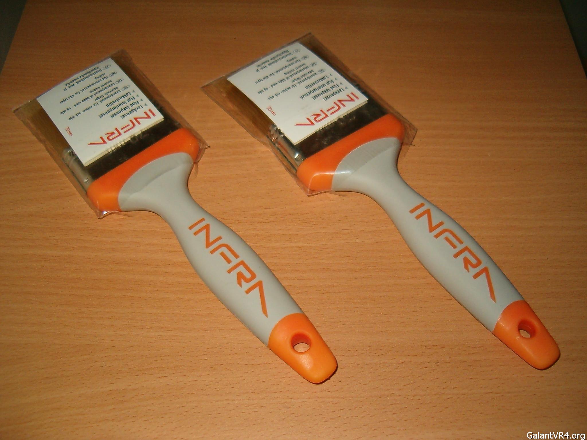

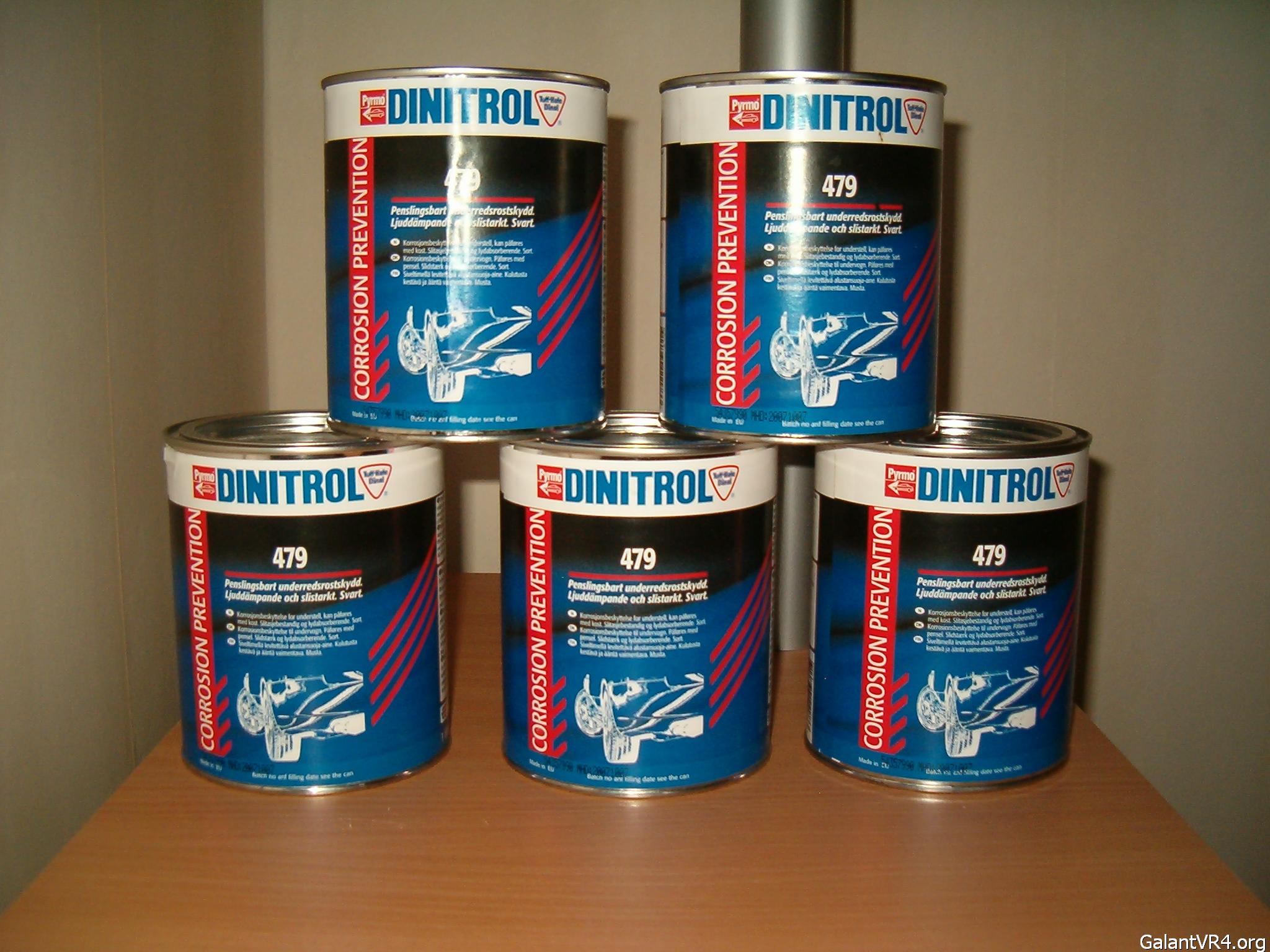

Here are some pics of what i have bought for my car!! /ubbthreads/images/graemlins/wink.gif
As you can see i will add some new rust protection under my car, my car was rust protected in 1995 when it was imported from saudi, but now i have to ad some new protection in the wheel house!!
First i going to take off all the old rust protection in the wheel house and then i'm going to add some brand new rust protection in the wheel house!! I will use the Dinitrol ML as a "ground" protection and then i'm going to add the Dinitrol 479 rust protection on top of the ground protection!! /ubbthreads/images/graemlins/smile.gif
There is no rust what so ever on my VR-4 but i want to add some new protection anyway for safety reasons!! /ubbthreads/images/graemlins/smile.gif
Does some of you guys have some advises about rust protection under the car or something??
