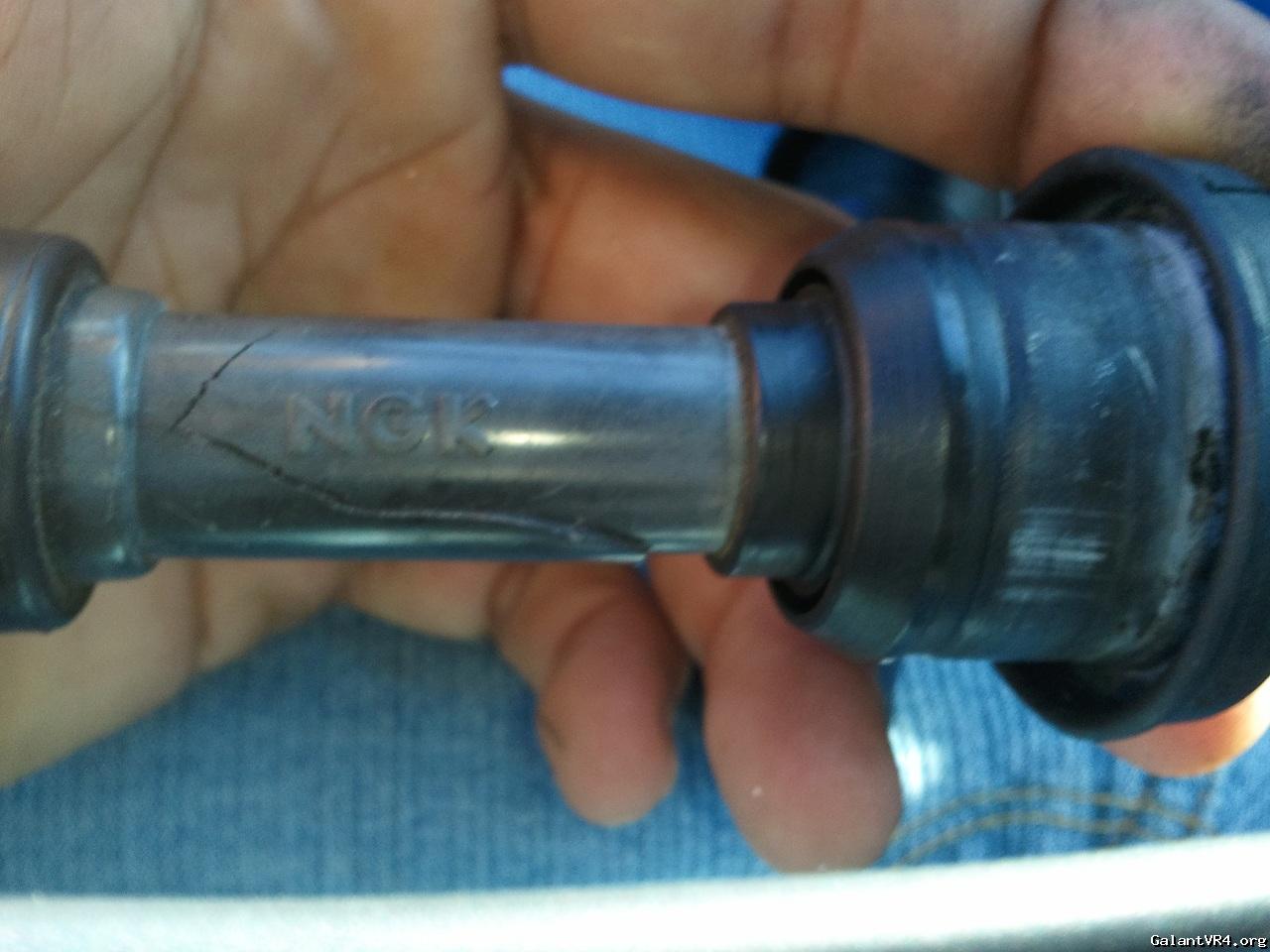

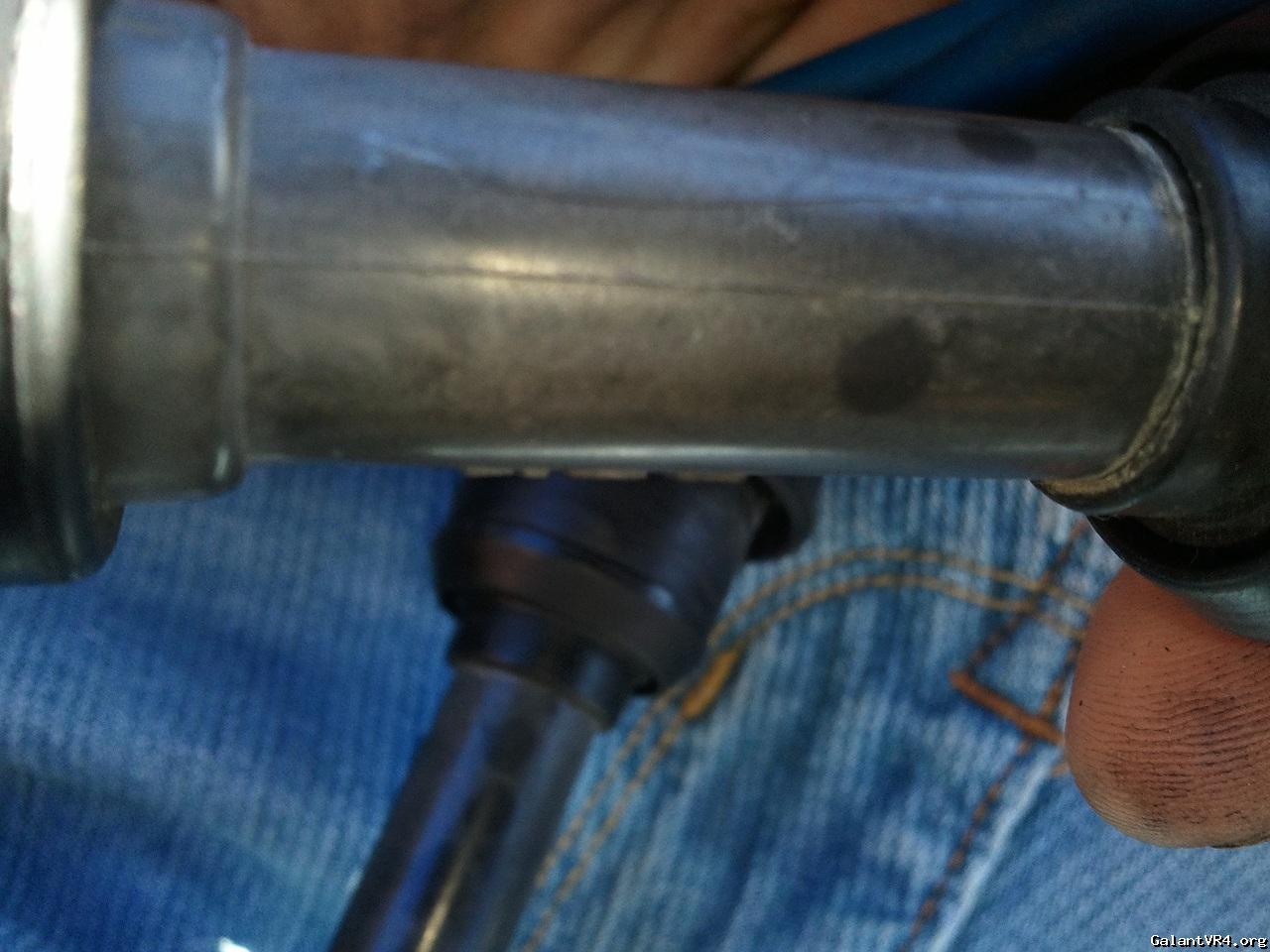

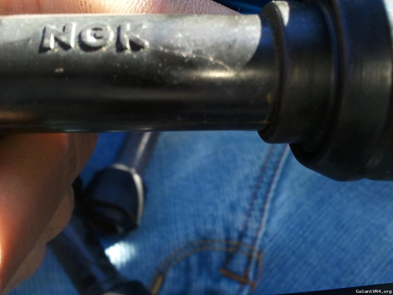

citymunky
Sep 22, 2010
1,761
Chesapeake, VA
The first thing I did was do the Ohms test on the coil pack. Everything was with in limits.
Quoting 496of2000:
Did you try another set of plug wires? i had a set of magnacores that had a pinhole in it where it arched.
Next I poped my NGK plugs wires out, number 4 was good. Number 3, 2 and 1 had cracks along the whole shafts. Problem solved. /ubbthreads/images/graemlins/grin.gif
