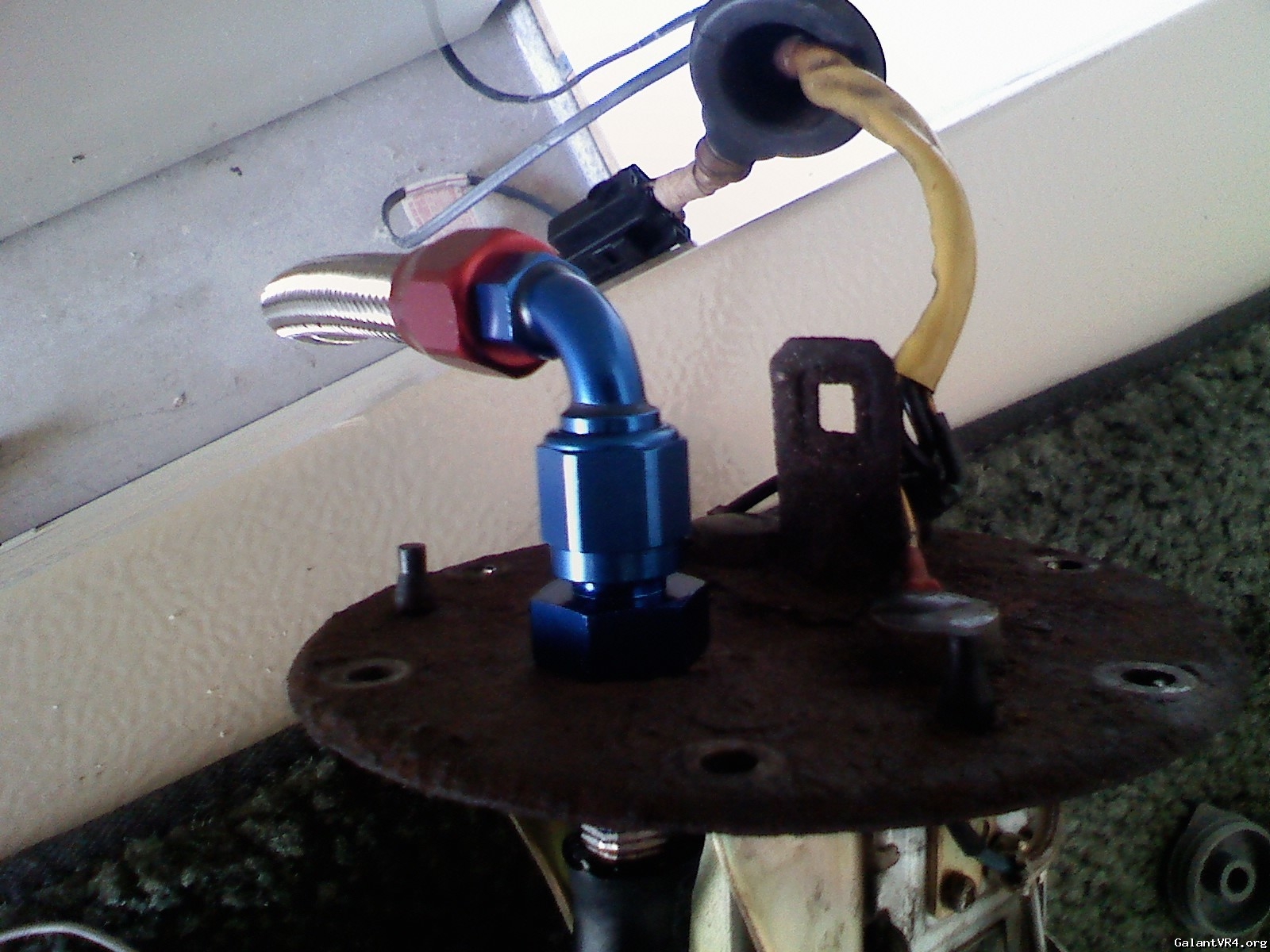

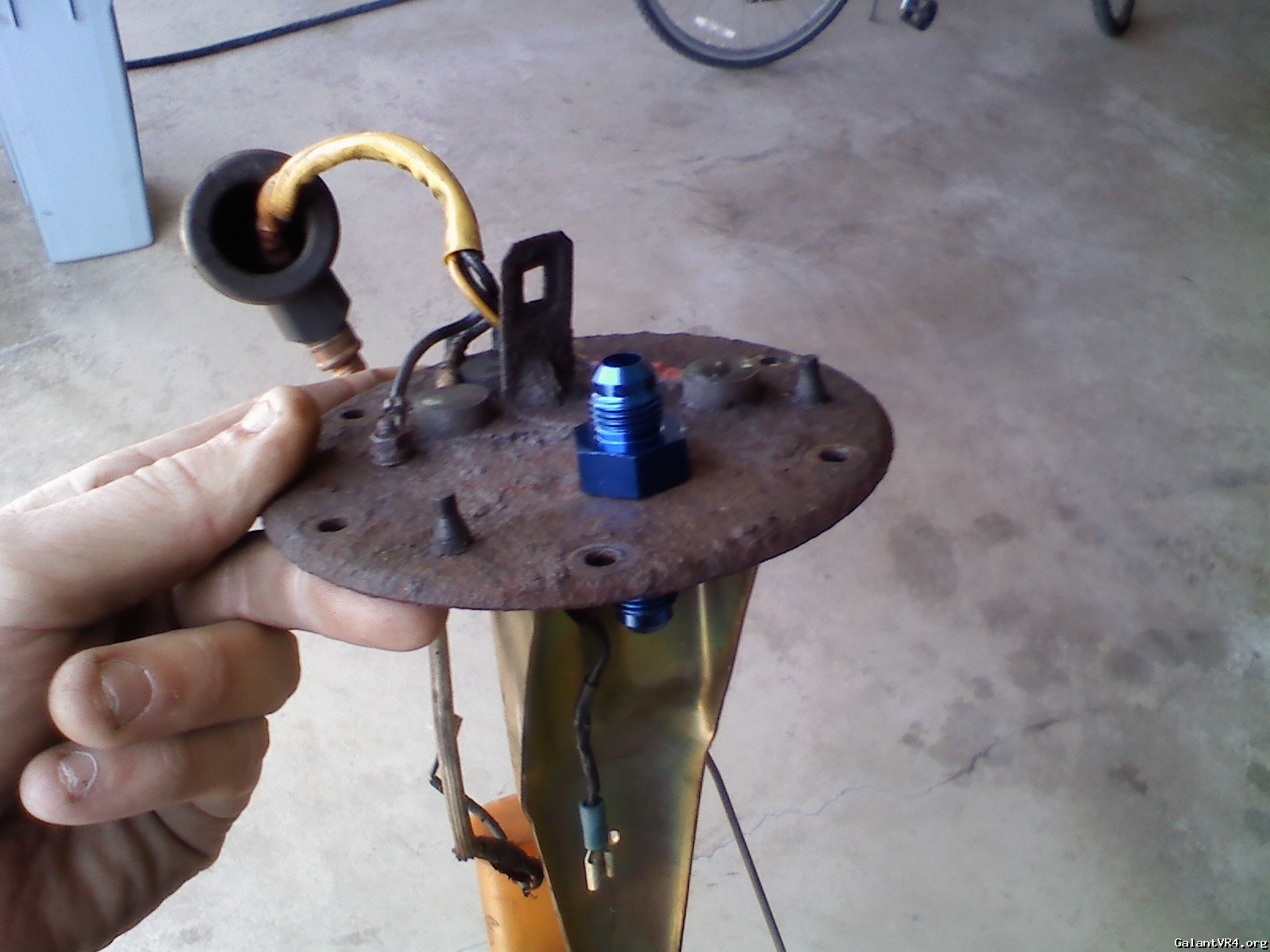

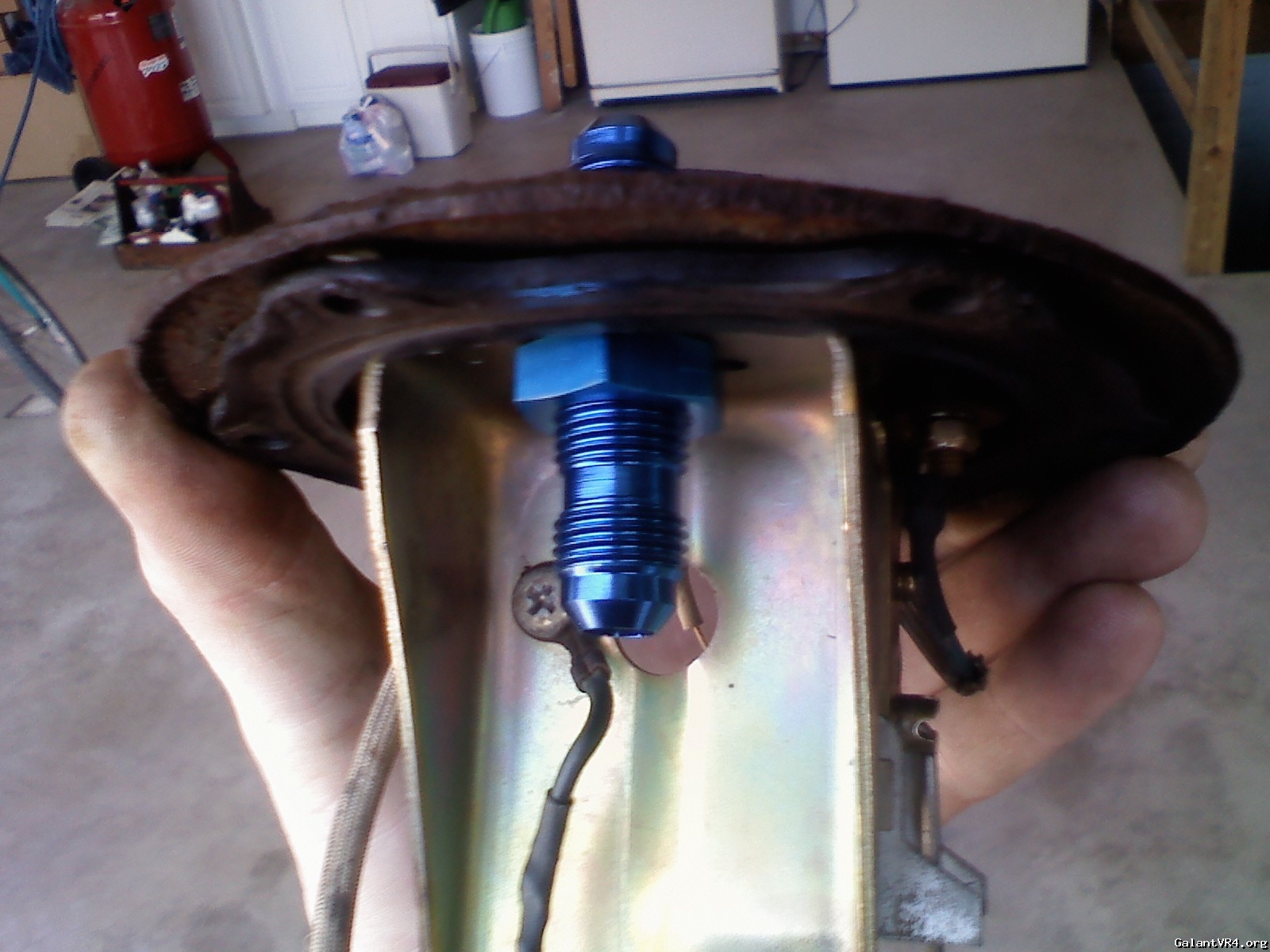

The easiest fix to this without replacing the entire unit is to cut the rest of the line off flush. Drill the hole out bigger and install a bulk head fitting. This way u can run -an line from the pump and then ull never have to worry about getting the line off again. This is what i did and makes life much easier when removing the fuel pump

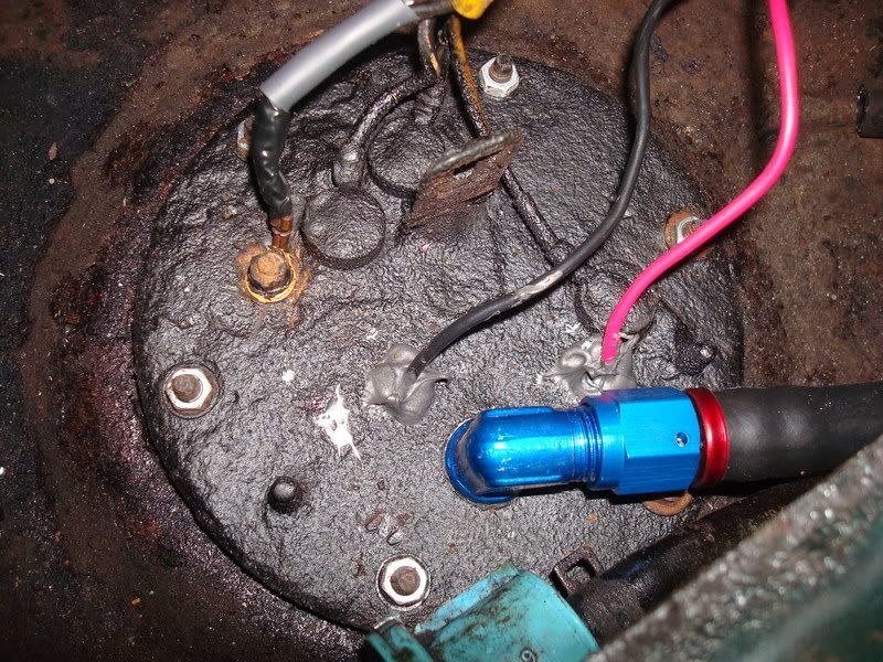

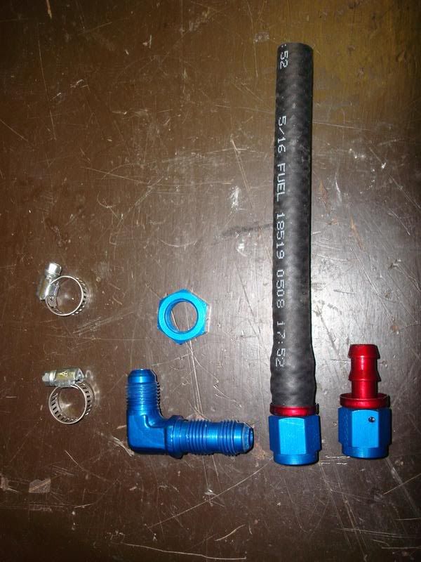

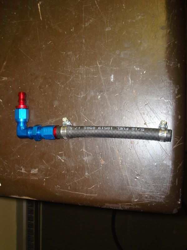

You need to use R10 intank submergable fuel line for the rubber line thats in tank. Here is what I did. Nevermind the new red and black wires. That was part of a re-wire to the fuel pump that I did. You can reuse your stock wires.

just go to A&A auto parts or anyplace that sells -An fittings and buy a bulk head fitting and the nut that goes with it. I used -6an since i already have that run for the whole fuel system. Just cut the remaining of broken hard line off flush(i used a dremel) and then get some good drill bits or i had a old porting bit i used to open the hole up bigger. make the hole big enough so the fitting just fits in and then put the nut on the bottom and tighten it up real good. Run some line to the pump and the to the front of the car and ur done
