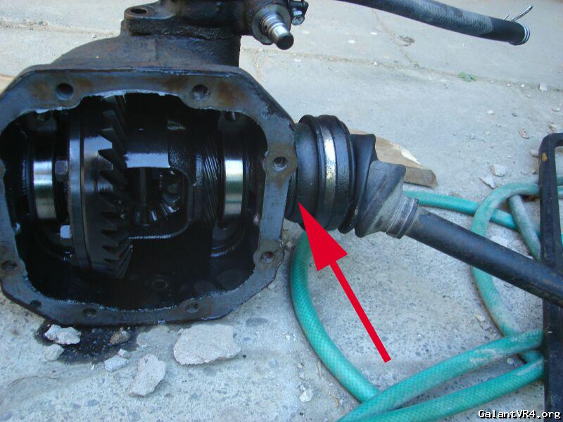

Is there a super secret method to remove the axles from the diff? (photo attached to clarify which bit I call an axle)
I've tried yelling at it, spitting on it, swearing at it.... nothing works! I remember it being really easy to remove last time - but that axle had exploded into several pieces that time /ubbthreads/images/graemlins/jawdrop.gif
Would something like a tie rod splitter help?

Place a large pry bar on the side of the diff housing and push against the axle joint area and use the diff for leverage. Apply pressure then smack the pry bar with your other hand. It will pop right out.

I find that using a wide flat screw driver or pry bar while twisting works well..
If you have room like you do, just lever it against the cup (green bit) and the housing.

Yeah, you can just see the end of the wrecking bar in the photo - It keeps slipping off the green axle 'cup', you know because it's round and not very co-operative. I can get a small screw driver into the gap between the oil seal/diff and the shaft but that's about it.
I thought these things had cir-clips on them but there's not room to possibly fit/remove one.
So it's a case of just force it? Bugger, I hope this works and gets easier because I've got 6 axles to pull out /ubbthreads/images/graemlins/jawdrop.gif

If you use the straight end of a hooked crowbar and angle it across the front of the housing in a way that prevents if from slipping sideways, and keeps it lined up straight (a block of wood as a fulcrum might help), and then just bop the bar on the hook (towards the axle cup, not just a prying motion) it will slip right out.
It doesn't actually take much force, you just have to apply it in the exact direction without letting the bar slip off the cup. Forcing it in the wrong direction will make the circlip jam up and prevent it from coming out no matter how hard you hit it. Wrapping something soft like a rag or sticky like duct tape around the end of the prybar might help.

Excellent, all done.
I found that wrapping some sandpaper (sanding side out) around the end of pry bar helped keep it in place. Using the lumps where the diff cover bolts enter the diff housing as the fulcrum I would pry out a bit and then turn the axle 180* and pry again, then pull out the axle by hand.
