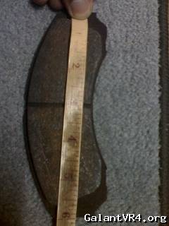

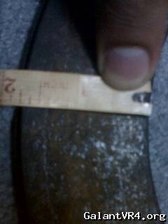

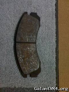

I went to the junkyard today to find some dual port disc brakes. I found a set but the guy was not sure which car are they from. Can any one identify from the pad which car would it be from? I took the pad from that guy because i did not have any camera there. Sorry for crappy pics. The disc was in 5 lugs not 4 lugs.

yes i was looking to buy new pads to replace those, dont have any part number, thats why i took the pics, i thought some one might recognize them from the pics. I searched on google and found out that they were used in wide variety of mitsubishi cars including evo I, legnum etc. I guess i would have to visit the local parts market and hope to find them. Thanks any ways!
Wizardawd
Aug 7, 2007
1,323
Franklin, NC
They look just like the regular 2-piston pads for the GVR4's, 93+ AWD dsms, Diamonte's, etc. Just goto a parts store and ask for pads for the GVR4. Match them up and you're set. Doesn't matter if it's 4 lug or 5, still use the same calipers (ie, same pads).

We did not have any vr4's or eclipses or any awd car for that matter from Mitsubishi, so if i go to any Mitsubishi dealer and ask them for vr4 pads they are like what the heck is a vr4 lol. I did found the brake pads, they are the same as jdm 7g galant pads, so my problem is over now /ubbthreads/images/graemlins/laugh.gif

Didn't bother to see the location....but yeah, a ton of larger mitsubishi vehicles used the 2-piston calipers. Glad you found what you needed.
